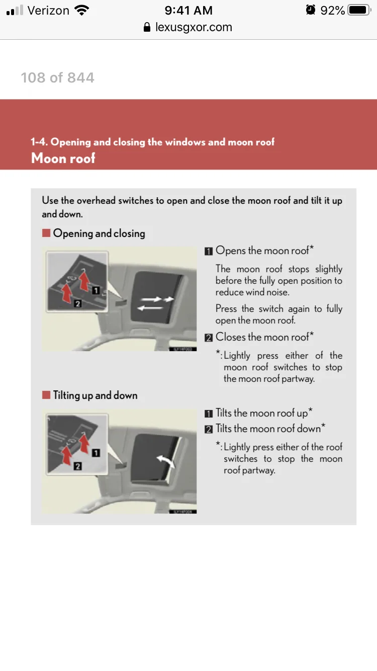

60% and then had to push the button again.
Is this normal for the moonroof?
Mine does this. Why doesn’t it open all the way? Baffles me. No other vehicle of mine with a sunroof did this.
  • Like
Reactions: r2m
Ah-haa! So I'm not the only one? I'm beginning to think this may be SOP. Makes me feel better.
Let's see who else chimes in.

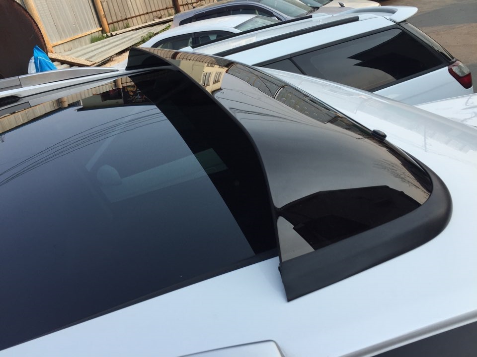

Also, why is it so windy with the sunshade open? I wish Toyota would of designed some sort of low profile fairing to compensate.
I'm actually glad it has some sound deadening effect. :-)
I have another vehicle where it doesn't seem to have any noticeable affect on the wind noise open or closed.
An option if you don't have a roof rack
My '97 Accord had a deflector like those and it made a huge difference in wind noise. It also made it a pain to clean between it and the moon roof. My '05 Forester had an integrated deflector that would pop up when opened. Not as much noise reduction, but a better overall implementation. It also had a partially open setting that I used most often. It was quieter than fully open.
And there ya go!
