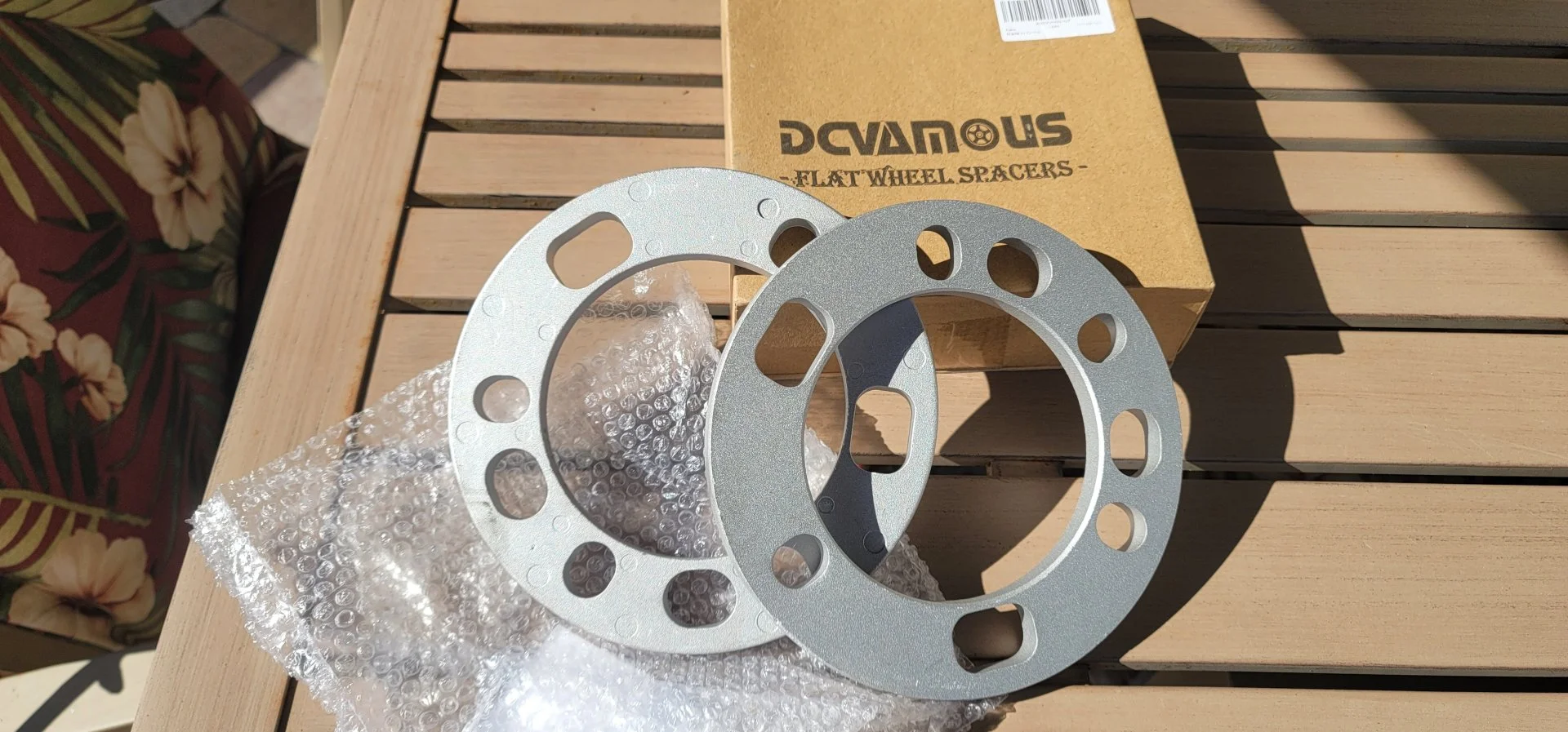

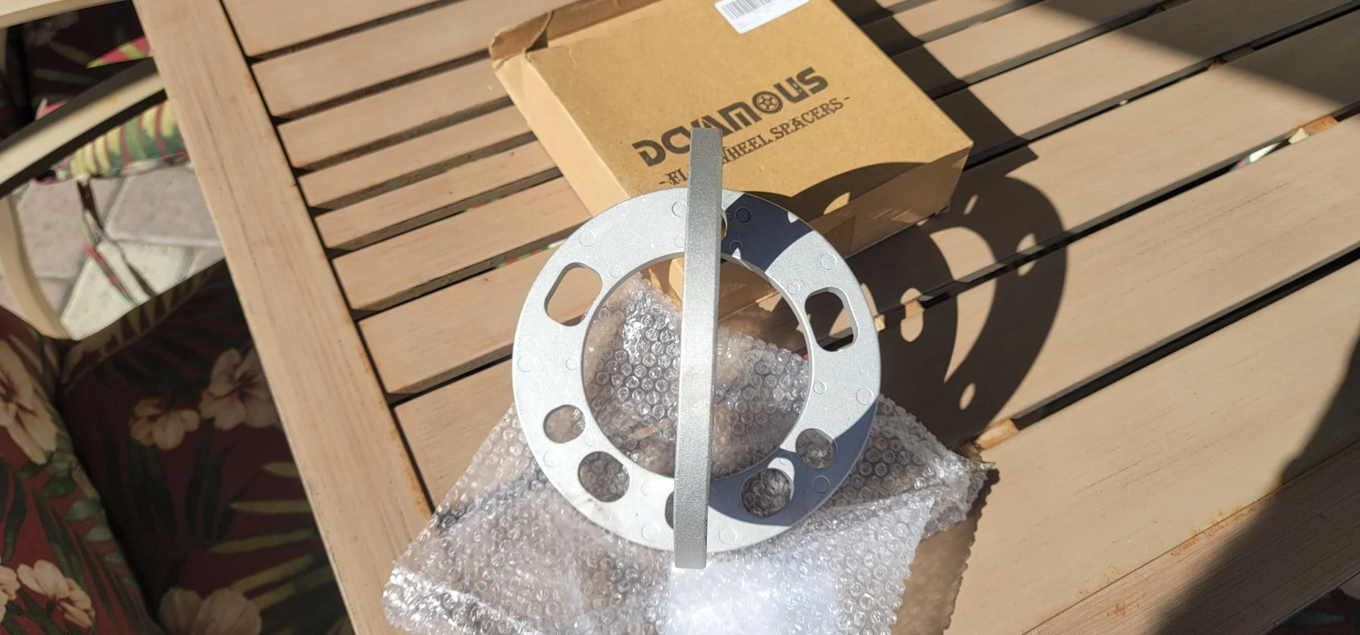

I bought these a little over a month (or 2) ago on Amazon, thus I can't return them.
They are 1/2" thick and my lug nuts aren't long enough to reach them. And YES they do fit our bolt pattern.
So my loss is your gain.
These are free to anyone who want's to come by and pick them up!

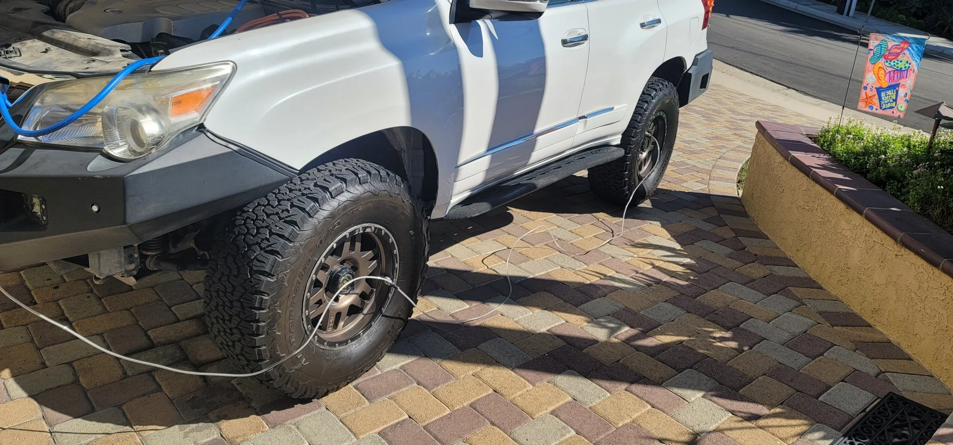

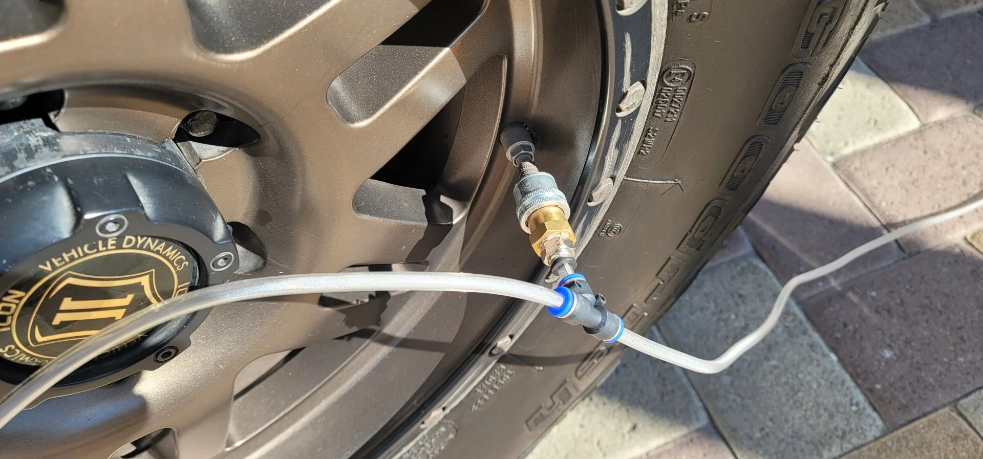

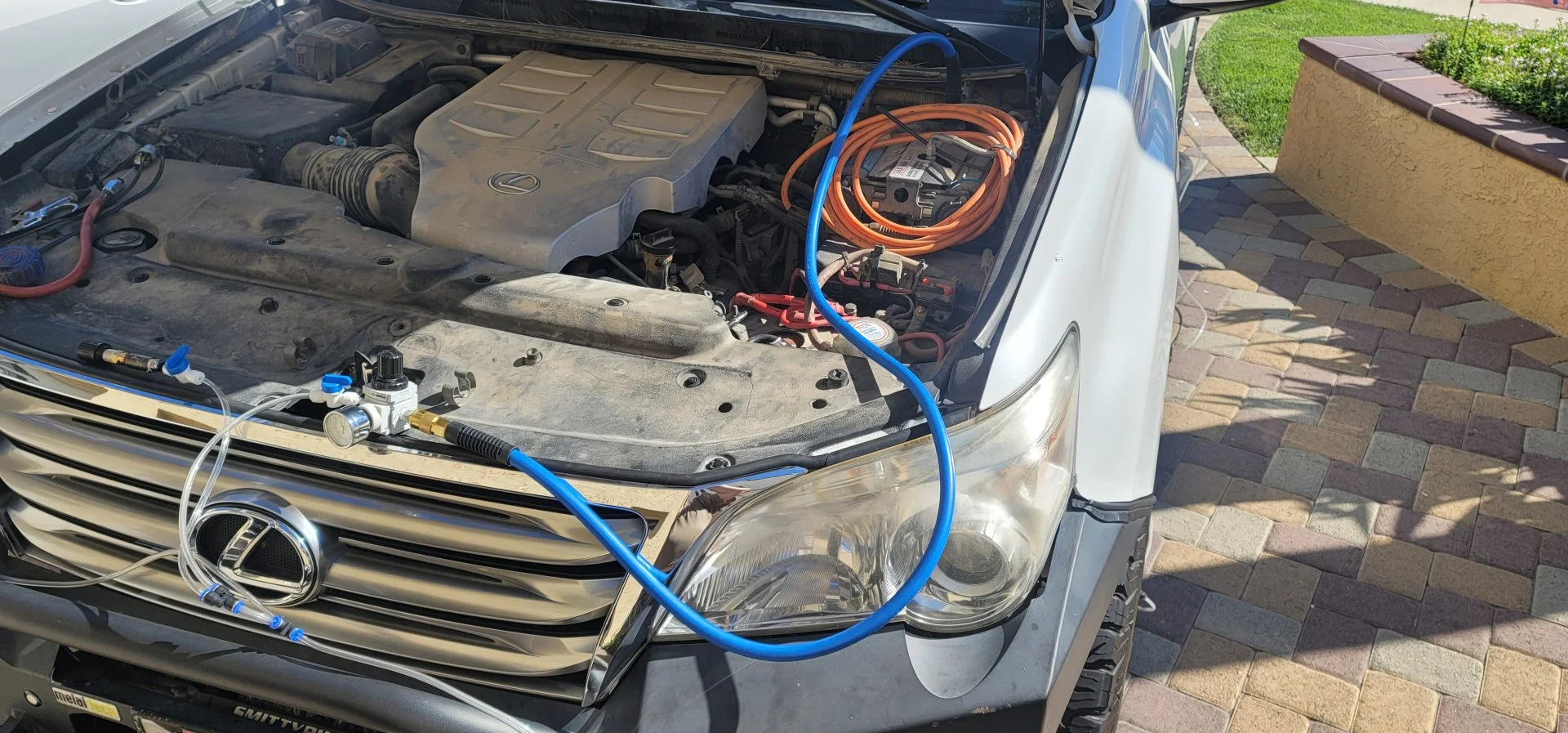

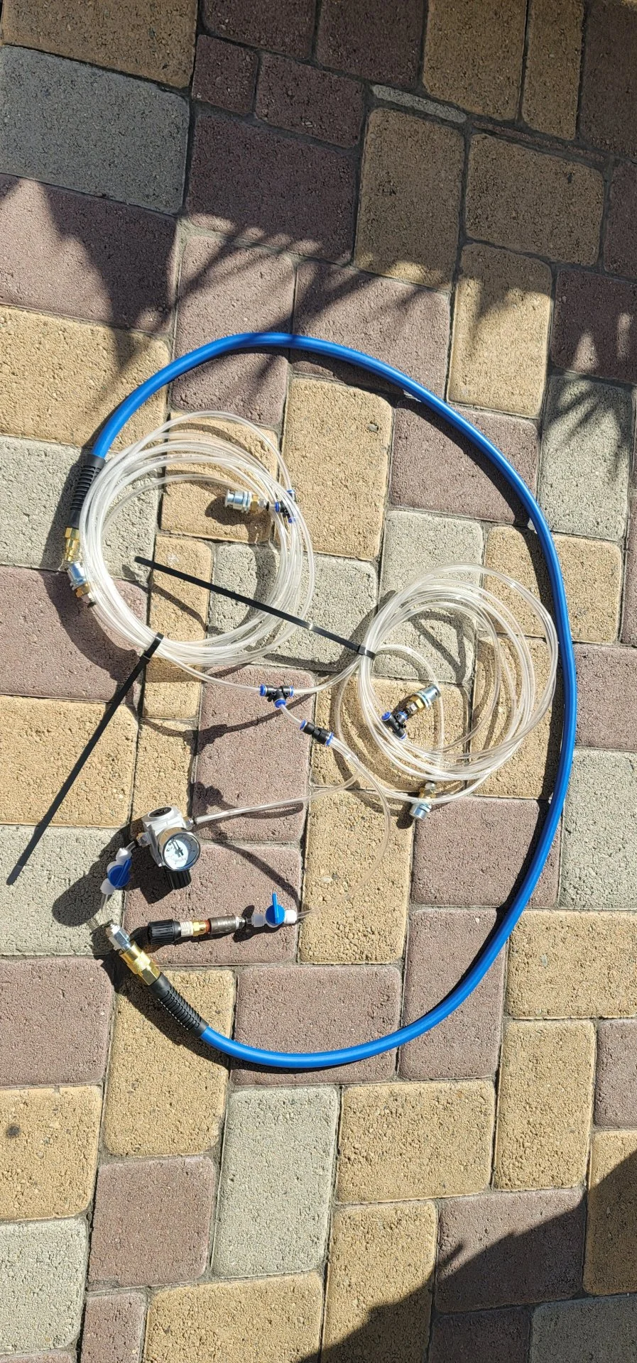

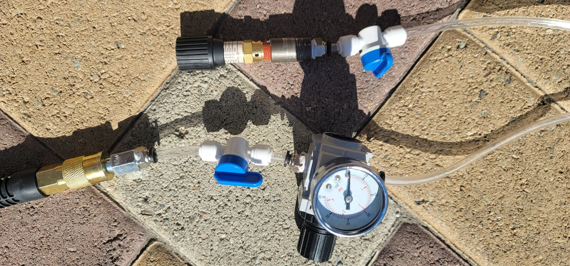

I've busy building a central inflation/deflation system for my rig so I don't have to sit at every wheel when airing down and back up again.
Here are the Amazon components I purchased:
Pressure regulator. Note this has a gauge that is 0 - 60 psi which is much better than the 150+ psi gauges. It'll give you a more accurate resolution of your actual pressure. After dialing in the pressure, just plug it into your compressor and wait for your compressor to quit running, which means it has hit the preset pressure for your tires.
Amazon product ASIN B01BO91D2OThis is just a lead-in hose. Compressor get very hot and if you were to run the air line I used, it would pop out of the press to fit connection.
Amazon product ASIN B07PH5ZYW3This is the pressure relief control valve. It works great and stopped my deflation at around 13 psi, but it's too restrictive and slow. When I removed it, airing down was much quicker. So if you're not in a rush and have time, this is great.
https://www.amazon.com/dp/B007GDY3CU?tag=ihco-20
By far the BEST valve chuck's I've EVER used!
https://www.amazon.com/dp/B01938M8MW?tag=ihco-20
The next two are press to fit connections for 1/4" air line. These are great! easy to use and modify you're air circuit. (industrial) quick connect air connections on your compressor, regulator and pressure relief valve.
https://www.amazon.com/dp/B077H2JWSZ?tag=ihco-20
https://www.amazon.com/dp/B07RSLDDBR?tag=ihco-20
You'll need to purchase these to connect to your regular:
https://www.amazon.com/dp/B07H8KDTRS?tag=ihco-20
This is the tubing I purchased:
https://www.amazon.com/dp/B0B2CX8PVG?tag=ihco-20
All-in-all, it's way cheaper then purchasing one of the pre-built that are out there, plus some don't have regulators and none have pressure relief valves.
This is a fun, cheap and easy little project that is VERY useful if you air down often on the trail.
Next post will be all the photos.
All coiled up with reusable zip (cable) ties.
Almost forgot to mention that it took about 10 minutes to air down from 35 psi to 13 psi, but part of the time was having the more restrictive pressure relief valve connected.
Inflation time saw a huge improvement! Less than 10 minutes from 13 psi to 40 psi on 315/70R17 (34.4" O.D.) It usually takes me over 3 minutes (probably closer to 4 minutes) per tire not counting having to jump around to each tire and sitting there to fill up. So this is a huge gain for me, especially if it brutally hot or cold out. I can just sit in my rig, I even have enough air line to run it into my drivers seat and monitor it all from the comfort of my seat!
Forgot to mention if you have any questions about how to make the circuit let me know. It's pretty easy, but it helps having the valves well placed.
