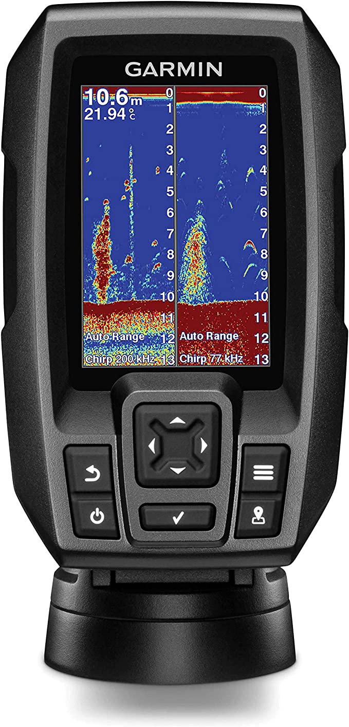

I'm not into deep water fording myself but a water detection sensor at some set level may be an option with a dash light
or get a cheap shallow water depth sounder working :)
Nice try Acrad!
Only problem with depth gauges is they usually mark in meters for feet, or perhaps 10ths of.
We would need it in inches/cm for it to be useful.
