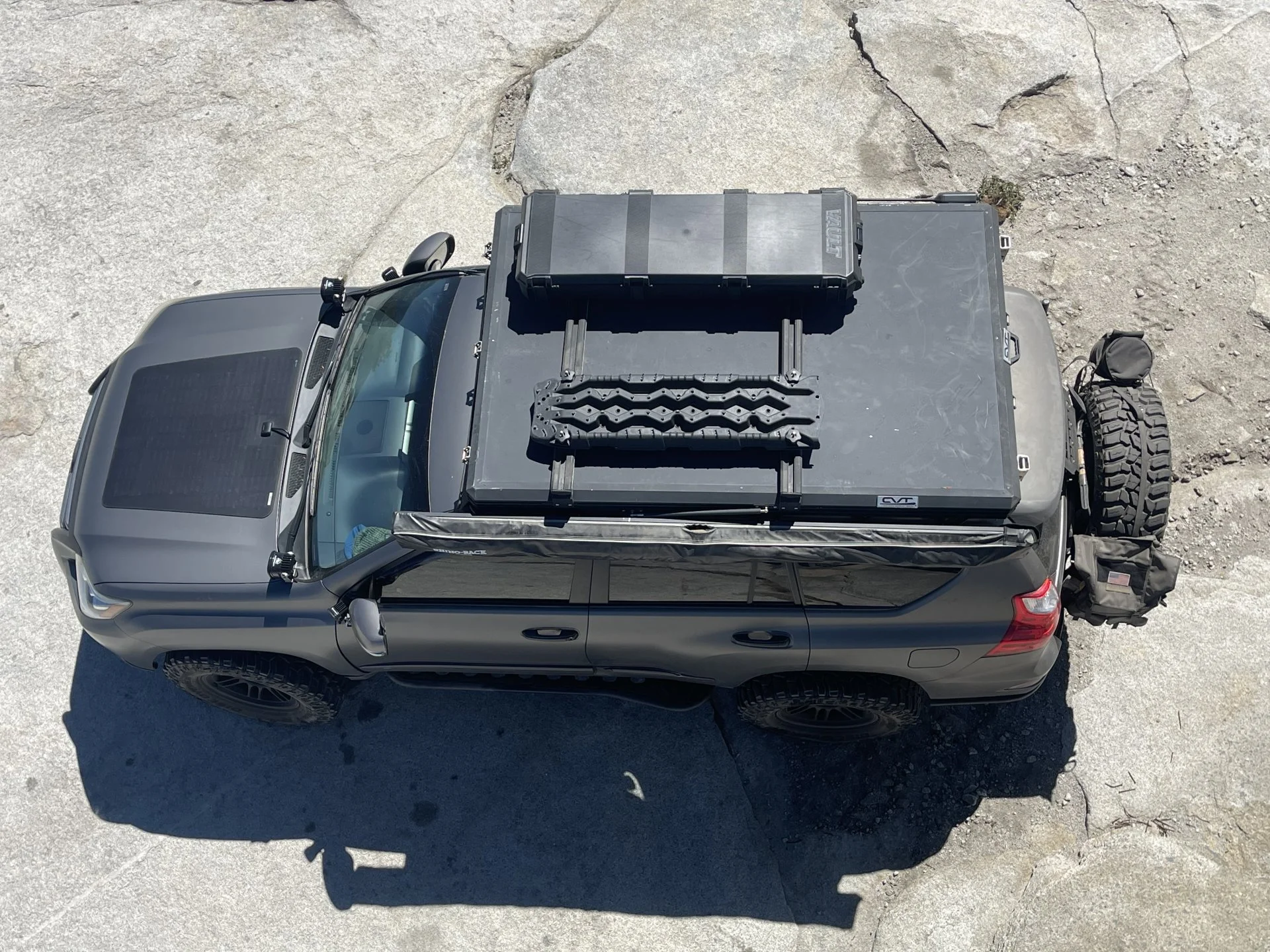

There is a hood mounted one for a lot cheaper that I may consider:

I have wanted a hood mounted solar panel for a while but after research I decided against it.
Heat is a solar panel's kryptonite! The hood (at least on my black gx) gets super hot to even touch and all that heat plus the heat that the panel generates from being a black cell is gona bake it all day long and decrease efficiency and life span. When driving its not too bad since there is air flow but it will be baking while parked under the sun. oh and lets add a little more heat from a running engine or when parked after a long drive all that heat soak.

I’ll chime in on the hood solar panel. Run away!
I get very poor performance from mine. Currently it is unplugged, until I add more panels. I was only getting 30watts out of the hood panel vs 65watts out of a 100w foldable panel placed on the hood.
I was given one with a hefty discount when these came out, but I wouldn’t recommend this at all.

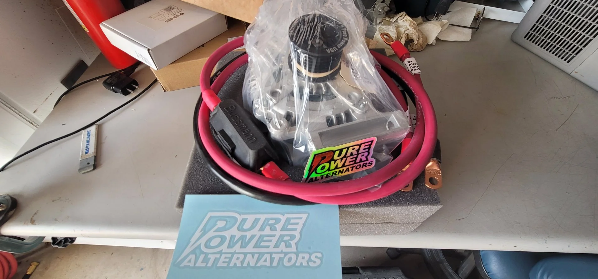

My new 240 amp alternator! Just need to make an appointment with my mechanic for install.
These are the guys I purchased from: 2013 Lexus GX460 4.6L 8 Cyl Alternator. Custom Built; 240 Amps | Tucson Alternator - https://www.tucsonalternator.com/PartDetails.aspx?OS1=HO&IDNum=131245
From what they say they build it upon order, so they're built here in the good 'ol U.S. of A.!
He looked up the suggested install time and said it's a 4 hour job in the books and requires removing the radiator!
These alternators must be really tucked in there! I know when I installed a high amp alternator in my old 100 series Landcruiser myself, I spent half a day and that was without removing the radiator! The issues were the new alternator was a little over sized and the wires were barely long enough, which caused me a bunch of grief and time trying to fit it in there. These guys said this is exactly the same size as stock, so should not cause my mechanic any problems. My mechanic also said that if he were to have replaced it with an OEM, the cost would have been closer to $500.00 just for the alternator! this was only $358.00, but I purchased the heavy duty cable as suggested, but in total it was still cheaper than OEM.
