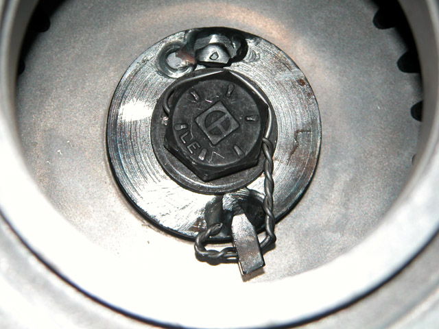

This is the result of not having a mechanical locking mechanism in place to retain that bolt:
This was a solution that I made for a 420/Orion that was in the shop a few years ago.
I drilled the head of a bolt, drilled a hole in the tapered washer that was used with the 420 and TIGed in an alignment stud to catch in the splines of the gear to prevent the washer from rotating, and then also TIGed a tab onto the tapered washer so that there was a place to secure the safety wire.
PinHead has a very informative write-up in the Technical Links section on the 420 install, which is very similar in many ways to the 465.
Concerning your gear alignment issue, this can easily be remedied by installing a transfer case main shaft thrust washer, 90201-35070 in front of the transfer case input gear. This will space the input gear rearward so as to engage on the counter gear fully.
