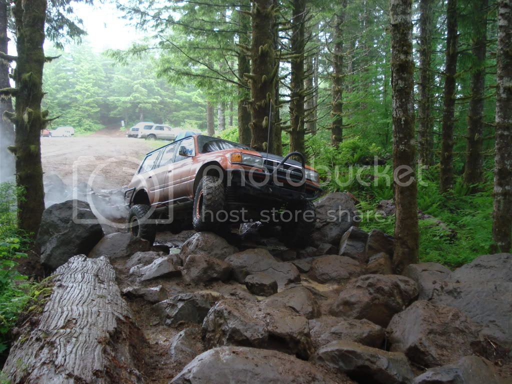

This is the formerly Metal Tech 80 series. It has ARB air lockers, but as mentioned, they cam with stock Electric lockers on some of them. Those are 37 inch tires, and this thing goes nearly anywhere you point it. Seriously look into the 80 Series Cruisers, I think you will like them!
