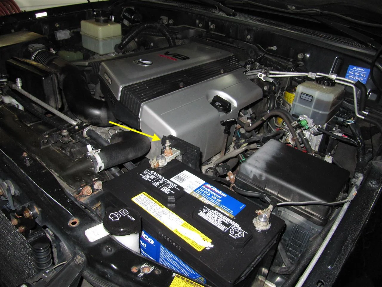

Check this fusible link box for brakes lights not turning on and not shifting into gear. And for your door locks and unlocks with brake, check if the owner before you install remote security alarm. Door lock and unlock wires are right next to the foot rest dead pedal.
I just checked that "fusible link box" and only have three fuses. It's missing the main 100 fuse. Is that how it's supposed to be? Also, a while back, that fusible link box connections was loose and my landcruiser would get no battery power at all. I would jiggle it and then it would start. I tightened it and it has never lost power since then.

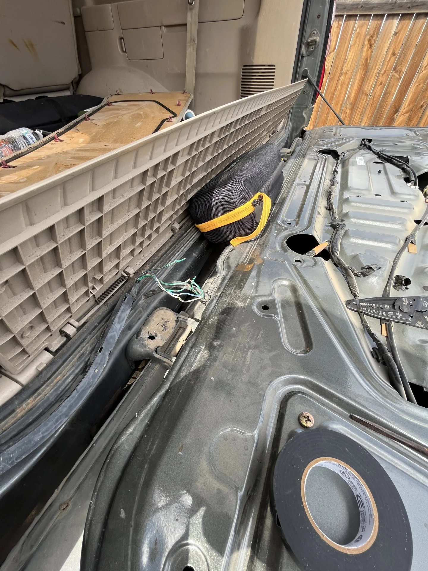

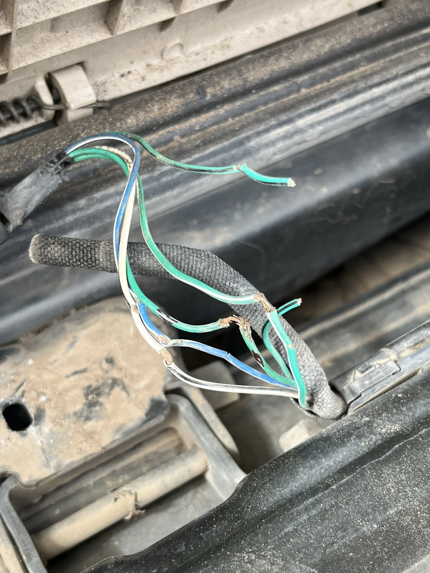

UPDATE: The problem is fixed. There was a short in my tailgate. The wires just came apart over the last 22 years and I connected them all back and now everything is working fine! I noticed, every time I opened the back door, the doors were continuously locking and unlocking. Lifted up the little panel back there and there it was.

@photojoe01 thanks for posting the solution. My tailgate wires were in the same condition. Not only did connecting the tailgate wires fix my short when pressing the brake causing my doors to lock, this also fixed my entire drivers side speakers from cracking and buzzing. I had moved the audio balance all the way to the passenger side years ago so I could listen to music and for some reason decided to move the balance back to the middle last week. I now have perfect sounding speakers!
