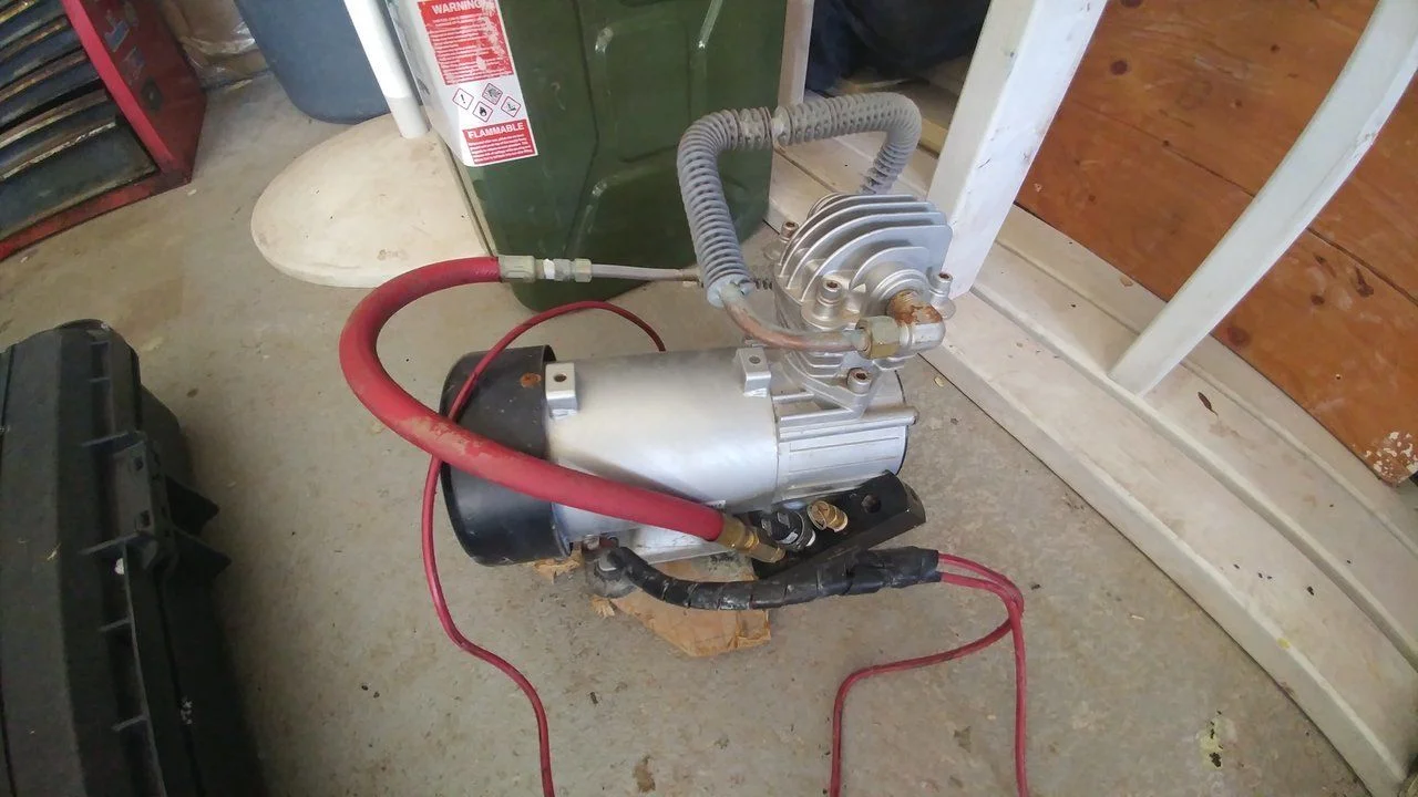

Yeah, mine seized up awhile ago. It's still apart on the bench, I'll get around to it one of these days....
Nothing I could see as to why it seized, it just "did".

12v, mounted inside the back of my 80. had it for a few years, not a lot of hours on it though, probably not even 10. Never seemed to be any water in the tank whenever I checked. Was working fine, went to use it one day and the power leads were smoking hot and it wouldn't do anything.
Do you advance the throttle on your rig so it's putting out the required voltage? At idle, most rigs don't put out what the compressor needs and that'll fry it if done enough times. I'm seem to remember 14.7 volts at a minimum. I have an ice scraper that is just the right length to hold the throttle at about 1500 rpm. If you check with a voltmeter you can see the difference between idle and approx 1500 rpm. Edit: Also measure voltage at the compressor, not the battery. You could be suffering from a serious voltage drop if your power cables aren't able to handle the load. 12v is what the Puma needs and that is what you should see, minimum, at the compressor.
