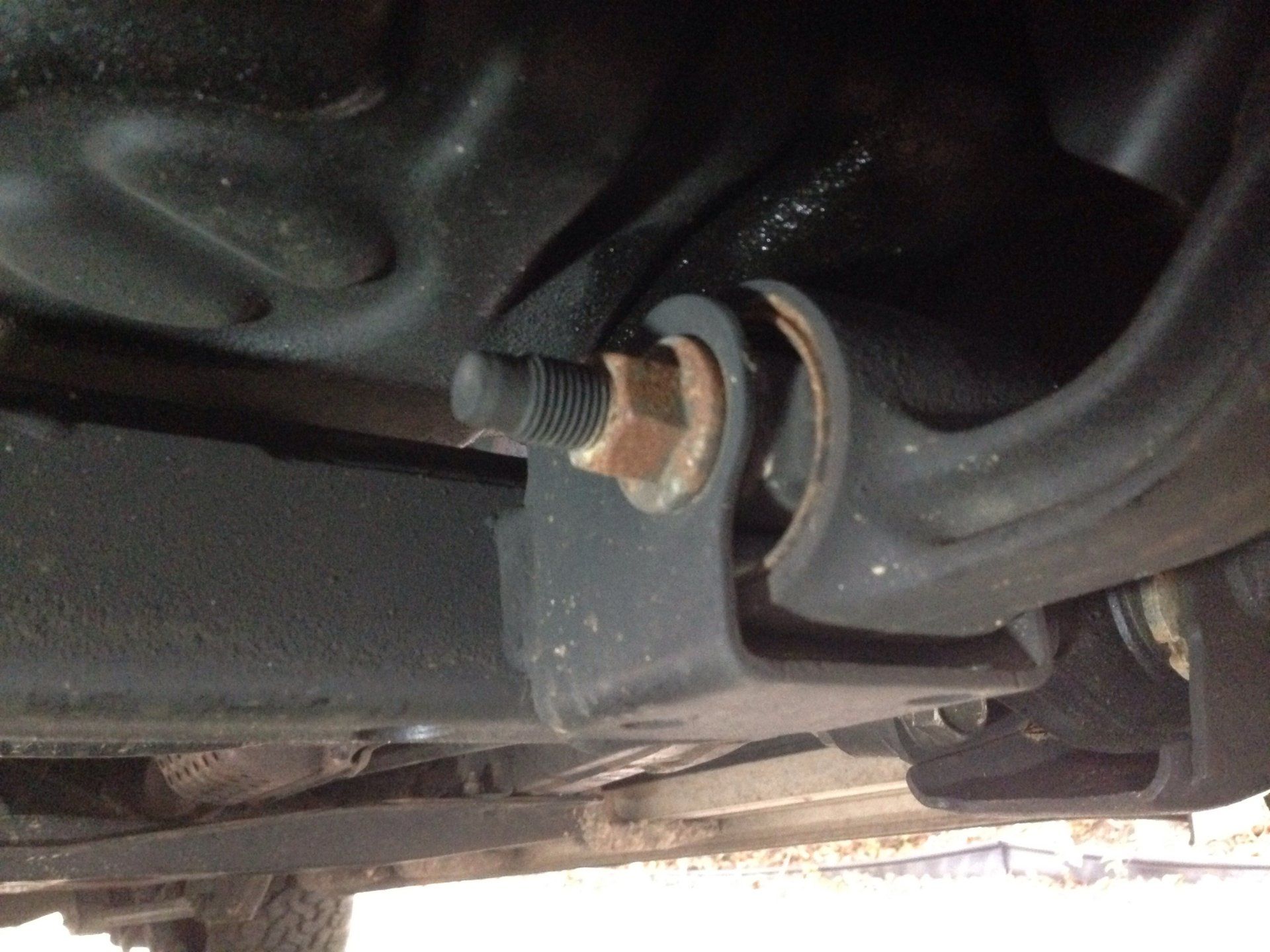

Anybody tried fixing driveline vibes by replacing the front differential control arm that attaches to the cross member?
The bushing inside mine looks worn so that the diff sits at a different angle than it would be with a new bushing. Maybe they all sit like this new? Thinking of replacing to see if it helps cure my driveline vibration that starts at 60-65 under low loads and disappears under hard acceleration.
