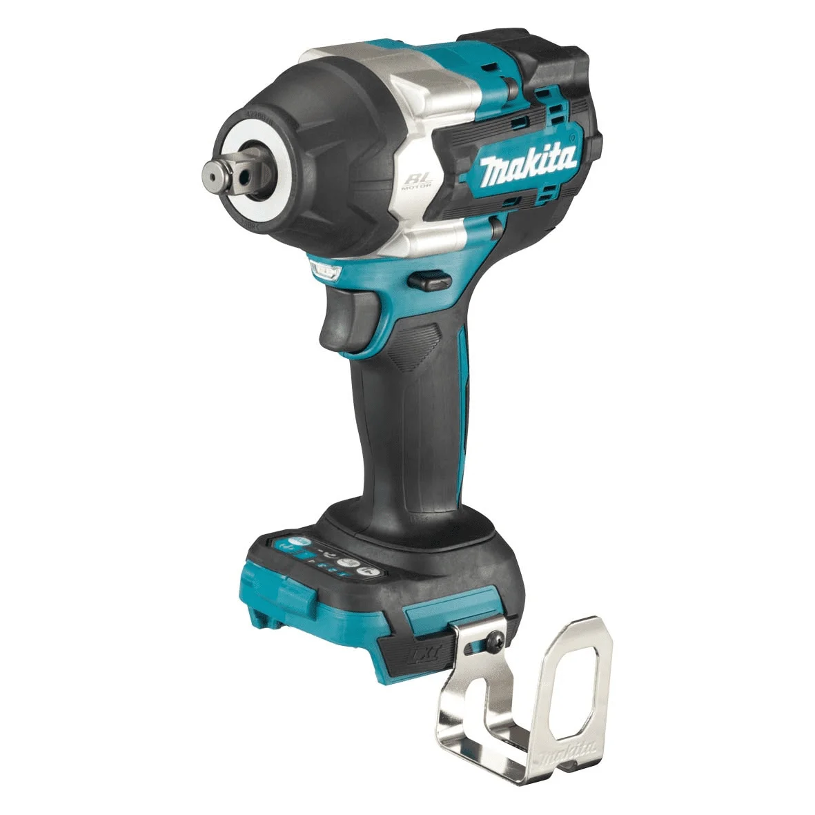

Our 80s are all ancient now. We have a lot of bolts that are frozen in place. What you need in your arsenal is a little tool I never properly appreciated until I got one last year. You need an impact wrench. I bought this gizmo last year, and it changed my life:
It's the DTW700Z in Australia. Equivalent seems to be the XWT17Z in the US. This baby delivers 1000nm (740 ft-lb) of nut-busting torque, and watching it work is magical. What made me go out and buy this last year was that one bolt I couldn't remove. I worked on that thing for hours. I was there with my breaker bar that comes up to my waist. I soaked that thing in penetrating oil. I hit it with alternating heating and cooling. I was banging on the bracket and the bolt, trying everything I could think of. It was on, it wasn't going anywhere. I've been here before, and I could have kept on going until it eventually gave in, but I got fed up, dropped some cash on this thing, and it removed it in one second. One. Frigging. Second.
This thing quickly became my favourite toy. I started removing random tricky looking bolts just to see if I could (don't do that, re-torquing them is a pain). I now look forward to each stuck on bolt with a kind of glee, just to watch this thing work. Best of all, it does it without hurting my hands, and more importantly, damaging the car. I've come to appreciate that the impact wrench is actually a much gentler way to remove a stuck bolt than me going at it with a breaker bar.

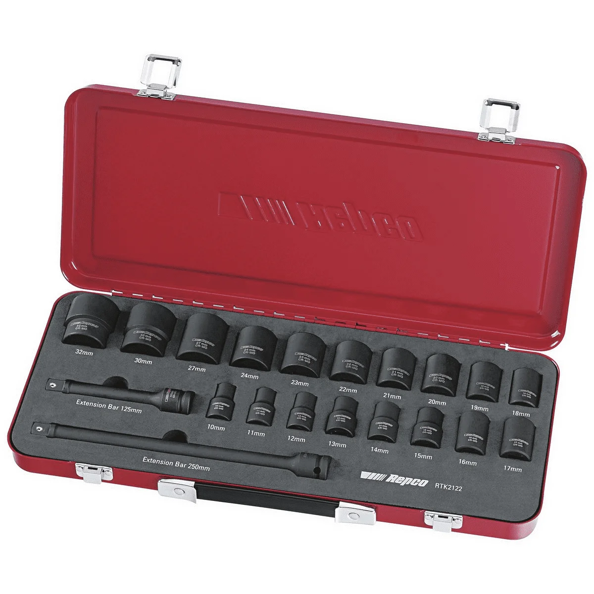

You also need to get a decent impact socket set. Your typical chrome vanadium sockets for hand tools aren't up to the task, you need something made out of chrome molybdenum, like this set I got:
It cost me around $800 all up to get setup with the impact wrench, battery system, and impact socket set. No idea what the price will be in the US, but it'll cost a little I'm sure. Well worth the money though.
Couldn't agree more. I have the Milwaukee equivalent and boy will that thing do some work. I used it to remove crank pulley nut, drawtite hitch bolts, shock bolts, you name it. I have found that on most of the ones that get stuck on the 80, they will come off pretty easily and not snap if you just give it a few ugga-duggas at a time. Going full ugga-dugga I think you're probably gonna bust something in my opinion buy yeah, I'm right there with ya.
And that's actually just the 'fastening' torque. What we are most interested in....is the removal torque which is 1180 ft. lbs.
So....still a good idea to soak with penetrating oil and select the slowest speed/setting (if equipped) when removing stubborn bolts.
With 1,000+ ft. lbs. of torque you're either going to break it 'loose' or break it 'off' (any of the smaller bolts).
LOL yeah, one way or another it's coming off.

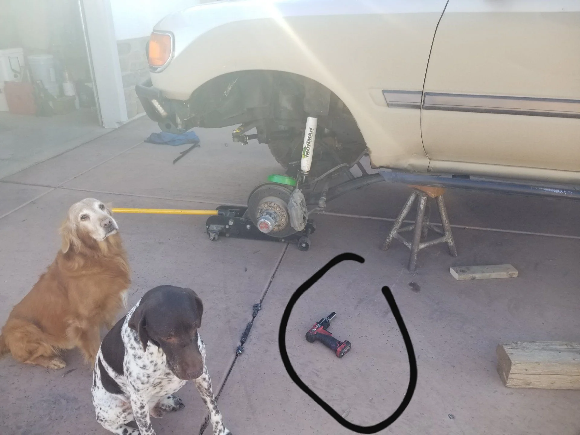

I have several Milwaukee tools, love them all. In december went to pick up their 18v 1/2" impact wrench....and ended up buying a Ryobi 1/2" impact with a big 4 amp battery for $99. Figured if it sucked, would return or just add it to the trail bag. Well, dang....it has done everything I've asked it too, even spun off the lower control arm nuts and or bolts (some with a wobble head extension on it). Best $99 tool I've ever bought.
I use the Milwaukee 1/4" impact driver with a socket adapter for spinning off almost everything up to a 17mm, that tool is epic too. ( also have buil several decks, and a dock with it + torx wood screws / lag heads. Does amazing with a spade wood bit, wish there was a hole saw that worked in it).
... ended up buying a Ryobi 1/2" impact with a big 4 amp battery for $99. Figured if it sucked, would return or just add it to the trail bag. Well, dang....it has done everything I've asked it too, even spun off the lower control arm nuts and or bolts (some with a wobble head extension on it). Best $99 tool I've ever bought.
That's the exact impact I use too, for the very same jobs. lol Also worked great for the high-pressure ps hose to pump banjo. I don't think it's nearly as torquie as the others mentioned here, but it hasn't come up short anywhere yet. (lucky I guess)
Plus everything else I have is Ryobi so...

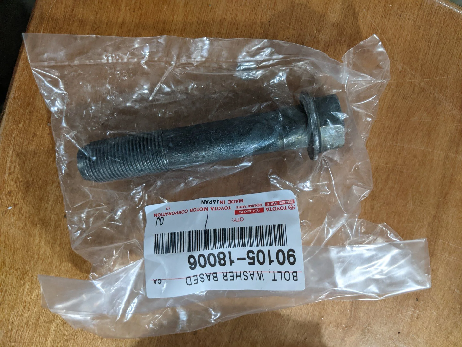

Just remember when undoing the control arm bolts you need to undo the BOLT, and NOT the NUT. Read the manual before starting that job...
those impact wrenches will easily get the nut off and ruin the locking part at the same time.
remember, when you have a hammer everything starts to look like a nail. Don’t use these sort of tools as your “first option” without reading the manual and knowing what your doing. Same goes if you happen to stumble on a reverse thread bolt...
Edit, and for those who don’t have the budget, have a look for the 12v impact wrench similar to this one...
While not as good a proper tool, for $59 these are really impressive. They basically have a motor that spins up to a preset rpm then “engages” in a fast knocking/hammer approach. You are less likely to break a bolt with this tool than with an impact driver but still much gentler than getting bolts out via a breaker bar.
I just did mine and loosened the nut, not the bolt. The bolt has ridges that bite into the frame surface so if you tried to loosen the bolt it would be extremely difficult.
That’s correct, that needs the nut loosened, but there are some of those bolts where it’s reversed.... (the bolt needs to be undone and the nut not moving).
Play nice children, your both right. The fronts are one way and the rear arm to frame bolt is opposite of the two front bolts.
IIRC, I don't think the FSM actually tells you which is what on this...however you can also tell by looking at where the washers are vs where the flanged bits are which has the barbie point bits. Point is I was shocked the ryobi worked to back these off. Retorquing them was right at the limit of what I could do with the limited leverage....I was sore the next day! (but that's way off topic!)
