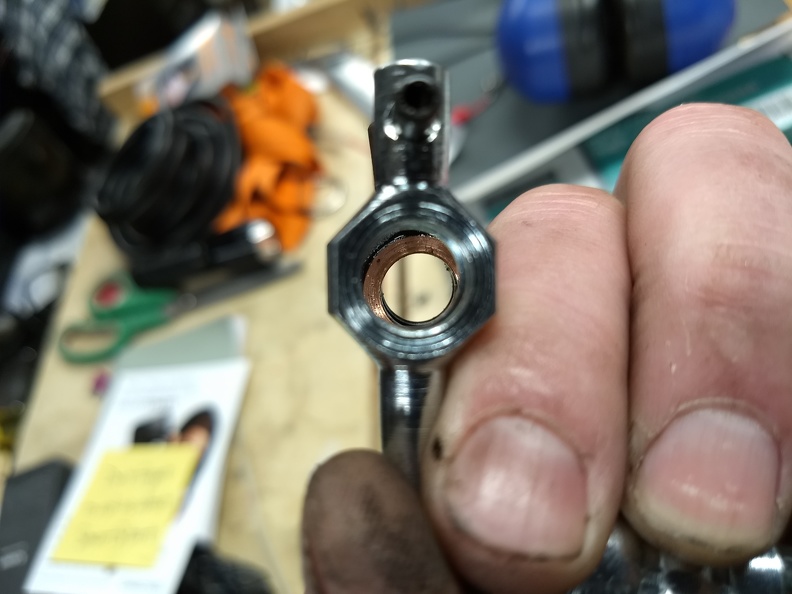

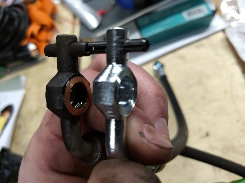

Just a heads up that NAPA brake lines don't fit properly, at least the ones they sell as "front, outer" brake lines. The roll pin used as a locating pin is too close to the banjo bolt opening.
I was able to use them by knocking the roll pin out entirely, then holding them in place with pliers when tightening the banjo bolts. I'll be ordering OEM lines to replace these (I used OEM everywhere else, long story...).

Raybestos have the same issue. I just completed a complete brake redo front to rear and found the same problem on the front lines. Rears, center rear, inner fronts, and center front all fit correctly. Used OEM for the outer fronts. Beulah sat on the lift for a week and half waiting on the OEM's to come in.
