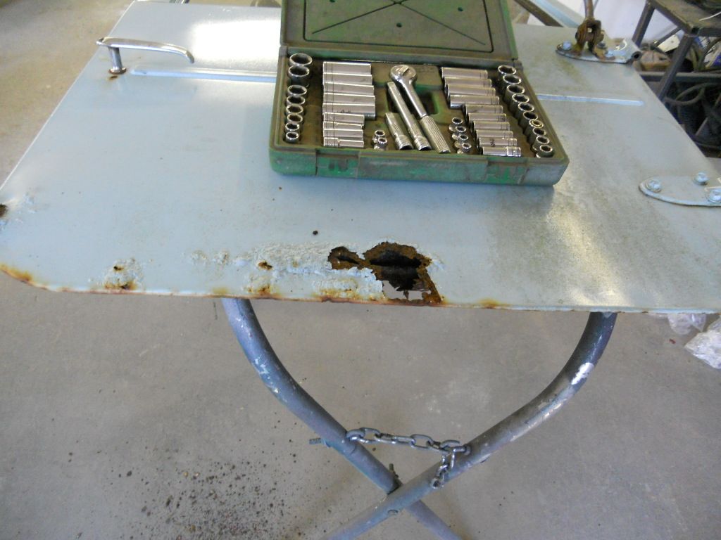

Well, I got to the shop today to do a little work. I was supposed to pick up a frame that mudmember Josephpatrickgray was giving away but the wifey had the Tacoma a little longer than expected. Sorry Joe:frown:.

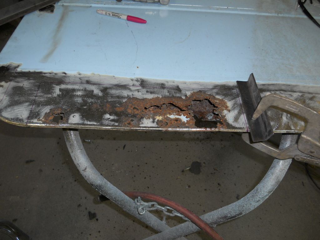

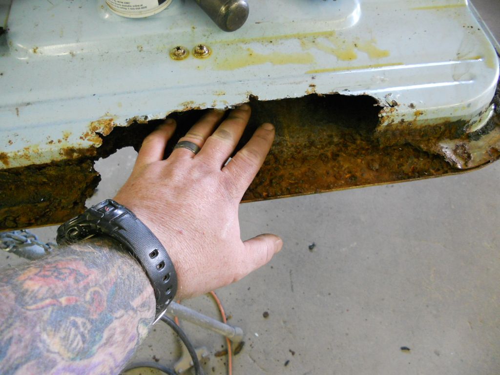

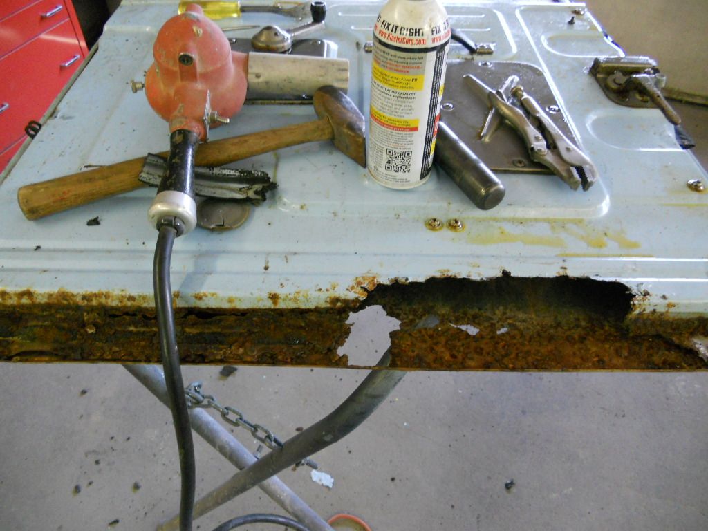

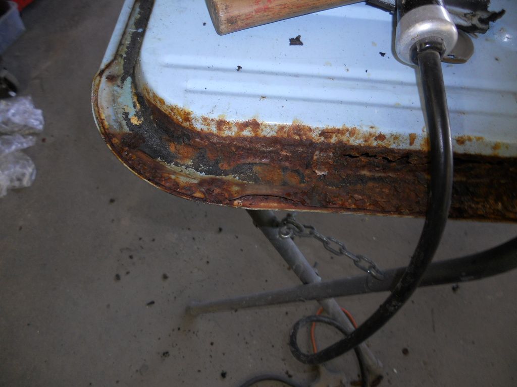

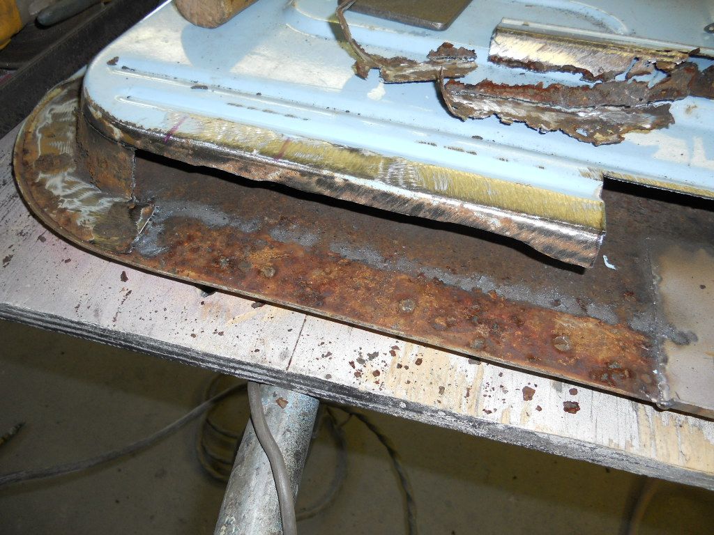

I took the door apart to see what I had to work with. It's actually not as bad as I expected, but the inner portion of the lower frame will be a challenge. Alot of radii to get it looking semi original. Anyone have a set of clean doors that were clobbered on the top they are looking to sell??:cheers:

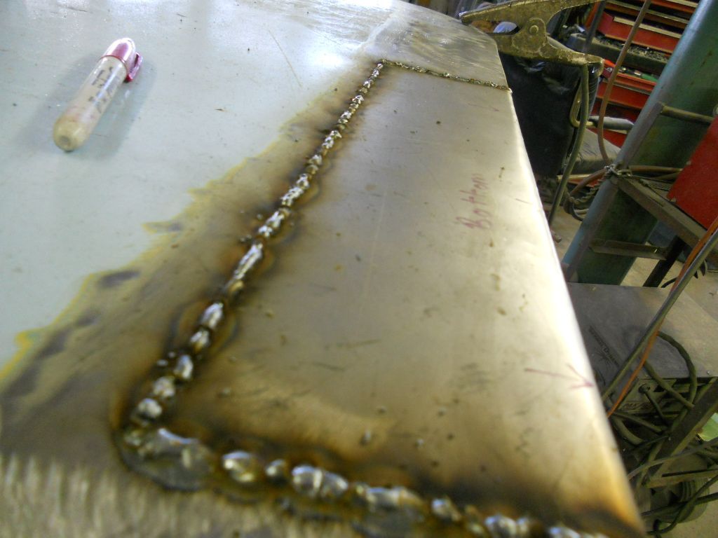

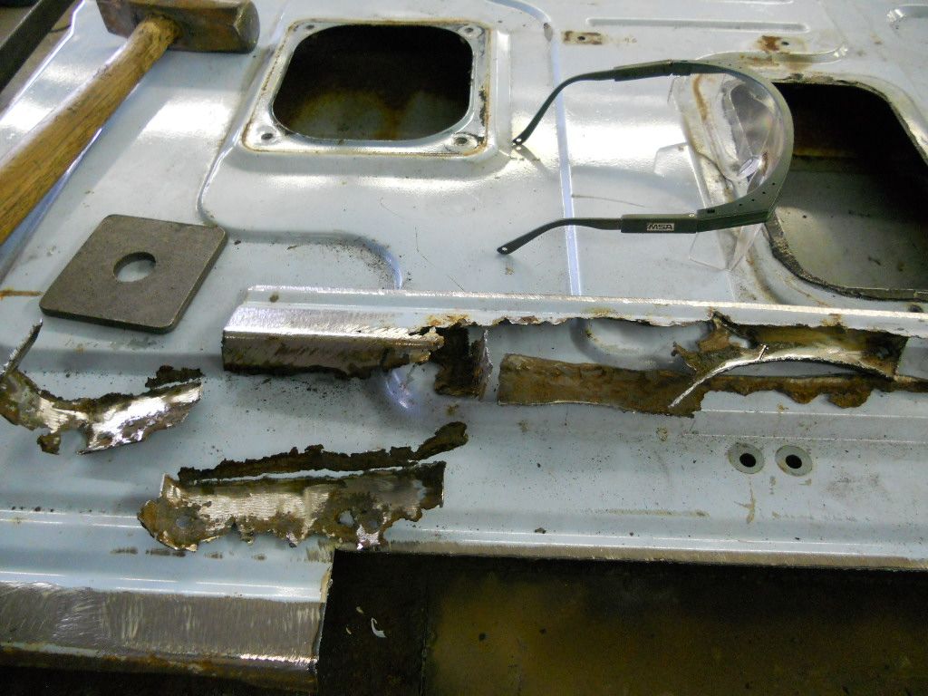

Here's the start to a LONG day of cutting, welding and grinding.
...and here's a vid.

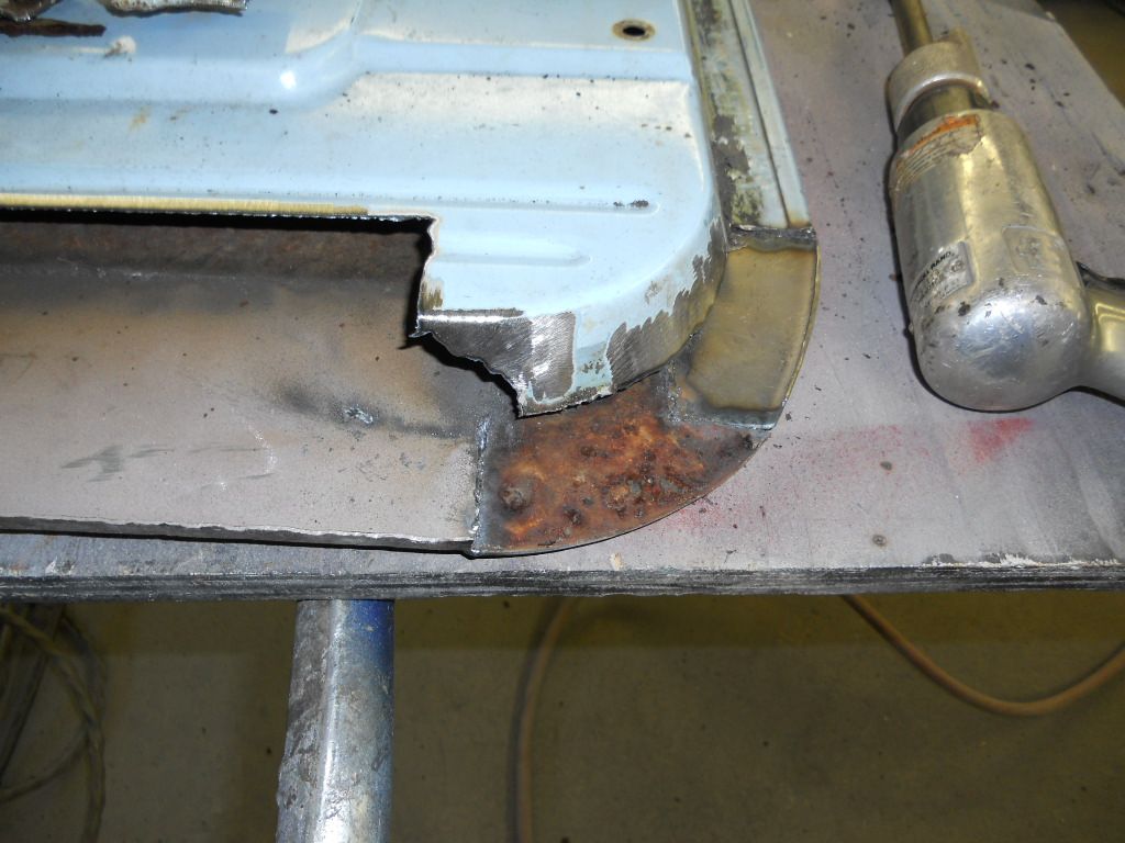

A few more pics and another vid.

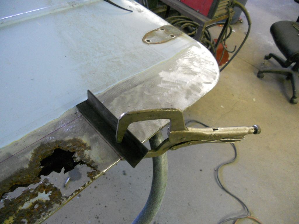

Look at that rot cavern:eek:!!

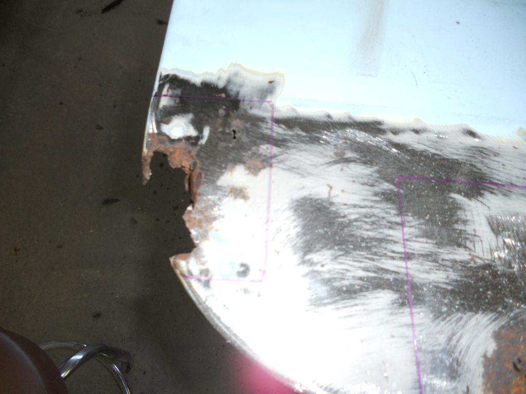

Getting ready to lop off the rot :bounce:. The piece of angle iron works as a guide while cutting with the palsma cutter.

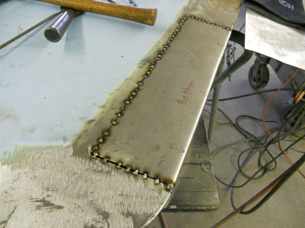

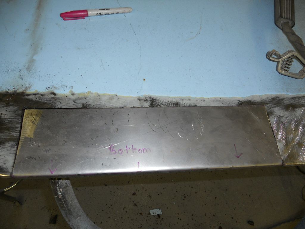

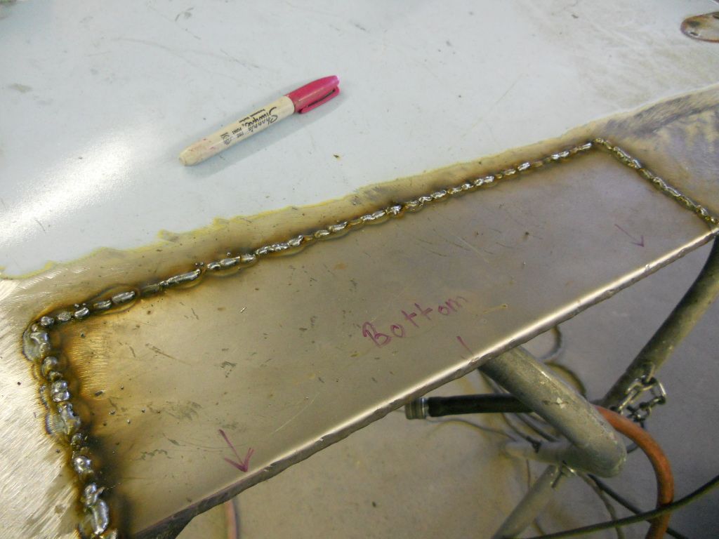

The patch panel looks pretty good for my standars. I need to get my hands on a decent press brake.

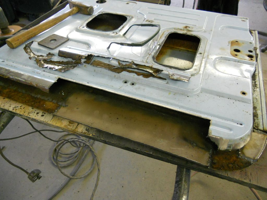

Here's the final group for the night. Like I stated earlier, I'm a bit confused on how I should approach the inner section with no english wheel or metal shaper at my disposal. I have no problem using a hammer and dolly, but that's only gonna get you so far.
Could you use a method similar to that I used on the rear door on my '70 restoration? It is on post 102 if you clink the link in my sig.
Awesome!! I read your thread, but totally forgot about the rear doors you reapaired. Thanks for the tip:cheers:!! I wonder if the rear doors would work as a patch? I have a decent set which are dented to hell on the top. I kept them in case I found a set of doors for cheap which needed the lower sections repaired. Again, I really appreciate your advice. You have some skills.

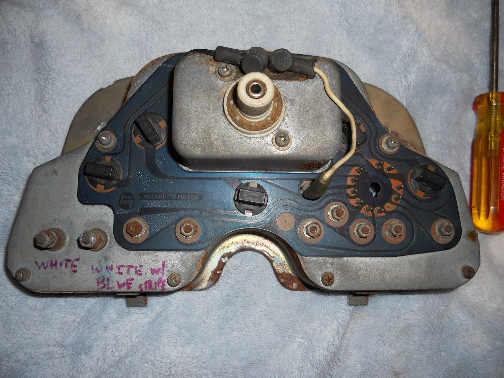

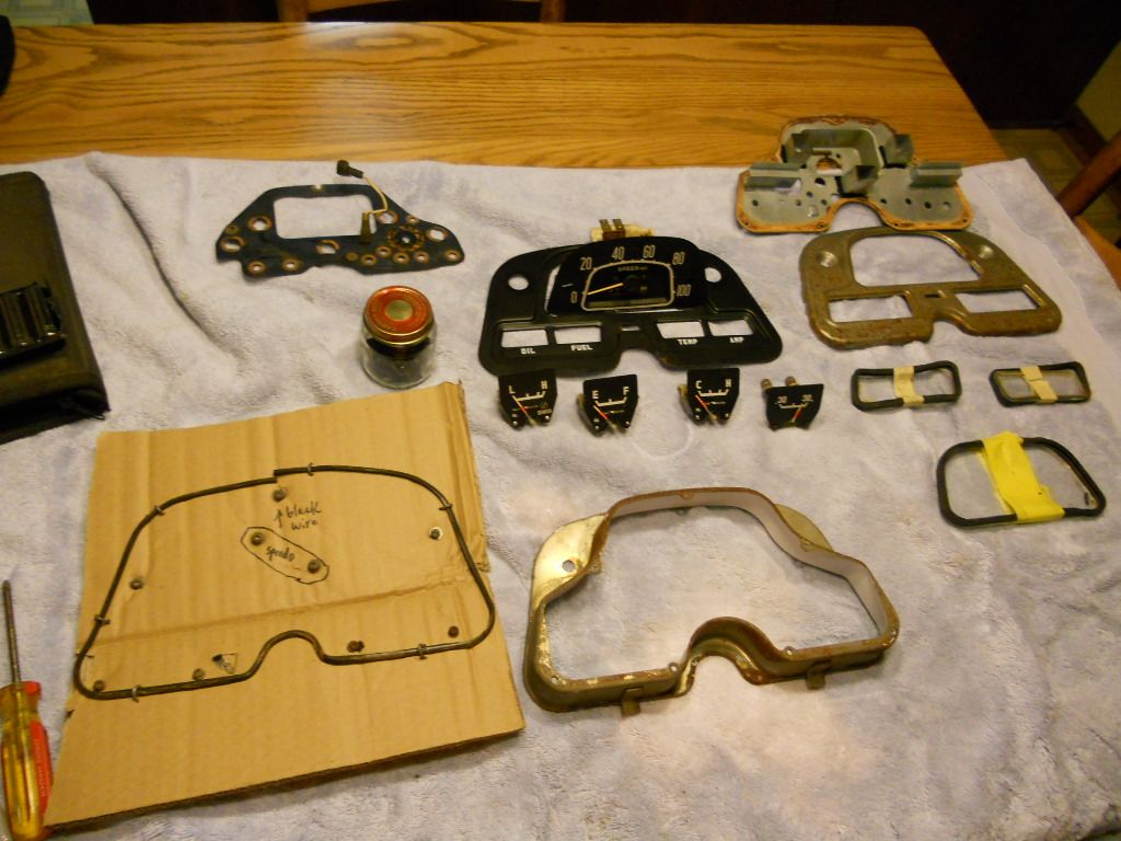

I managed to squeeze out a few hours at the shop today. Nothing too exciting since I'm still knee deep in metal work on the passanger door. The front portion are welded in and I got to cut out most of the rot on the inside of the door. Also got the driver's door removed and took out the gauge cluster. I'll work on that at home during the week. Thanks God the weather is starting to break which means I can work in the garage at night without getting frost bite.:doh:
And the vid.

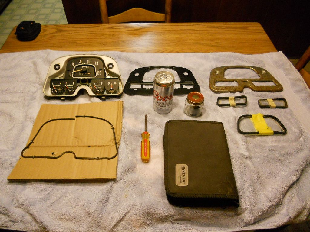

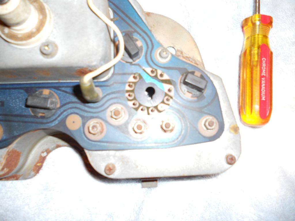

Here's a few more and a quick vid of the gauge cluster torn down. I'm gonna have my father-in-law media blast the housing and faceplate using his brother-in-laws industrial blast cabinet. I still gotta take the gauges out. I was running late at the shop.
And the final vid for the night.
