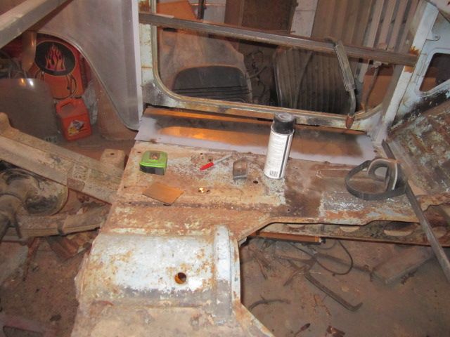

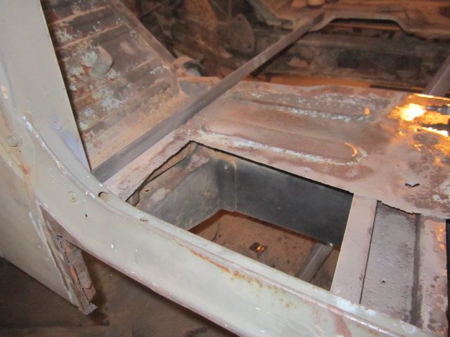

Anyway, I got the rocker all lined up as well as the inner floor pan. It was getting late so I couldn't tack the rocker in because I still have to drill the holes on the floor pan bend to weld it, but I'll get to it next weekend. I will put the supports in when I put it on the spit :grinpimp:.

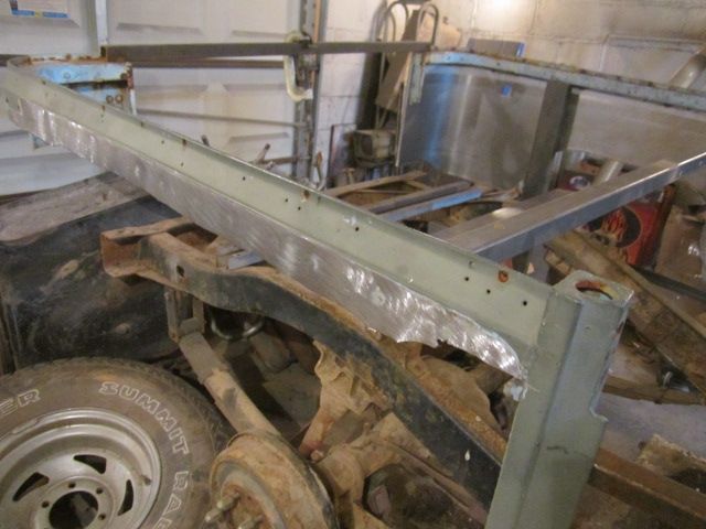

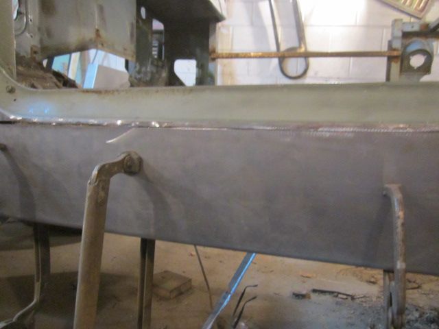

Here's the rocker all lined up. Have a couple "larger than I'd like" gaps, but I can fill them in by taking my time. I will put the triangular supports on when I get it on the rotisserie.
Gaps (or lack of :D) look pretty good here.

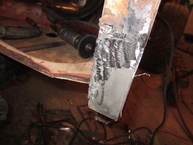

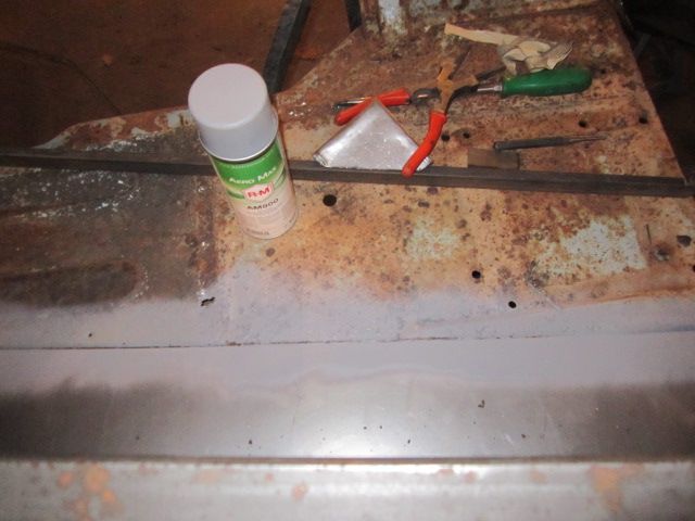

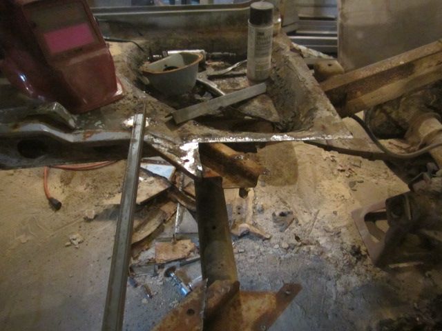

I used a can of RM spot primer to get the line I needed. I then removed the pieces and fired up the plasma cutter.

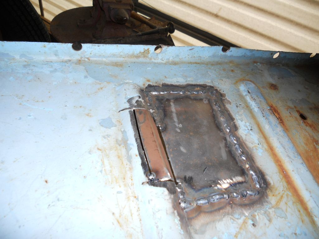

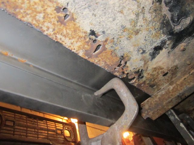

Here's a few more. I used my blaster to clean up the channel on clean up the pan where I'd be welding up the replacement piece. I'm up in the air on whatI want to do about the trans hump. I think I'm going to keep it. I only see one section with rot, but the blaster may uncover some unwanted surprises.:bang: I had one spot blow through on the channel. You can see it in the pic. A couple hits with the MIG welder and it was back to normal again.
It's almost ready to weld on:clap:.
Another damn gap:doh:!! Thank God I have a fresh tank of shielding gas along with .025 welding wire.

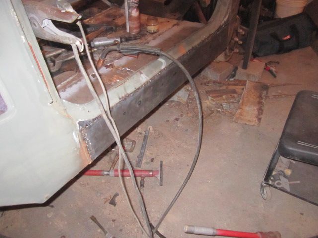

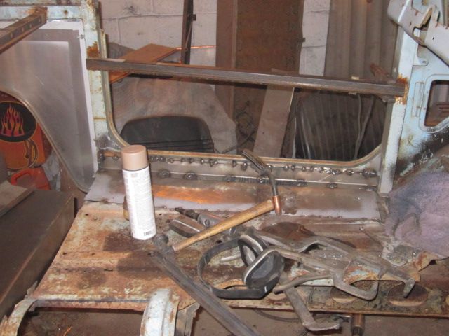

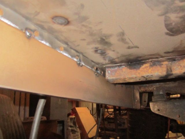

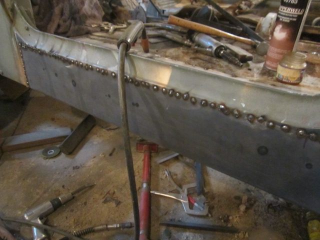

I got all the metal tacked in today. It took a little longer than I thought and I'm still not happy with the floor pan section. It sunk a tad when I welded the replacement pan to the channel. Pair that with the original pan's pleat and the inner rocker section proved to be a bi@#h to line up with the section of floor. I finally wound up cutting tiny slivers in the bent portion to get it to line up with the pan. I'll have to go back and weld them up.
I see alot of griniding in my near future:bang:. I also started cutting the PTO section out since I'm not going to use one. I would have liked to keep it, but after further inspection I realized it was too far gone (aka: rotted).

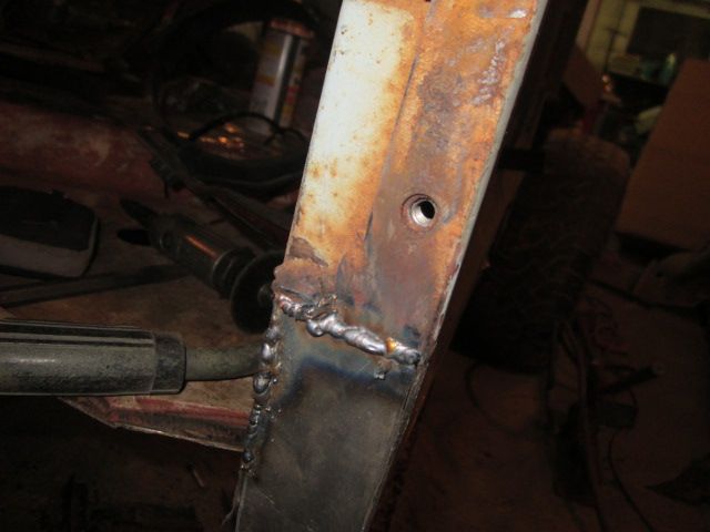

The welds were on the ugly side on the inner rocker section since I was all twisted up trying to get into a half decent position.

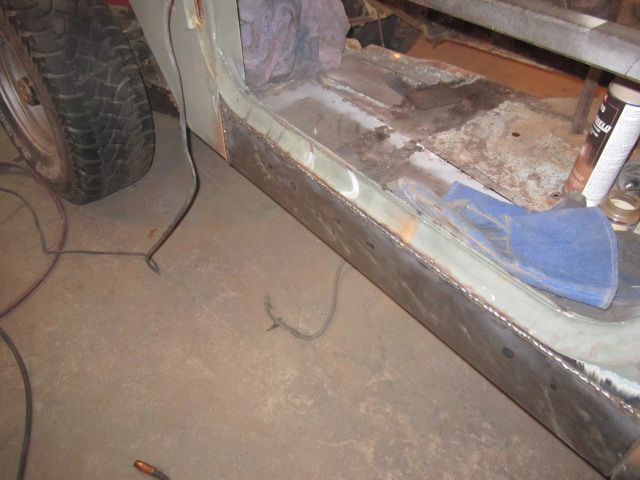

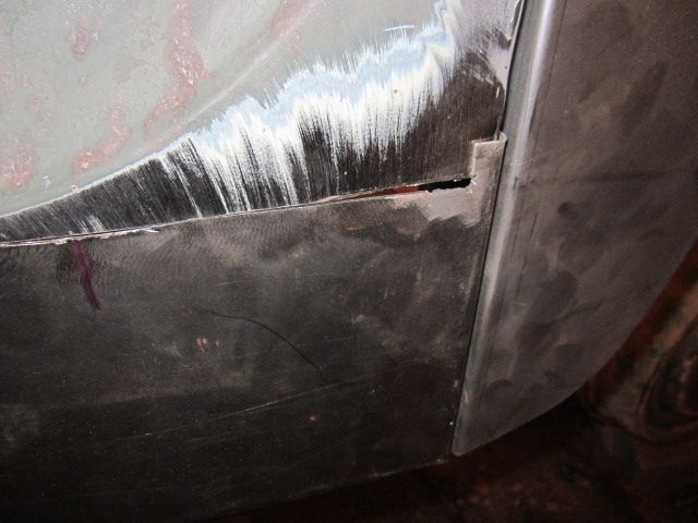

My rocker/1/4 line is pretty good:clap:!!
I just tacked the inside of the rocker to the floor pan bend. My plan is to fully weld it on when I get it on the rotisserie.
I will obviously fully weld it on before grinidingit clean. My shiedling gas bottle was getting low. It's almost time for a refill.

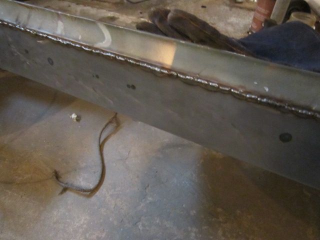

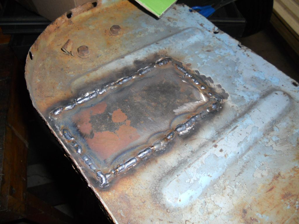

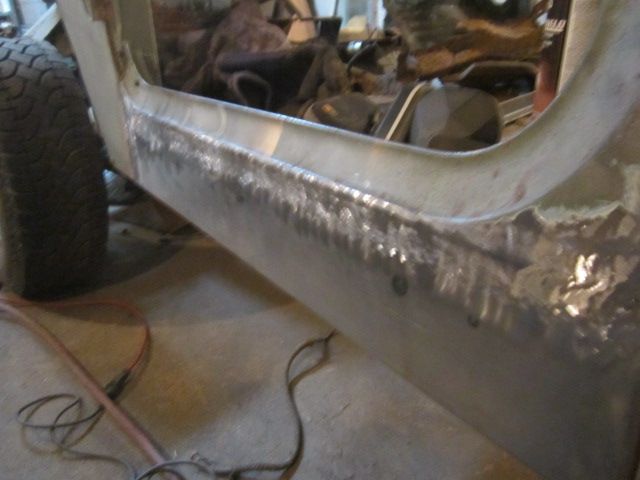

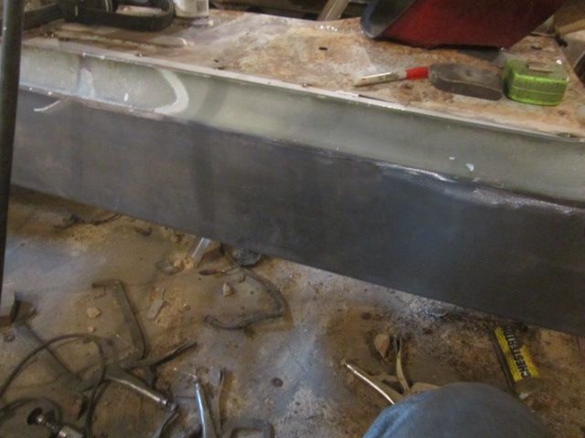

Today was a semi-productive day. I got the DS rocker fully welded up and ground. Also got the inner floor patch welded. I need to finish up the inner rocker welding from inside the truck. I was making metal bird s*** trying to poke my large dome through the door opening which is partially blocked from the support tube. Not fun:bang:. My back is thanking me now:whoops:.
Here's some pics.
After some grinding this is the finished product.

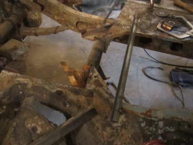

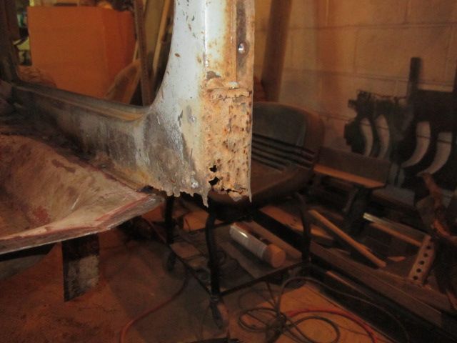

I moved onto the PS tonight for a bit. I cut off the rocker with ease thanks to Mother Nature's help. Also got the filler neck housing removed. More to come!!:cheers:
Believe it or not I swept the floor before I started this morning. The sand was what was leftinside the tub and the metal is all the rot I cut out today.

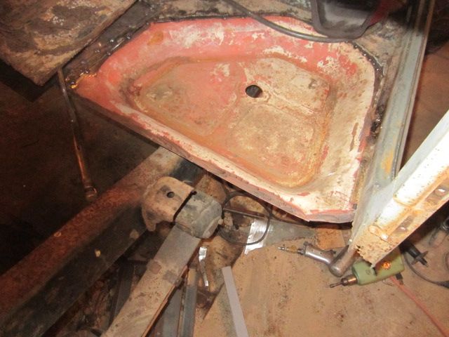

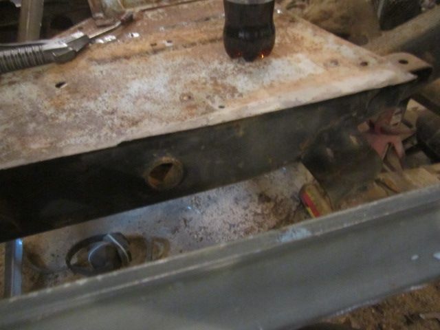

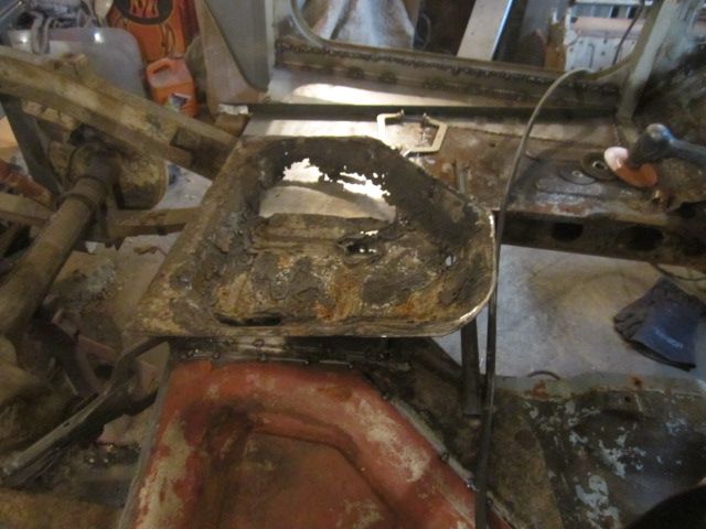

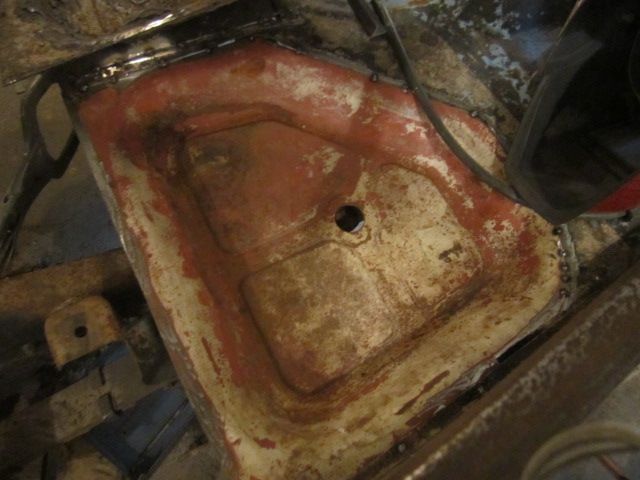

Spent a few hours on 'ole Sparkle today. I got the crusty old gas tank housing removed. I also fit up the replacement pan I got from a mud member. It took some time, but it's tacked in. Have a couple of gaps I'm gonna have to take my time with, but it should turn out good.
The rust is coming to an end. I can't believe I am actually typing this:clap:!!
This was "roughed in" with the Dealt 4 1/2" grinder with a bum disc. Got to finish it off with the roloc.

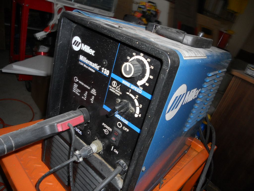

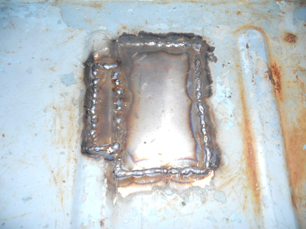

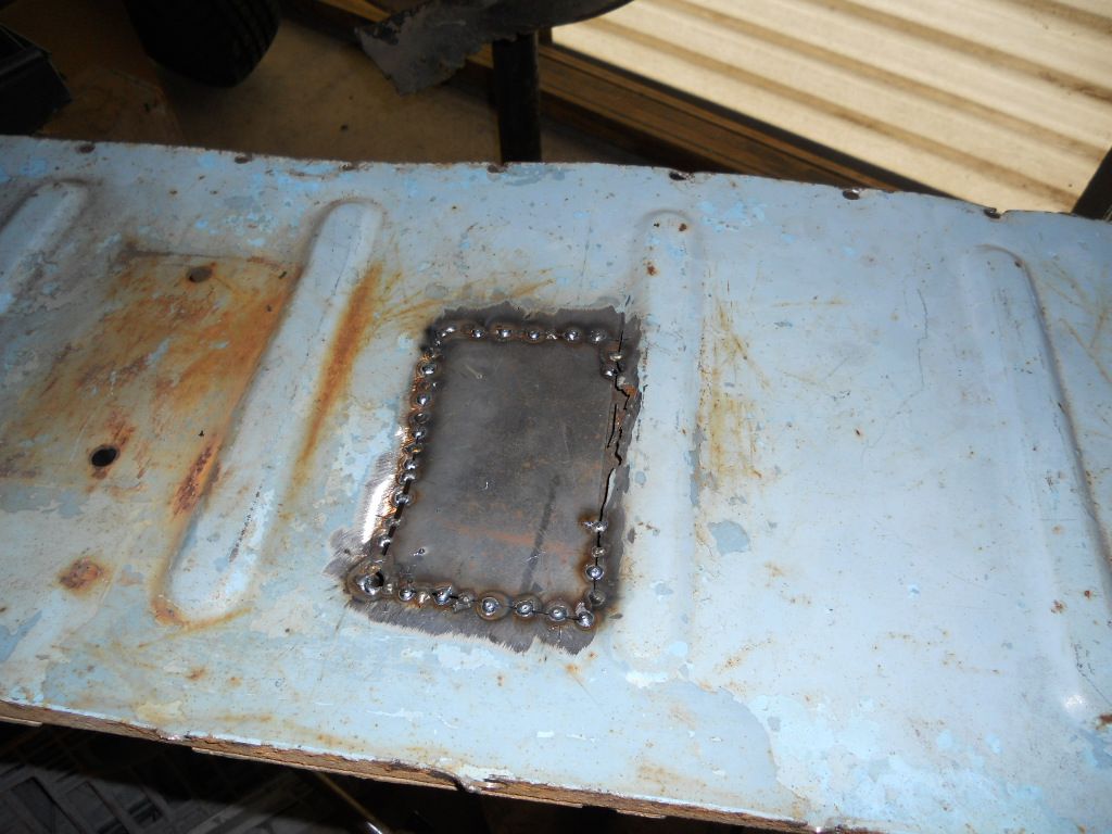

Anyway, I am still finishing up those damn wheel wells :bang:. Think I'll opt for plan B the next time around. Which is to purchase new ones. I did finally get to use the Millermatic 130 I bought a few months back off of craigslist. It worked really well even with the .030 gauge wire. I will have to go back and reweld the seam between the rib and the other patch piece. It will help it "flow" better. :D
Craigslist is GREAT!!
I had to get used to the thicker gauge wire. Gonna need another pass on the lower section of the rib once I grind it down.
