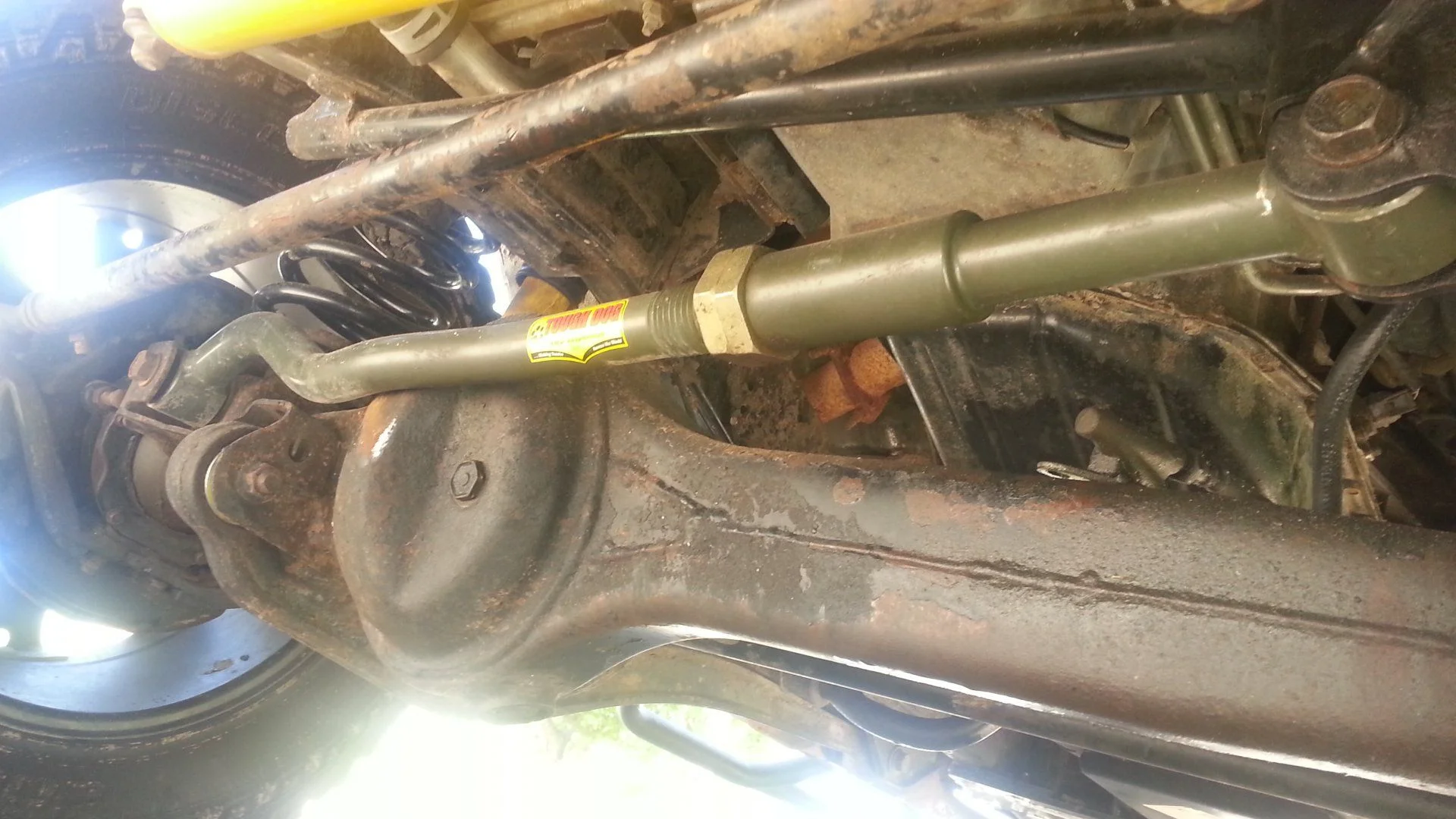

Problems with Tough Dog Panhard --- What did I do wrong??
ok, so if I can sound stupid for a question or 2.... Could it be possible that my front diff is too far forward? and, is there a way for me to move my diff back a little bit?
Im just puzzled, because until I can find the "why" i cant figure out how to fix it. I cant really blame anyone other than myself here because I sourced the parts, and put them in, but I am just not sure why things are so tight up-front and/or where something could be wrong.
Would any sort of misalignment or front end failure cause things to move forward a bit?
The axle end of the panhard mounts to the axle.... So even if the axle moved forward a bit, the panhard would also move forward (of course it would reduce the diff clearance a little due to the chassis end being fixed). Unless the chassis end of the panhard mount is way way in the wrong place (big accident etc - that would show up as a lot of other problems....), I can't see how you can have so little clearance EXCEPT for something being wrong with the TD panhard.
Find another 80 (local/friend/2nd hand lot etc) and compare mount locations and panhard bends OEM to TD to figure out what is going on with your setup.
Of course the BIG question is: Did you have any clearance issues with the OEM panhard?? If the problem only now exists due to the TD installation then draw your own conclusion.... :)

I'm wondering if this thing was a defect and not bent around the diff as much as it should be.. maybe you can get some measurements on how far that diff bend is from being in line with the rest of the bar and have them compare to others.

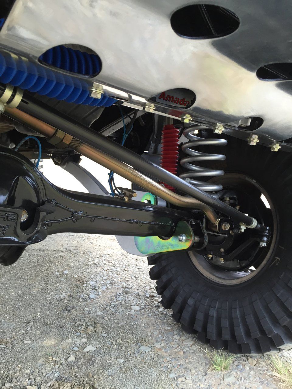

It might be the photos, but on my rig.... it appears that my panhard is sitting much lower, toward the middle of the pumpkin. Were these taken on a lift? Theres no real in-out adjustment for the panhard, so im guessing its camera angle, but if my panhard were resting up top like that, id have no issue. My panhard is pretty much right across the middle where the pumpkins bulge is the widest.
Nope - the vehicle is sitting on all 4 wheels in my driveway when I took the picture. And yes, yours looks lower and of course also way too close/scraping the front diff.
Note that the axle will move up as the vehicle articulates etc, so you still NEED clearance in front of the diff.
Until proven otherwise I'd suggest the TD panhard is just plain wrong, unless your front end has been in some massive accident that has bent/deformed chassis, arms, axles etc (which seems unlikely...).

From what I can see in your pics, it looks to me you have a right hand drive rod. My 80 is right hand drive. You can see in my picture how the diff housing is not a factor. Rod needs no bend to clear the housing.mine was shipped in from Superior.
It may be an issue of the bushing sleeve being welded on in the wrong position. If the tube on the axle side were rotated say 30 degrees clockwise it would move the hump away from the diff.
Dang, that's show car stuff right there. Beautiful!

That bend is definitely worth looking into. I will fwd this back to the manf and ask them about it.
Got an affirmative reply back from Tough Dog! I must say, they have been VERY good with communication and follow though so far.
Mr. Knight,
[Our Quality Assurance team has reviewed your photos] The welding jig was found to be a few mm out and when the eyering was welded it was not on the right angle so when the bar is fitted it twists the bar and the bend comes in contact with the diff pumpkin.
