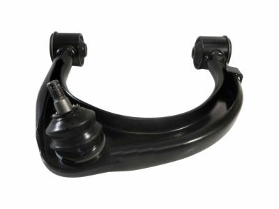

I'm getting a parts list together for a Cyber Monday order this fall and I will be targeting suspension components on my 2013 LX570. Can anyone confirm if the LC200 upper/lower LCA are interchangeable with the LX570 version? How about shock bushings/mounts?,

LCAs are. Upper control arms are not. The LX UCA has an extra tab on it for the height control sensor.

Thats the same part # i used for my 2010 LC200 (see above) per their diagram. I i remember correctly, my brake line (or something) attached to that tab
