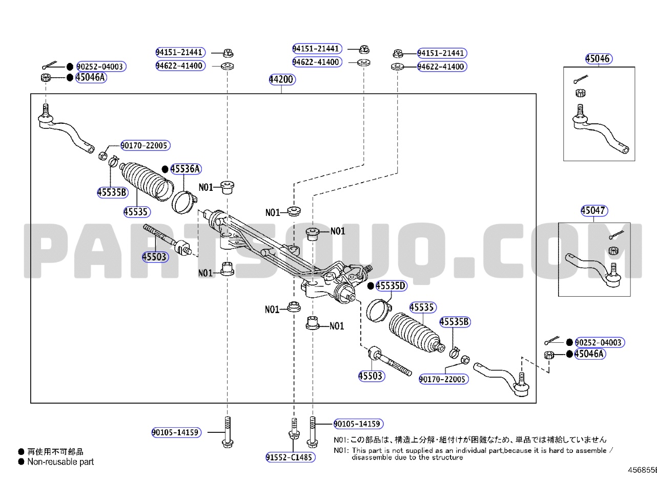

The part number encompasses everything in the boxed area, including bushings and tie rod ends, but not the castle nut and pins. There's a note in the diagram that indicates the bushings are "not supplied as an individual part, because it is hard to assemble/disassemble due to the structure".
