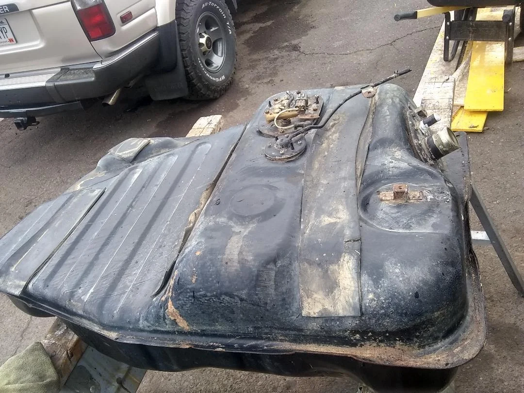

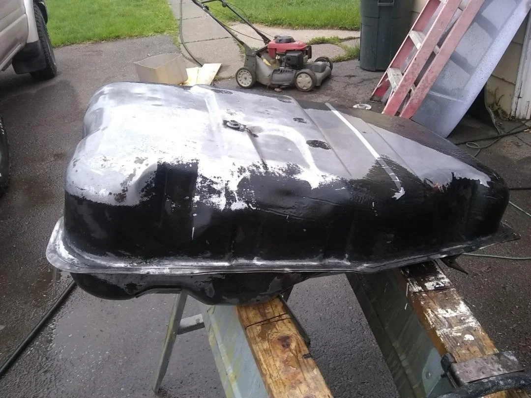

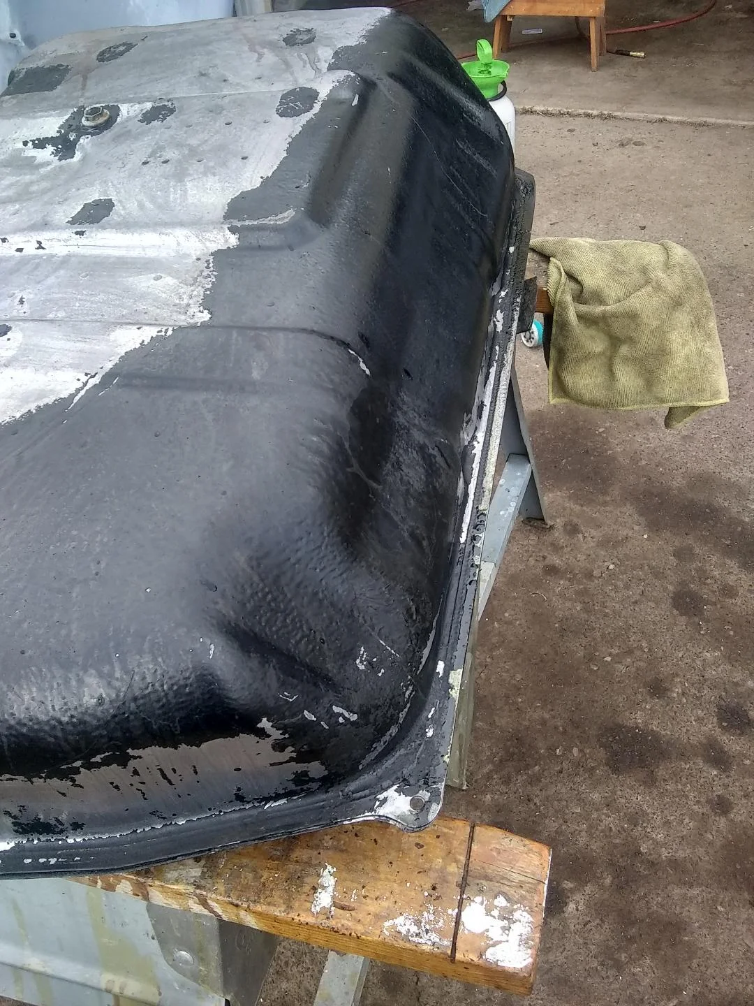

I am in the process of prepping a used tank for install along with a refurbed skid plate, filler neck, new fuel lines, hoses and gaskets. I am having a heck of a time getting the old paint and whatever is sprayed on as an undercoat off. I have tried Simple Green, Vinyl flooring stripper, two types of paint stripper(both the citrus stuff and the heavy chem Bullseye), oven cleaner, some ZEPP 505, paint thinner and scrubbing and elbow grease. No real progress.

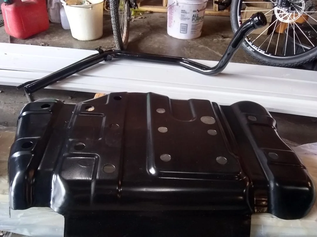

I want to get this down to bare metal so I can use acid to get the few rust spots treated and then coat with POR 15 and then topcoat with chassis paint.
I already did the skid plate that way and the filler neck just needs to be top coated to finish it. I think it will hold up much better than the stock system.
I am reluctant to attack it with the angle grinder because I don't think it will work and I don't want to damage the metal.
Any ideas as to how I can get this cleaned up?

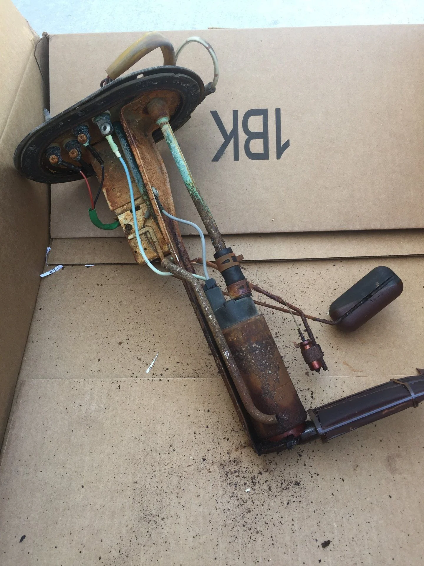

any suggestions on how to clean the insides of the tank? sat for 5 years with gasoline (now varnish) in the tank, lots of rust. picture shows just some rust I could pick up from the fuel pump area. Thanks in advance
I have heard of people filling the tank with vinegar to have that dissolve the rust. I don't have any first hand experience doing that in a tank, but I have cleaned rusty parts with vinegar with good results. Acid might also be an option, but I would want to be sure I got that all rinsed out before reinstalling it, same with the vinegar.
I have heard of people filling the tank with vinegar to have that dissolve the rust. I don't have any first hand experience doing that in a tank, but i have cleaned rusty parts with vinegar with good results. Acid might also be an option, but i would want to be sure I got that all rinsed out before reinstalling it, same with the vinegar.
thanks! somebody did suggest muriatic acid ☠️ wanted the check with the experts. cheers
evaporust works. if you cant get it fixed let me know. i have a few good tanks.
I bought a replacement tank from him and it was shiny inside and worked perfectly after my tank cracked! How much are you going to spend for chemicals and time jacking around with his? Buy a replacement and ship it. It's less money than you think.
Just take it to a radiator shop and let them vat it, we also get the tanks epoxy coated on the inside there also.
I am still trying to decide which direction I want to go. I am not going to have the inside of the tank treated though. People have mostly reported problems when they have done that. This tank is pretty clean, it just has a little surface rust on the top and on the edges in a few places. The inside should be good. Before I stored it last fall, I put about 20 desiccant packets inside of it and sealed it with tape and plastic. It was stored in the rafters of my garage.

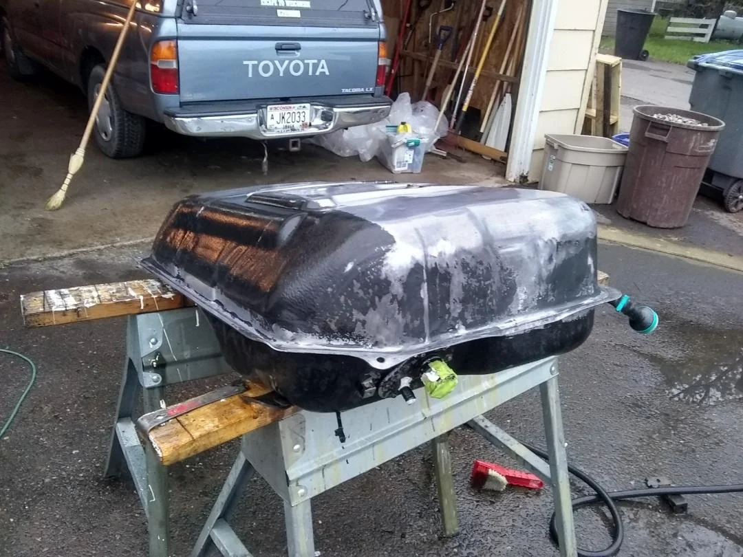

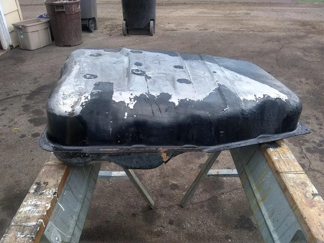

Made some progress. I am mostly just going with the angle grinder here with a little bit of spot sand blasting on the rust patches. Lots of work, but it will end up good.

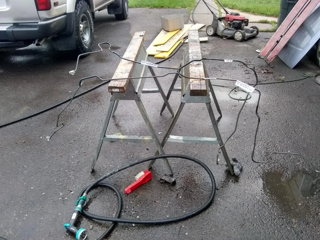

Those fuel lines are going to be a challenge but I want to get them in somehow.
