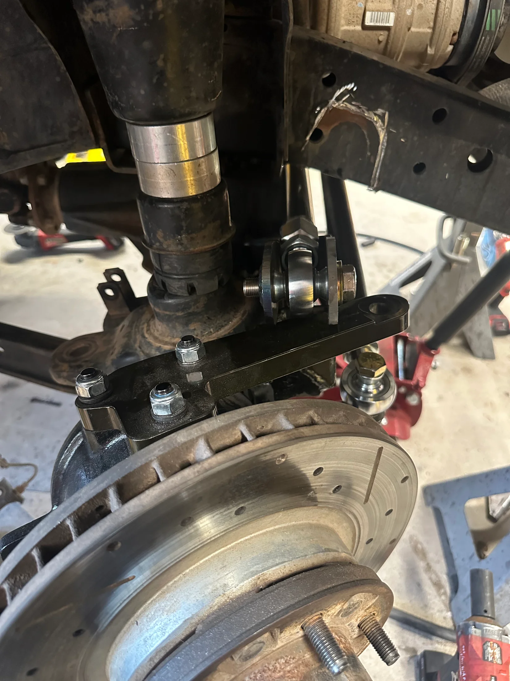

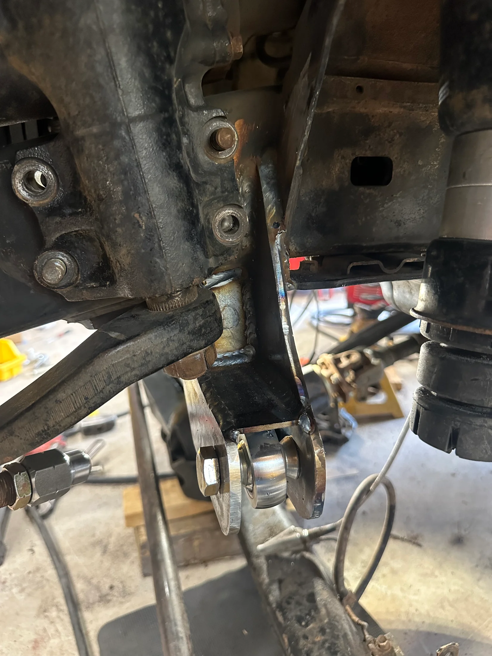

I have a couple stock 80's at my shop and several customers who are on the dobinson stock height springs. These trucks ride and drive best when stock and get dramatically worse with a lift and weight added. The suspension geometry is not great stock and is horrible with a 3" lift. It's amazing they drive as good as they do, because on paper they should not. The front panhard is about 11" shorter than the drag link and ends up at a terrible angle when lifted. The rear lower links and front radius arms end up at a steep angle when lifted, then they are no longer transferring the force of bumps directly into the suspension but rather more directly into the chassis as lift height increases.
On my 80, I have dobinson tapered wire rear heavy springs and j's in front with a 20mm spacer. Ends up about 3" lift. Icon extended length 2.5's (which ride nice, but I don't reccomend) and a 37x17" wheel and tire combo that are 115lbs each. Last year I lengthened the front panhard 9.5" over stock and raised the axle side mount 4.25" while raising the frame side 2". My panhard is as close to flat as possible and within 1.5" of the drag link length. The truck drives exponentially better now with no front sway bar than it did with the stock panhard and sway bar setup. IMO it still drives like crap compared to some fully custom trucks I have built suspension for, but it is light years ahead of any other lifted 80 I have driven both on road and off. The moral of the story is unless you correct the geometry when lifting an 80, it will always drive and ride worse than stock. The only products on the market that correct geometry in a meaningful way are the rear panhard axle side lift brackets and front radius arm frame side drop brackets. Everything else is either snake oil, or for correcting pinion angle or aesthetic geometry like adjustable panhard bars.
If you want to keep the lift, do the rear delta panhard bracket, eimkeith radius arm drop brackets and get custom valved remote reservoir shocks with adjusters from accutune, down south, or a local shop that will do them (I know one in denver). Next time you get new tires, drop load rating or get a softer e rated tire. Otherwise, stock height dobinson springs and 33's or smaller will make a world of difference.

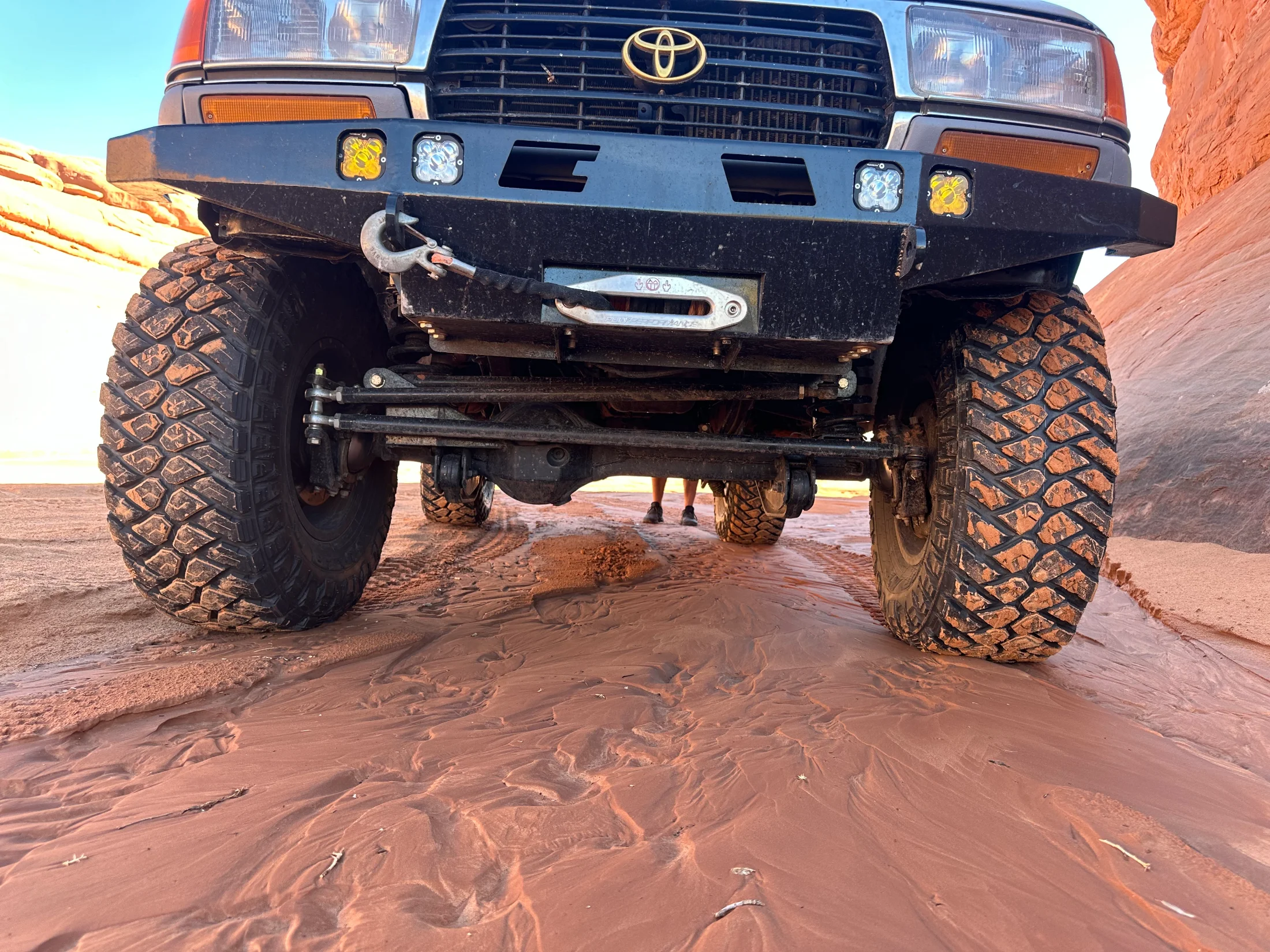

Have you posted Pics anywhere?
Yeah, in a few places on mud. Here are a couple
