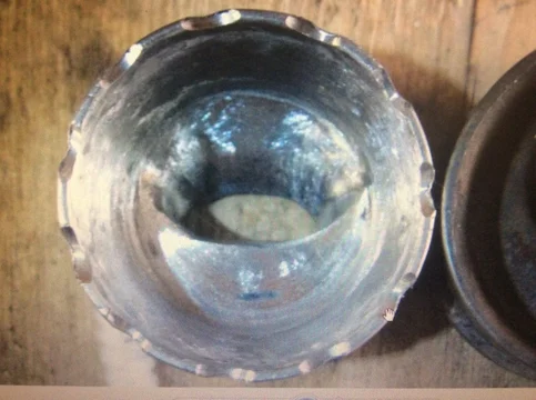

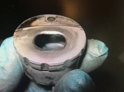

Here is what I did with my last set of precups since this is a precup thread and not an IDI sucks thread. Since heat loss into the head through the precup is a negative, I decided to decrease the loss by decreasing the contact surface area in which the precup uses to seat into the head. I scalloped the surface areas with a die grinder and decreased it by about 1/3 by my estimates. All precups already use machining processes to cut its contact area to a minimum, I just went a little further. I wanted to decrease contact area but maintain the cup securely in the head and not create room for movement.
I figure this will allow the cup to shed less heat into the head and thus the precup itself will run hotter than normal. This might decrease ignition delay and speed flame front propagation a bit.
It will also slow precup cooling upon shutdown as there is less area to transfer heat. I personally believe this is partly why precups crack. I also radized the outer edges of the openings to spread the stress out a bit as almost all precups I've seen that are cracked do so at the beginning of the outer run just after a long straight section. The machining is actually at a fairly sharp angle and also happens where the metal is the thinnest. I radized the corners but didn't want to change the opening shape much as it directs the air fuel mix in a specific way onto the piston. I also did some blending inside the precup to increase swirl velocity as there are many sharp steps and edges inside. I also wanted to decrease pumping losses exiting it.
