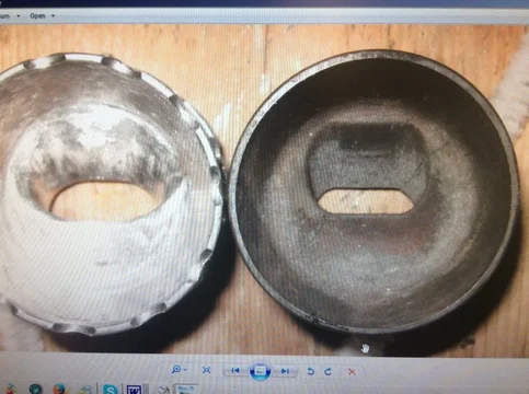

Here is a good example of a cracked cup next to my radized cup. You can see two crack starting right at the cornered where the machining makes a abrupt angle and the metal is thinist.

Heating and cooling metal has a predictable effect on it and I remember reading about different types of metals like inconel vs stainless steel and the "cycles" you can expect from them. When I said precups break from neglect I mean folks basicaly run their engines completely ignorant of they fact that they are an item that requires replacing just like a timing belt or an injector or any other item like that. Its life might be longer, but it still should have a scheduled maintance regime rather than wait till it breaks and curse the design. If you waited till your timing belt broke and hated timing belts cus they chuck rods out the side of engines no one would really take you too serously.
Coolant temps shouldnt be able to influence your precup temps much as its going to normalize to your incylinder combustiopn temps regardless of what the head is. Changing your coolant temp by 20 degrees wont mean much if your precup is 1000F all the time. Strangey though running cooler colant temps will lead to greater waste as there will be greater disparity between the combustion temps and the coolant leading to more thermal transfer.
Running more fuel in the engine for more power will lead to greater waste heat going into the coolant system. Something like 1/3 of the BTU of the fuel is coolant waste so if you double your fuel its not to weird to think you just doubled the thermal load on your coolant system. If your system is old and decrepid, much like many of your cruisers are, it wont take much to overwhelm it. Shoot some of our truck have a hard time driving on the freeway in the summer.

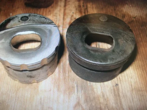

Well im driving it right now with timing retarded. Ill bump the timing up when I intercool it some time perhaps next summer. Pulls vey hard down low due to the timing change, but it does have signifigant more power than before througout the rev range. Tuff to tell exactly what to atribute it to exactly cus I took a long time porting the head on it as well and changed the turbos at the same time. Overall egts dropped WOT at 2500 down about 100-150F even with retarded timing. Its by far the the most fun ive had driving a 3B.

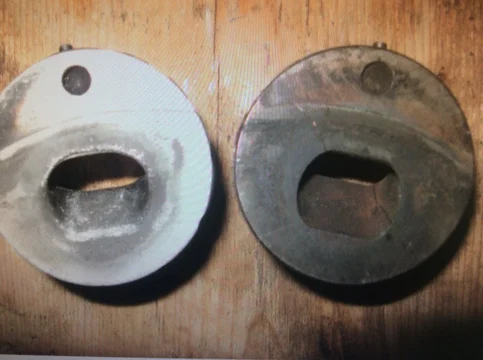

Ahh no problem. In hind sight I could have drilled small depressions into the face of the precup that contacts the head gasket to reducae transfer as well as it represents a very large percentage of the overall contact area.
I also thought of blending the opening of the precup on the piston side, but was not sure if allowing more air into the prechamber was a good thing. Reducing pumping losses would be a bennifit, but allowing more air in might allow for a more complete burn in the prechamber and more heat to soak and be lost into the head. Im still not sure on that. I could see it agrued either way. Changing the opening so that it interferes with the jet and how it acts upon the piston contures will also allow the flame front to contact the cylinder walls to a larger degree which is a definate power loss. Lots of incomplete combustion on or near cylinder walls.
