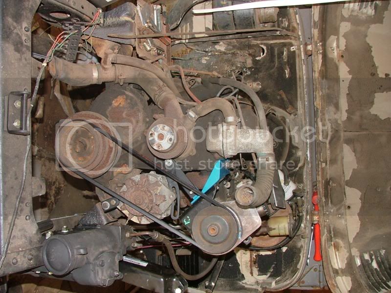

here is what I did (mines an F no emissions!)
its a fabed bracket with a scout sag pump bracket for adjusting the belt.
but I second using the 60 pump. it should bolt right up.
hope this helps
chris
