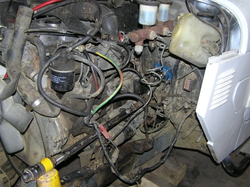

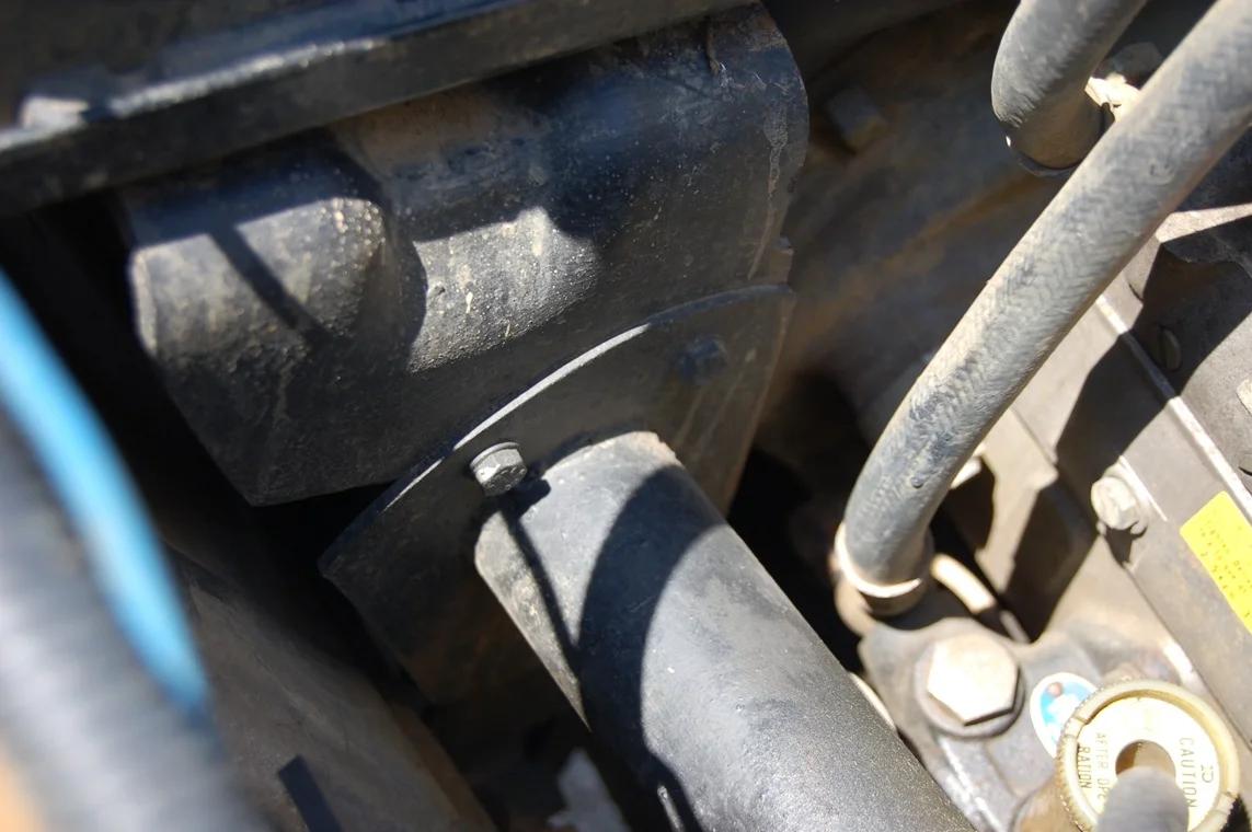

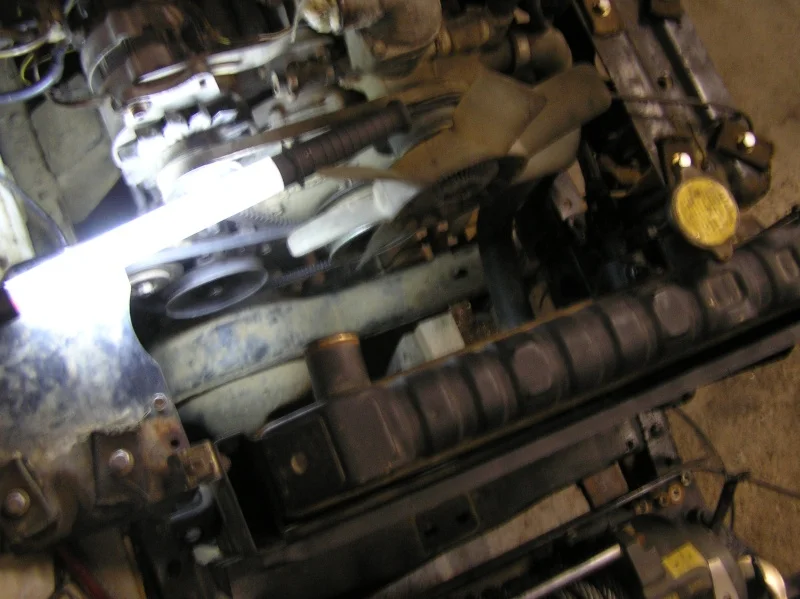

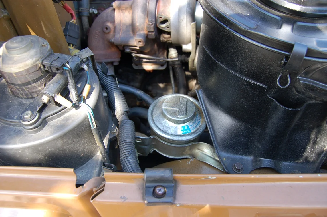

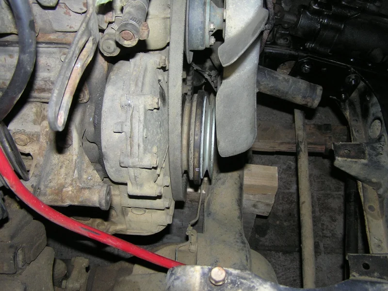

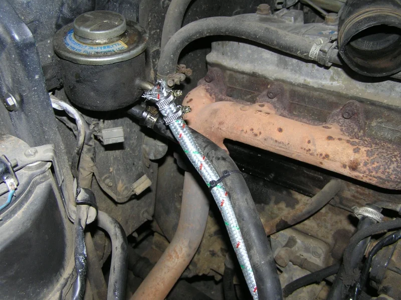

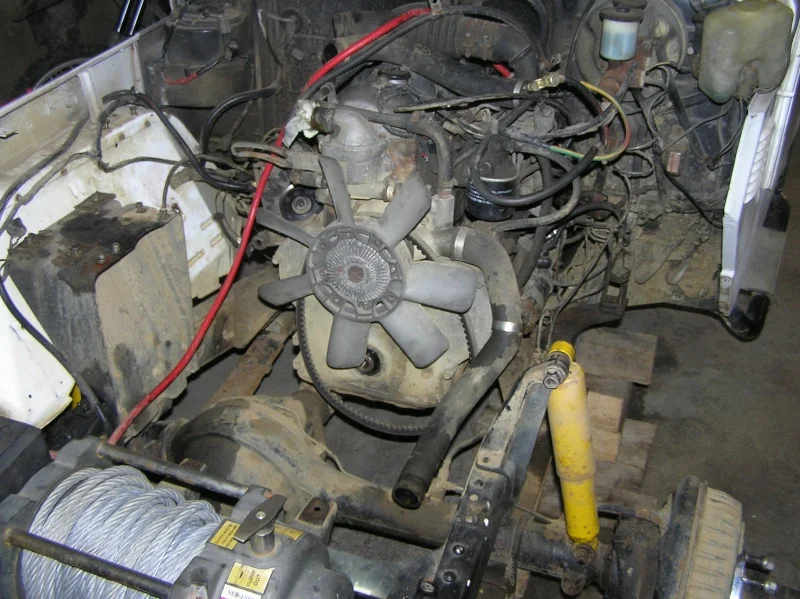

Use of the 70-Series P/S seems to be common practice in France. I think it works pretty much like the 60-Series set up.
Driven, years ago, a so equipped/swapped BJ43: impressed!

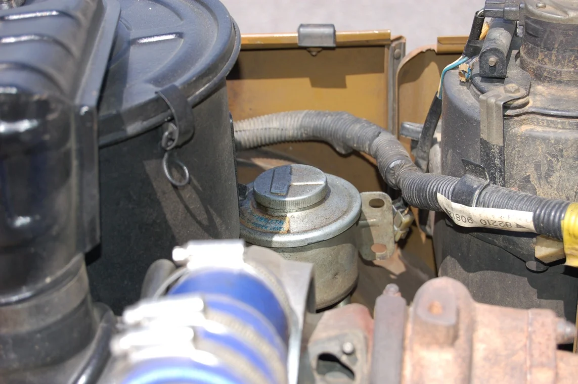

Some close-ups at the engine bay:

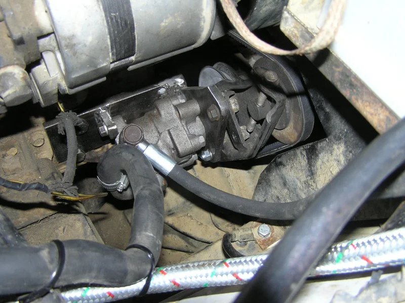

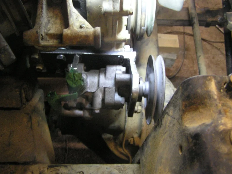

@Greek Cruiserhead

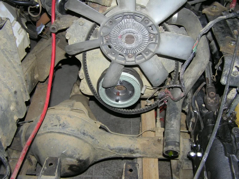

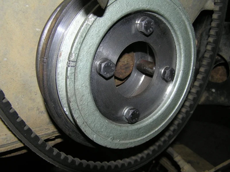

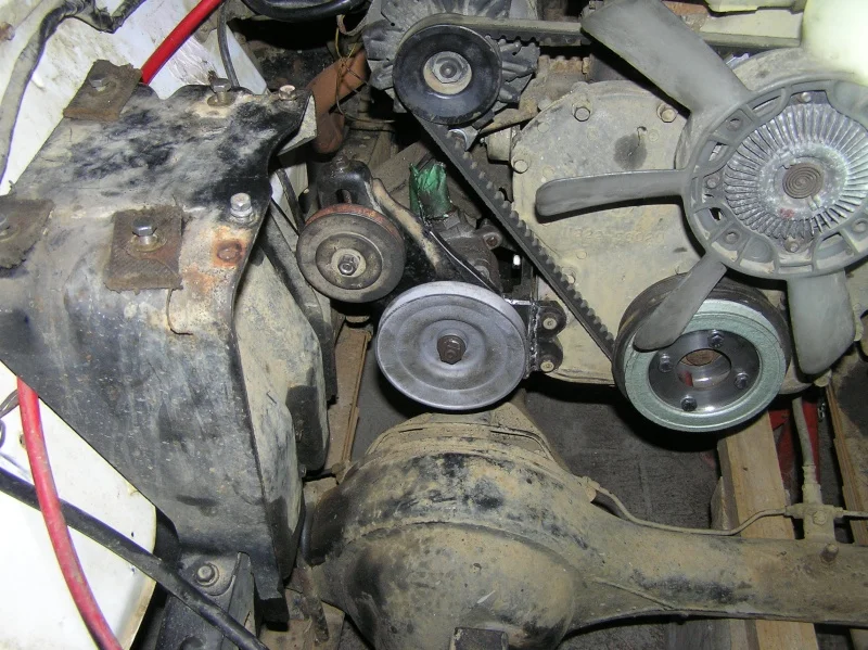

Thanks for the great pictures of the 70 series power steering upgrade. Would you have any photos of the power steering pump and pulley and how it bolts on?

@Greek Cruiserhead

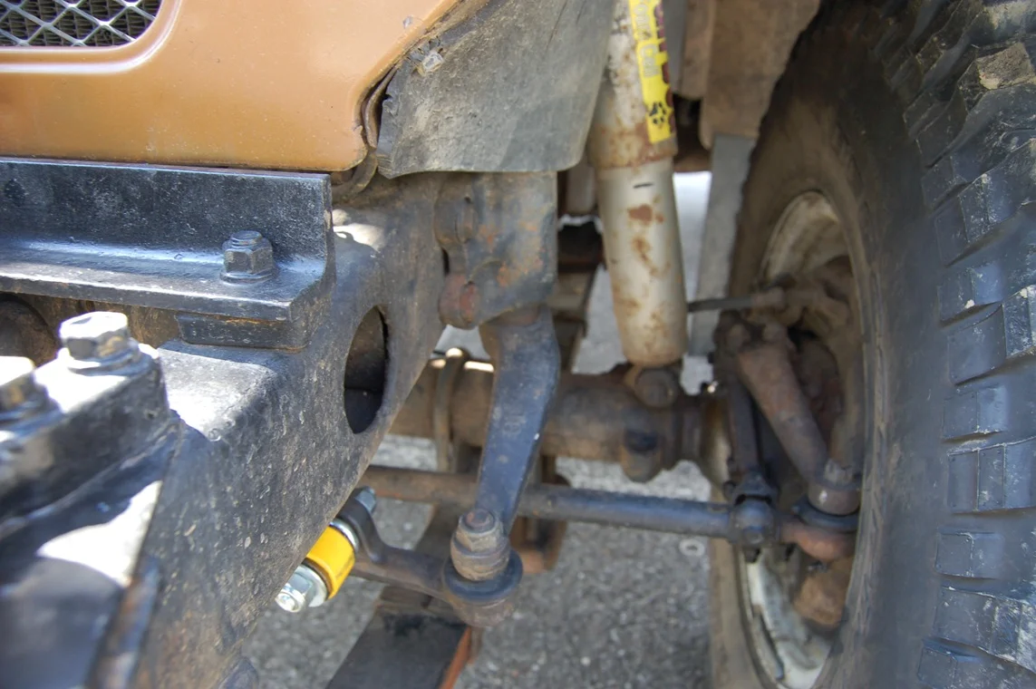

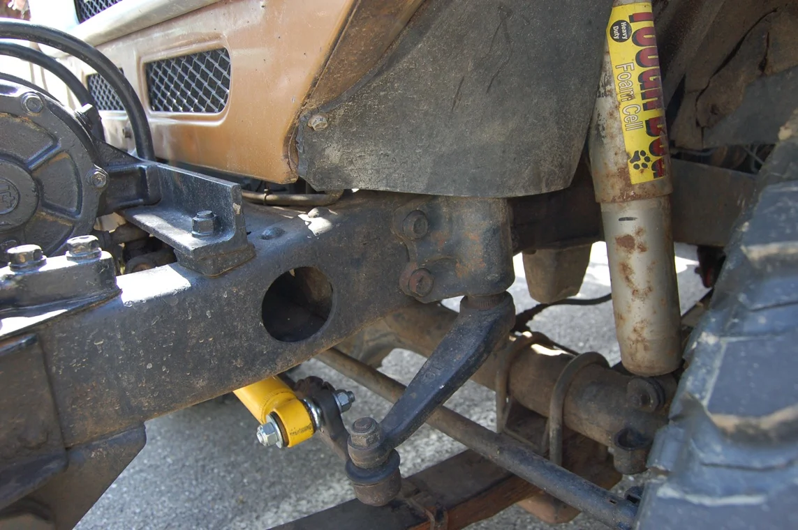

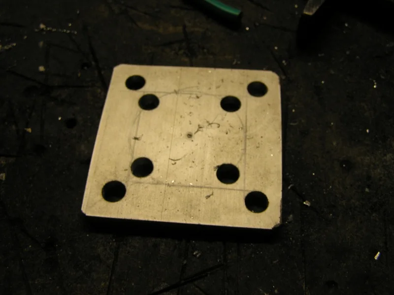

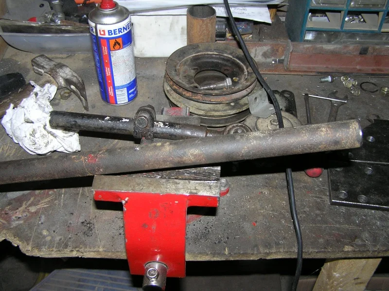

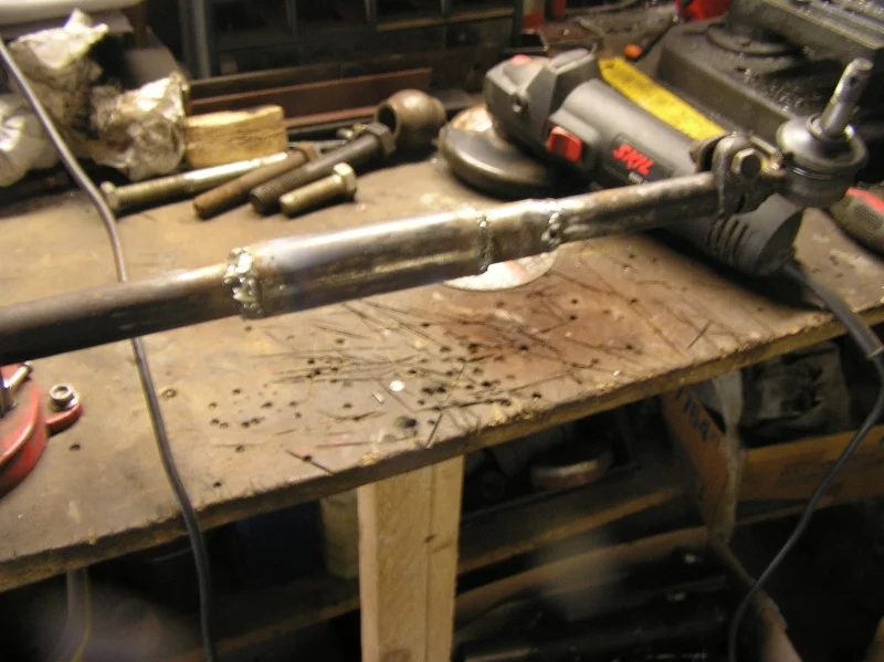

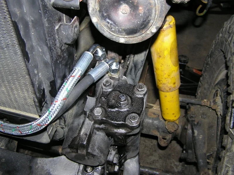

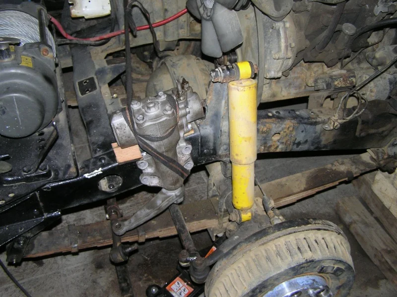

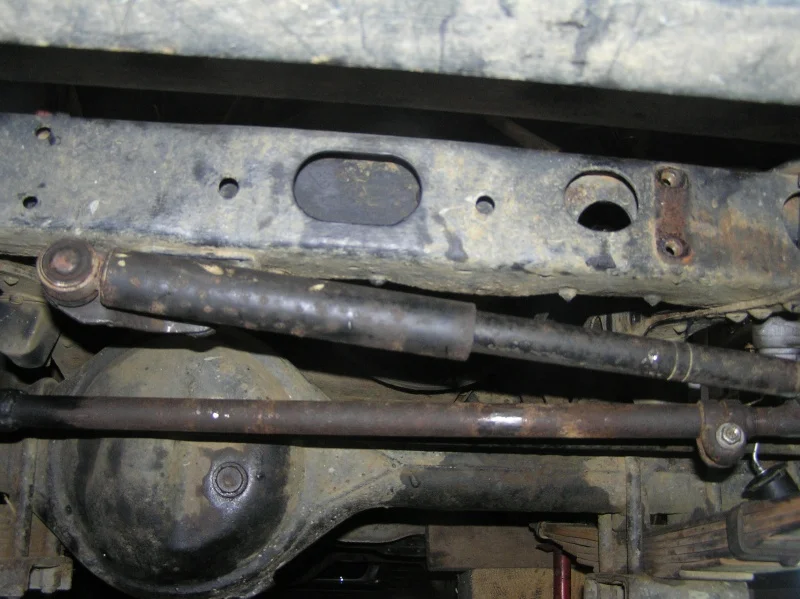

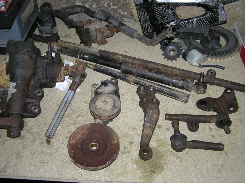

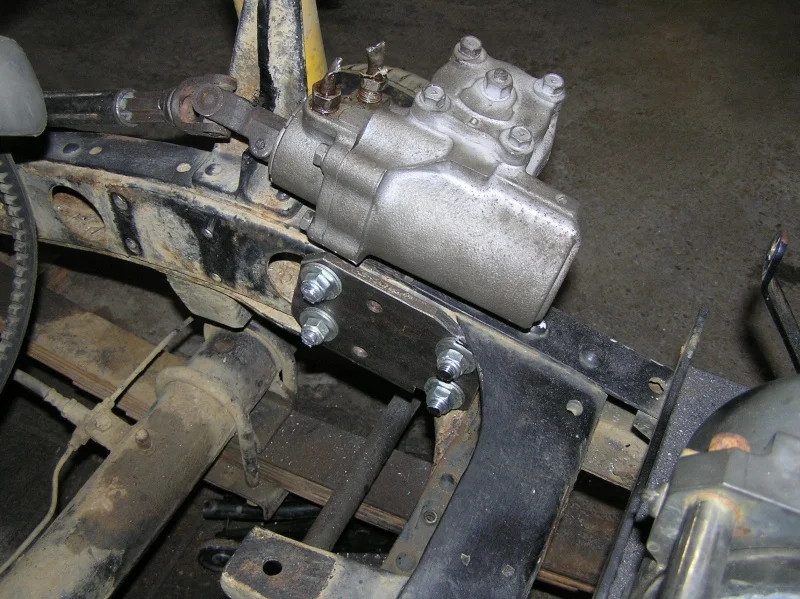

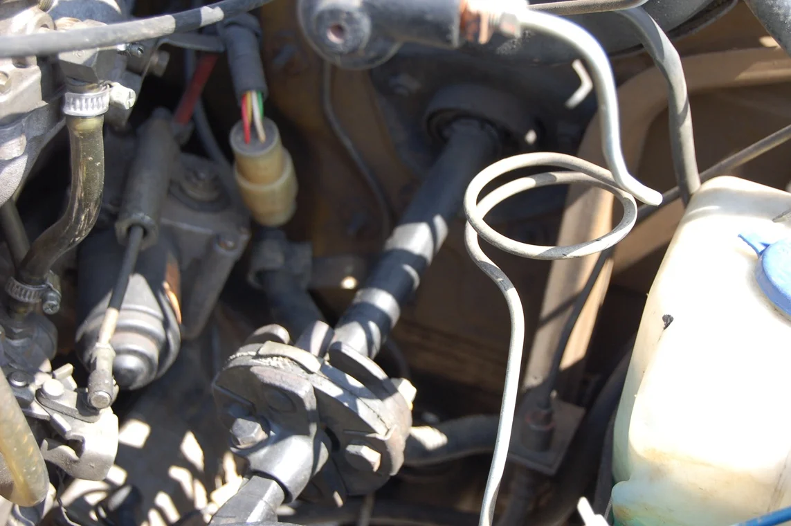

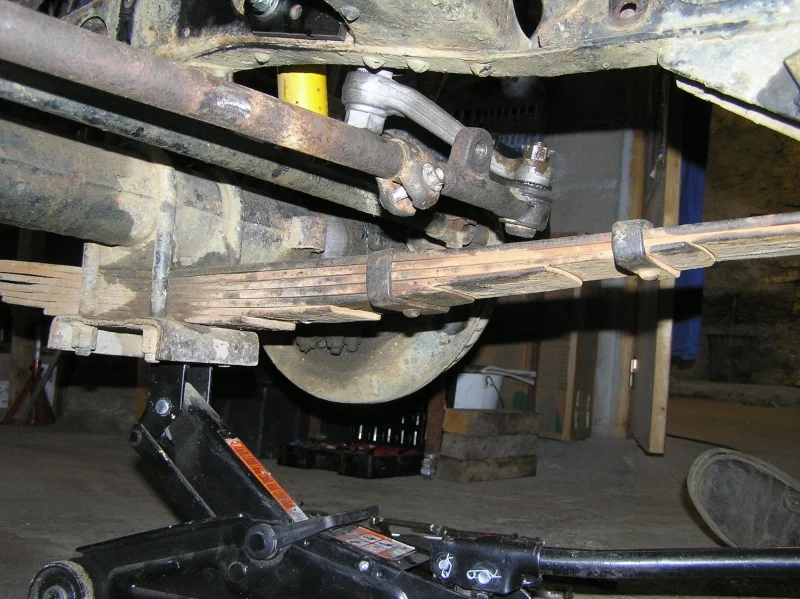

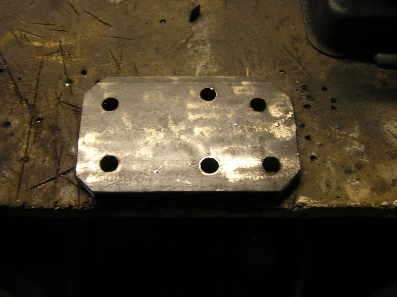

Hi mate,
I will try to upload all the twenty three (23) pics concerning this swap I have in my archive (from an old French source).
Hope it may help...
The next five:
The next five:
Another five:
and the last ones:
Great photos @Greek Cruiserhead! Thanks for taking the time to dig these up and post them. I'll have to remember to document my build also and pass on the favour for the next BJ40 conversion.
