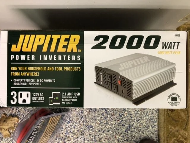

OTOH - I see 2000W converters for $120sh which I can add to the truck (always useful) and use my existing saw.
Will stock alternator/battery work fine with 2000W inverter?
Is 2000W inverter enough for chainsaw?

remember that when you start an electric motor you may have a draw much higher than the normal rated power. You'd want to plan for that for your inverter sizing or you can fry stuff.

if your saw uses 150W or less when running, a decent 2000W inverter should be able to handle the peak draw at startup, I would think. The alternator doesn't care whether it's a 100W or 2000W inverter, it only has to handle the battery draw when the load is put on the battery, which I can't imagine should be a problem, especially with the battery as a buffer. So, seems to me that you should be OK with the above. But of course that depends on the quality of the inverter ( I don't know the brand). As an aside, note that a 2000W inverter is rather oversized for the typical leads you'd find on a 12V system, they would have to be able to handle over 150A to max out the inverter, which would require hefty battery or winch-type cables, not normal accessory cables, but that's OK if you don't use it with skinny cables and heavy loads.
Cable they suggested/allowed is 2awg 6ft. Which brought me to another question. Where do I mount this thing (big) and how do I route those cables?

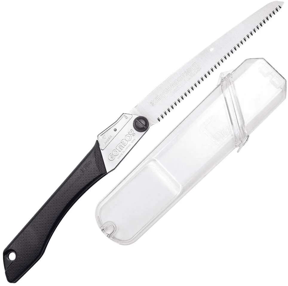

My Silky-Gomboy folder is a workhorse. This 240mm is one of the best pruning blades. Easily works through a 4" branch. Super tough Japanese steel.
Occupies one of my door pockets at all times.
yep. A Silky saw is in a class of its own. You'll probably have sawn through a 6" log faster with one of those than you can start a gas chainsaw or connect an electric one...
