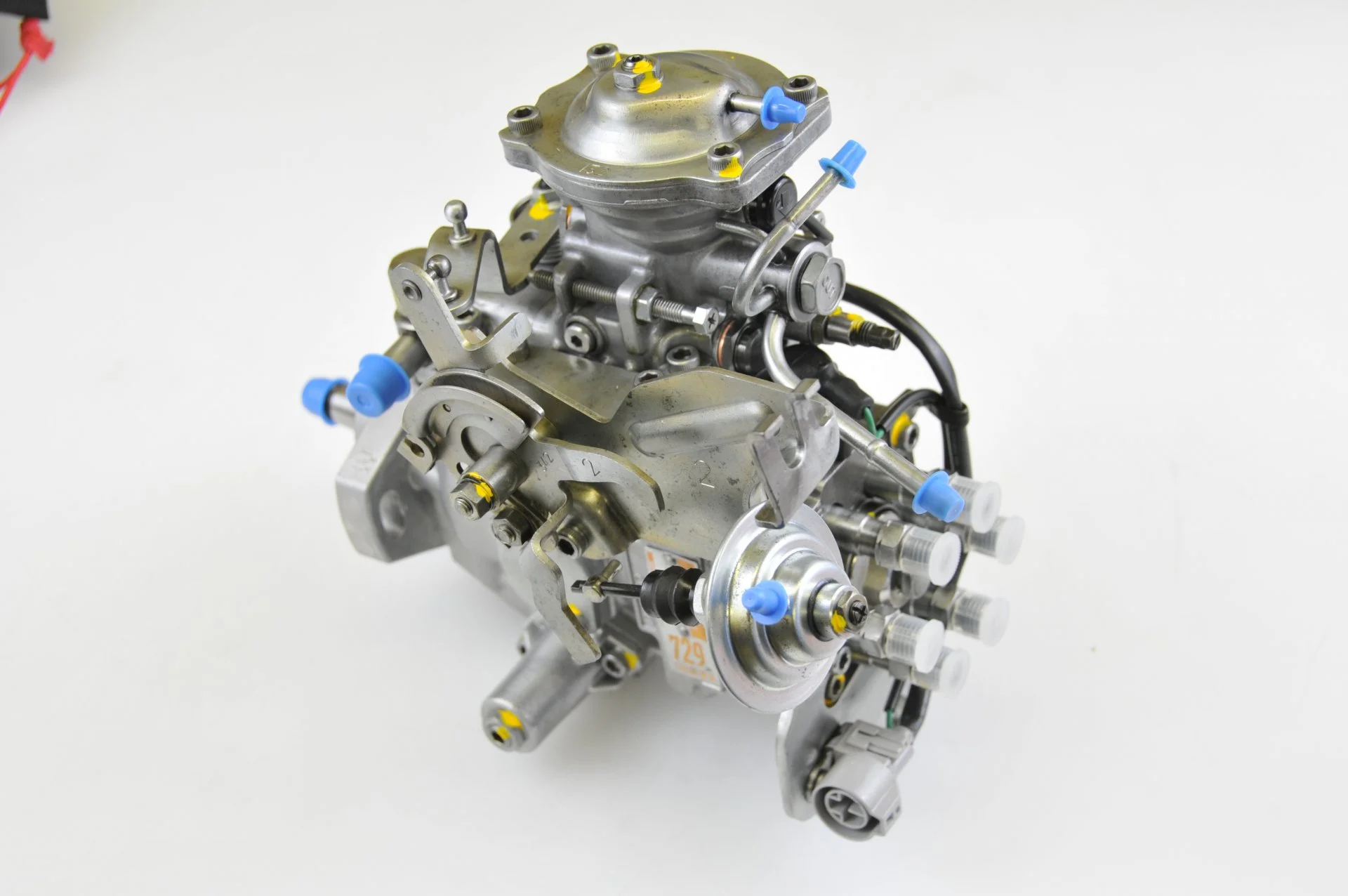

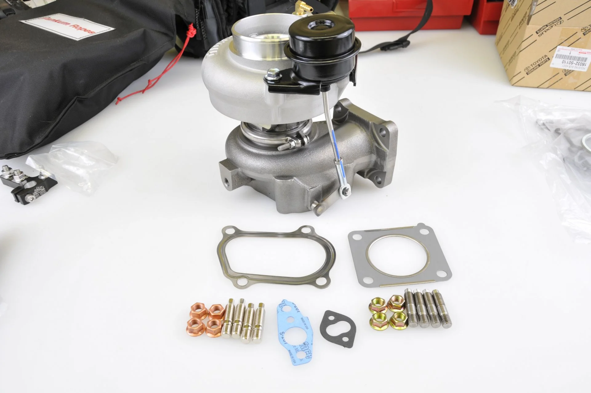

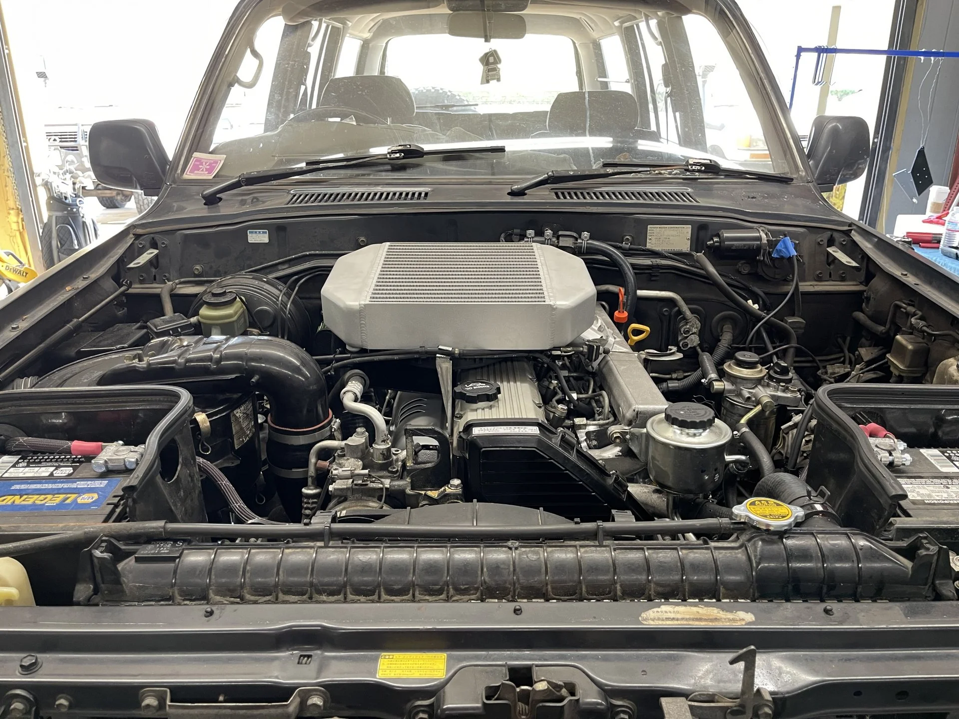

just did this about to go thru another one
New OEM (not EBay fake garbage) injectors, rebuilt injector pump tuned for larger psi turbo, new GTurbo Grunter green wheel, and intercooler to keep EGTs down.
massive power difference.

In order of mods:
3” exhaust system
Intercooler
either increase boost to 14psi on stock turbo or replace turbo and go for higher boost.
