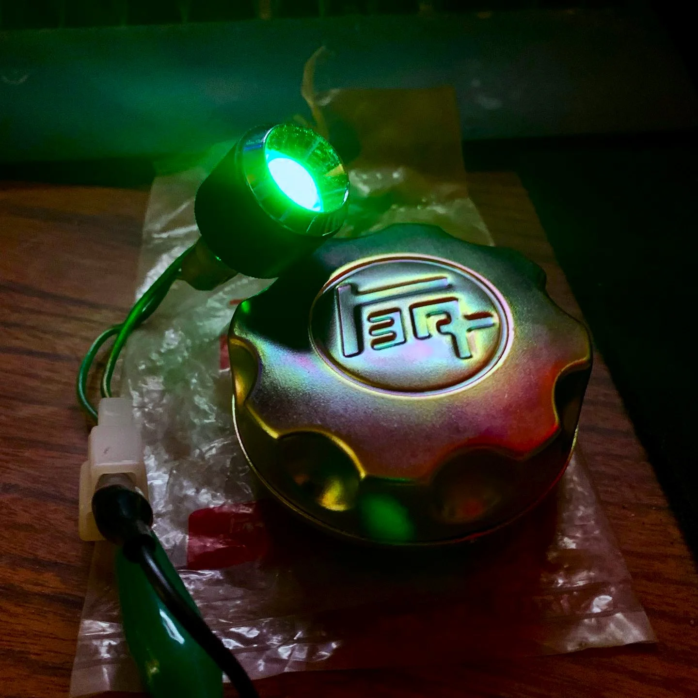

mr. Pablo ,
have you given thought yet to as where your in-dash
OEM Green 4WD Indicator Lamp of one OEM kind or another will fit , form and function cosmetically ......
i have seen non-usa FJ55's / FJ56 / BJ56's with the Baby-KOITo chrome trim-ring'd one , ill try to dig up a tech pic......
did 1967-1972 FJ55 's ever have a
Green 4WD indicator lamp of any kind ? im not sure .....
it would be super killer-kool if there was a provision or knock-out location in the cluster-meter gauges pod .......:popcorn:
mr. Pablo ,
.View attachment 3791996

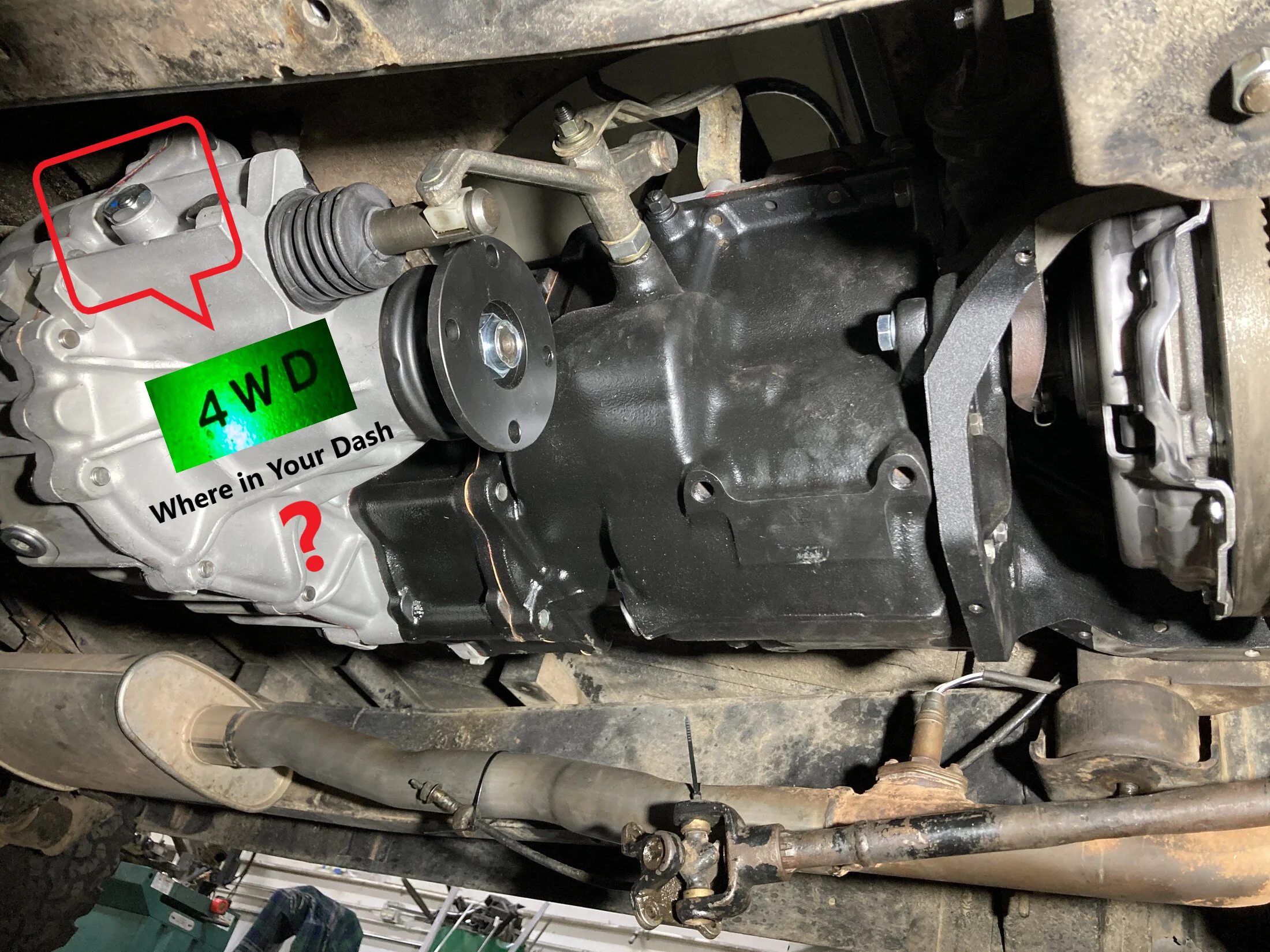

Thanks Matt, LMK if you find any pictures of a factory light.
Mine is a ‘74, FYI.
I have been driving the Pig over to @Bump It Offroad it sure is nice to have that 5th gear and smooth, new clutch.
I need to finish the H55 swap, she was driveable on the H55 right around a year ago.
  • Transmission tunnel - move the holes. Right now a lot of hot air comes in from the gap.
  • Speedo cable. I ordered one, now I need to put it in.
  • Leaky gasket on the back cover, I just ordered a replacement
  • Hook up reverse lights

I was trying to find your post where you said you just cut a rectangle and basically flipped it to move the shifter hole for H55 into FJ55.
Any chance you remember where that is?
Did you do the same for the t-case hole?
My metal fab guy didn't think that was going to work, so I wanted to send him your post.

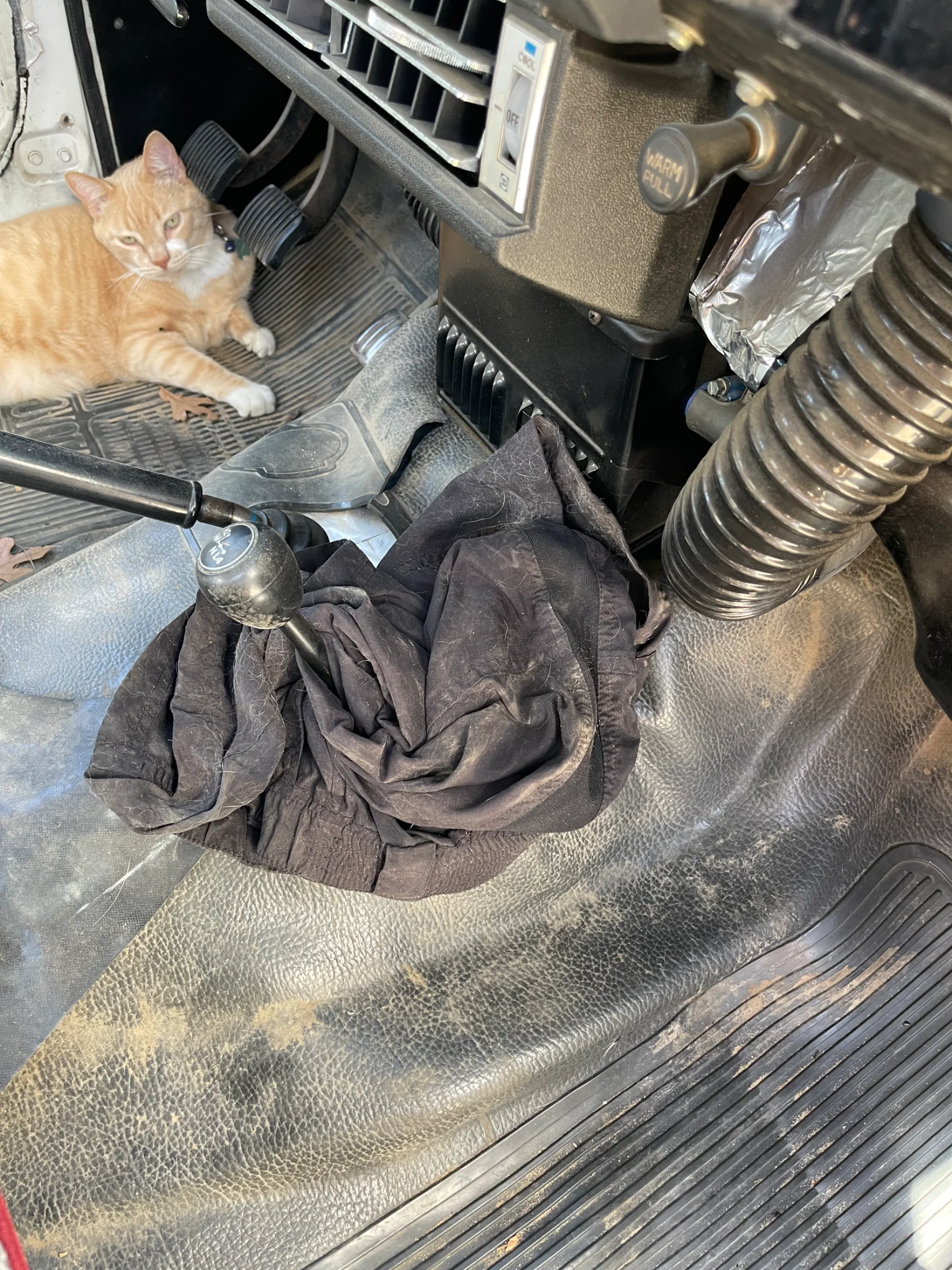

Like I said, a lot of hot air enters the cabin when the transmission cover is sitting back for or five inches. I feel like air just washes right through the engine compartment, over the exhaust manifolds, and then right on in!
TJ, i have found this highly modified pair of old mountain bike shorts to work rather well. No welding and can be adjusted as needed.
If for some reason you need a pair of shorts in a pinch, you have a spare set riding along with you.
While I fully endorse the value of extra shorts, I don’t think this will block all of the heat.
I did chuckle when bike shorts changed the pad from beige to brown…
