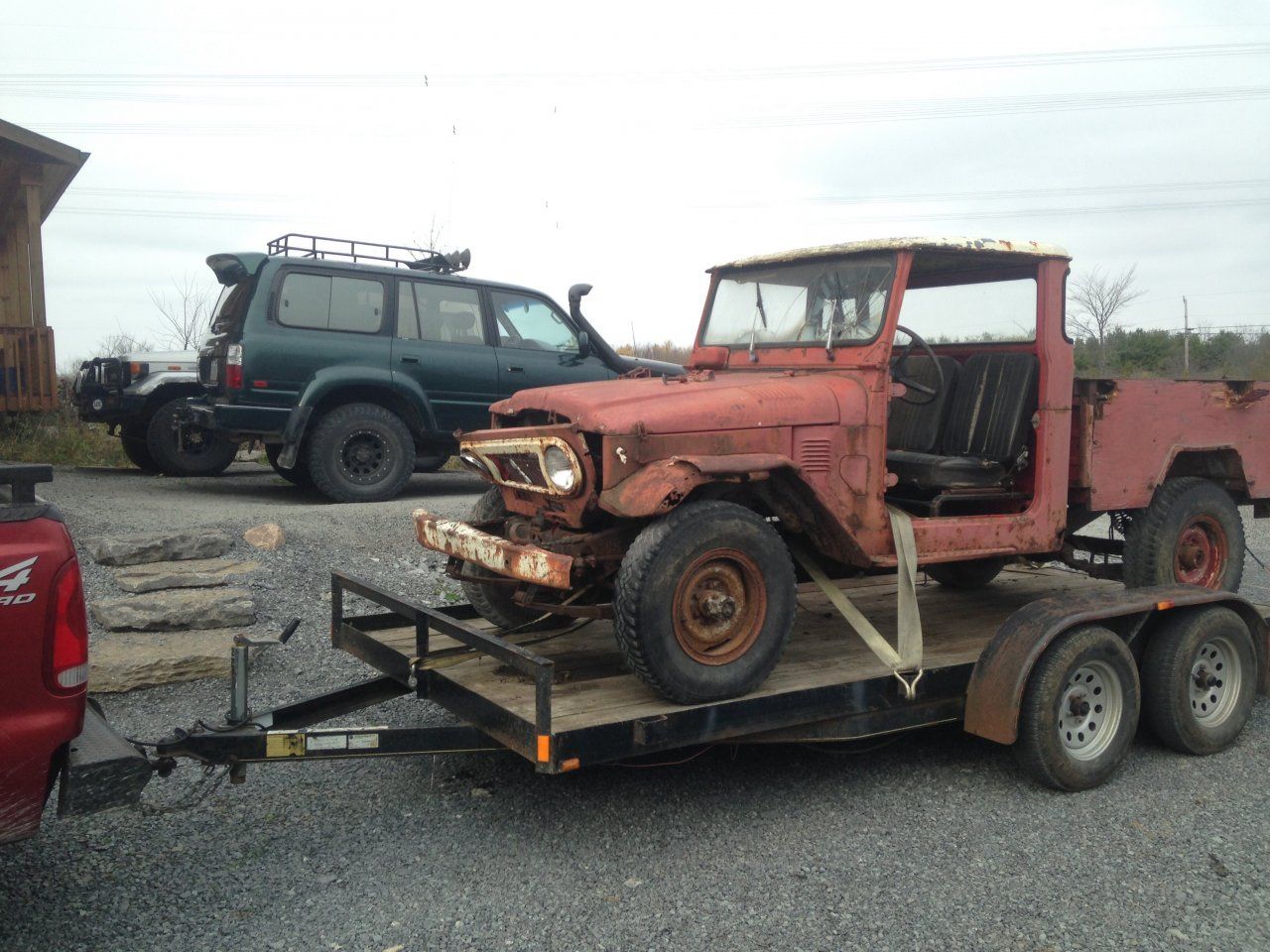

Time to add another to the list! Dragged this home about a month ago, minus drivetrain so I guess I'll have to swap that extra 3B/H55 into it... When I'm finished my 40!
Might need a few parts....

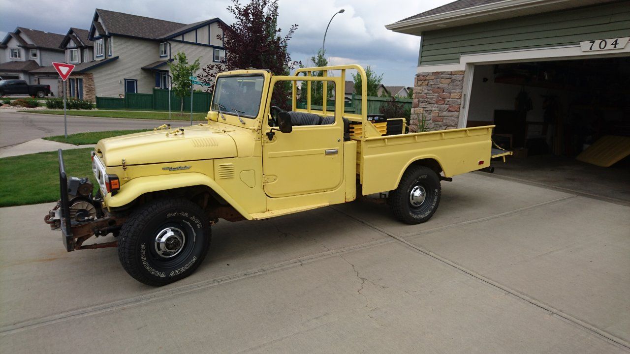

Well here's my 77....2 different sets of wheels...needs a lift badly...
Looks to be in decent shape. Are you going to name it " the minion" :D ? My springs were not quite that flat but I took them all apart and cleaned the rust off them and re arched them my self. Quite labour intensive and dusty job but rides better now. 2F engine? What part of the county are you in?
Hey, yes it's in pretty good shape, needs work on the cab corners and door bottoms. Has 2F with 75000 miles. Runs like a top. Right in Sherwood Park...the minion just might work....my girls would love that... Have been considering doing a SOA over the winter but an OME would be so much easier...
Seriously....I might have to Pm you in the near future. Or is it on tour build thread?
We did it two years ago, had everything ready and did it. That was just the actual SOA, I needed extended brake lines and I re did my steering to Trail Gear high steer, and I had anough of a hoard of drive shafts that I didn't need to have them cut. Brake lines I got from Dan at 4wheel auto. Very doable in a day, plus I think personally it looks better than a SUA lift. My truck came with Old Man Emu on it and I ended up taking 3 leaves out of the back just to get some spring movement.
