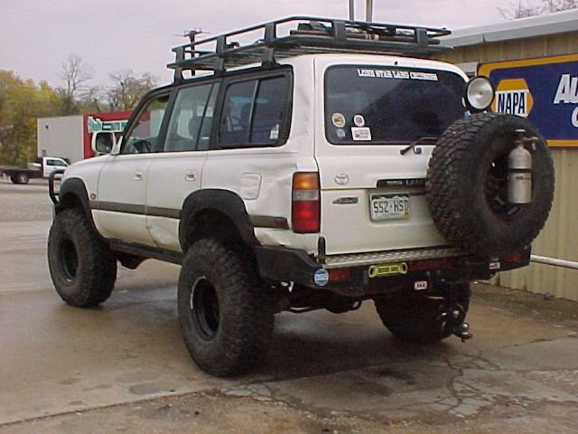

Stripper Pole Mount
Hey, that guy's running the same CO2 mount that I am.. :D

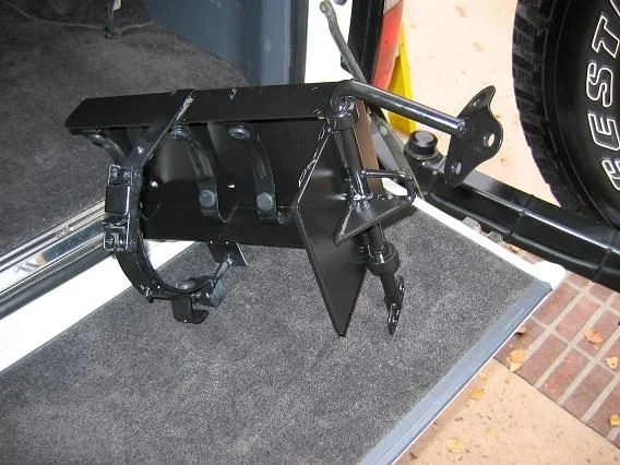

Here's my solution to a CO2 mount. Credit for the idea goes to Chris Geiger and Beowolf with a little innovation I'll credit to the welder I had do the work.
The CO2 bracket that most of us have is a fairly standard fire extinguisher bracket.
I used a 7"(w)x8"(d)x1/4"(h) piece of steel that's welded between the two circular knobs found on the 3rd row seat bracket. The knobs sit 7" apart, thus the 7" width. The bottom of the plate is futher supported with a triangular piece that's welded in on the bottom of the plate and to the seat bracket. I chose to have the CO2 tank bracket welded to the steel plate as opposed to just bolting it on. Bolts would add some versitility to the bracket as an option. The entire welding job and piece of steel ran me all of $20. I cleaned up the piece with some acetone I have. You could use paint thinner or other solvent to remove residue left by the welds. Your paint will adhere better if you spend just a couple of minutes cleaning the bracket before painting. I did rattle can primer before rattle canning the gloss black to match the OEM bracket and CO2 tank bracket. Total paint cost $10 for a total project cost of a whooping $30!. It's extremely sturdy.
Here are some pics of the bracket:
One more pic of the bracket showing the triangular support piece and one of it installed in position without the CO2 tank. Yes - those are 12V outlets to the left of the tank bracket - one switched and one unswitched.
Here are a few of the bracket with the CO2 tank from The Source installed. I've subsequently rotated the tank so the regulator faces the rear of the truck and with the supplied air hose, I can reach all four tires thru the rear without taking the tank out. You could also route the air hose out the passenger doors or rear sliding windows.
I've been very happ with it. No rattles, nothing. It's solid.

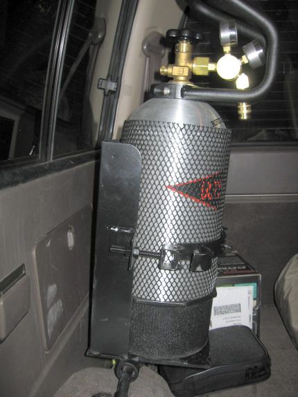

These are great guys thanks. I am going to install theone Brentbba showed up above. I just bought the seat bracket from a wrecked rig part out. I will have to order the CO2 bracket/holder and then have my friend weld up the same setup.
hmmmm, I have a 10lb Outback air setup in the 40 I move back and forth. Keep using that or get a new one with a 15lb tank?? Brents looks like a 10lb, so the 15lb tank would probably be too tall. Leaning towards using my existing air setup and using the new bracket in the Lexus for swapping.
I know the pic below is an FJ40, but its the system I would be swapping between that and the bracket Brent and B came up with.

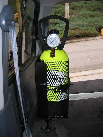

I copied exactly the setup above that Brentbba posted that he gave credit to Chris Geiger and Beowolf . I even used these posts as the instructions to the guy who made it for me.
The ultimate tank had the tank bracket. I bought an extra seat bracket for $15 and that way I can swap them in about 10 minutes if i need a people hauler. My friend welded it together for $20 including materials.
I really like this set-up
