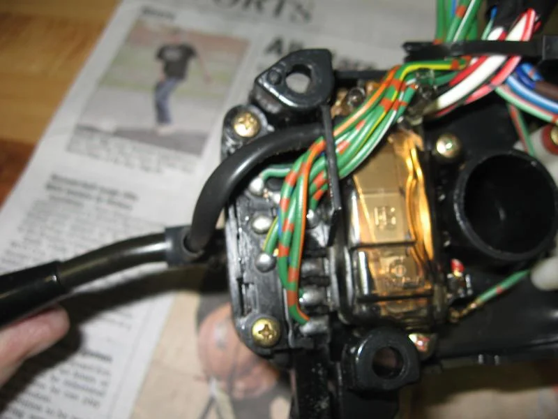

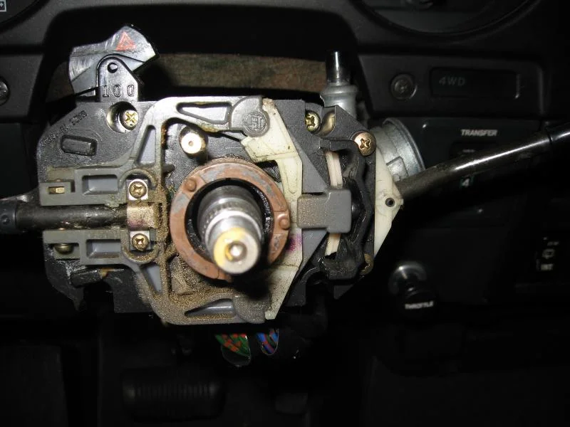

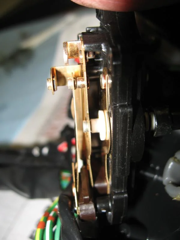

Yesterday' Winter Project: High Beam Switch Repair
My high beams have not worked for a while and found a solution on the 60's board: take steering column apart, sand contacts on high beam switch. Worked great and saved over $300!

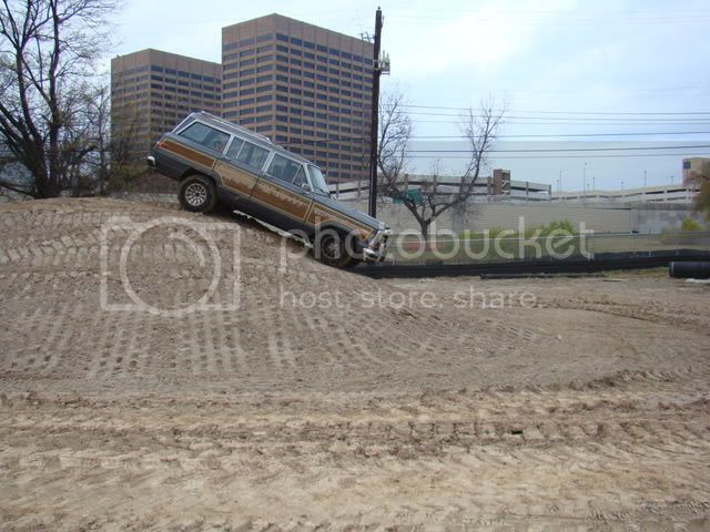

Two weekends ago we took Cat's Grand Wagoneer out on the trails and her alternator crapped out. The Napa battery actually held up pretty well for a few hours on the trail and (perfect timing) died right as we got back to the little nearby town. So we did a quick swap in the Advanced Auto parking lot in Jasper, TN...good times.
And we continued to work on her Grand Wagoneer this weekend (borrowed shop space at ACC). I just replaced the steering gear box, high pressure PS line and a lower steering column bearing...more good times ;)
Have I missed seeing pics of Cat's Wagoneer? If not, can we see some?
I thought there were some floating around in another thread but here ya go:
new lift kit:
right after the 4" lift install and new wheels/tires (BFG M/T 33" x 10.5", thanks to UC annual raffle 2007)
had to do some fender trimming in the rear to make em fit.
old tires...new tires...
checking out the old tcase with the old wheels/tires still on.
We swapped the NP229 for a NP208 tcase for better ratios and stronger case a couple months ago. Split the new donor case and replaced all the bearings and seals, then buttoned her back up and bolted right in place. Had the tranny rebuilt while we did that and all is well with the drive train except the engine at this point. Needs lots of love right now.
