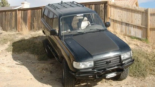

With "Line-X" are you talking about the bedliner stuff as the blackout pattern? If so keep in mind that that stuff looks great then it gets dirty the first time and is damn near impossible to get it back to the original clean again.
FWIW mine is rattle can semi-gloss black on a gloss black rig. I have a 1/4" wide generic gloss black pinstripe around the perimiter to cover up my horrible tape job from spraying. I can get some pics tomorrow when the sun is up.

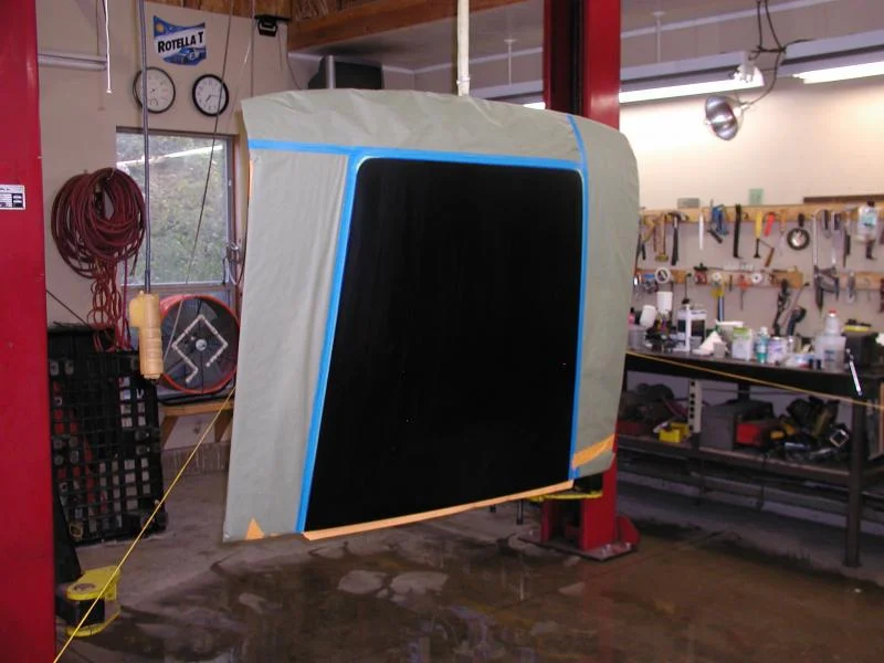

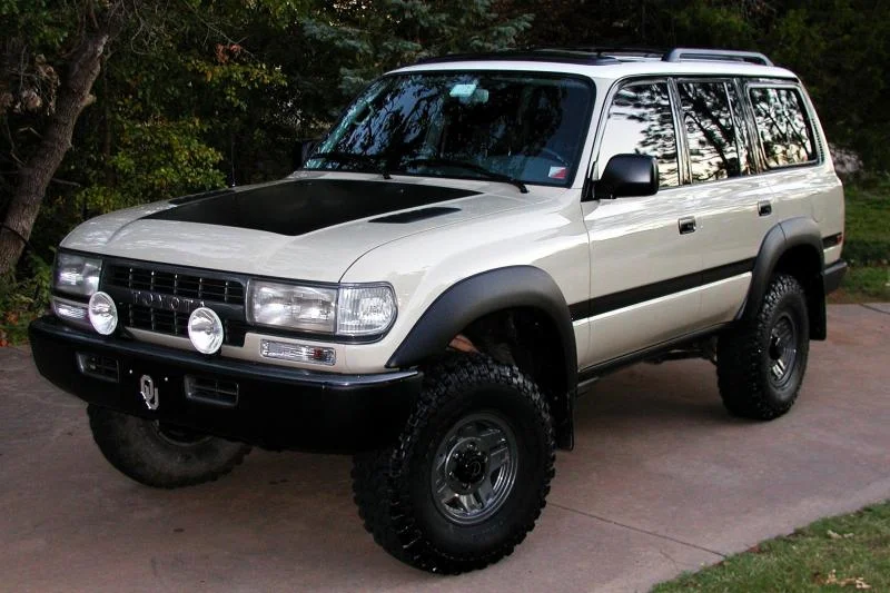

I taped with a 1/4" 3m vinyl tape to make the curves and a fine line. Taped and papered the rest, sanded with 400 then shot it hanging up vertically with black base/flat clear. Here's the result.

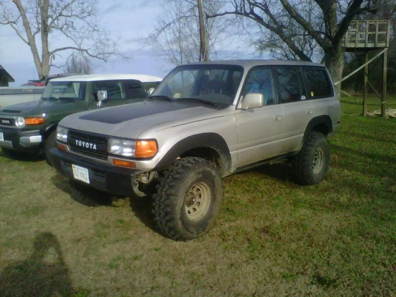

Anyway here's my pic:

Except for that OU crap, that is a truly fine looking Cruiser. The first one in years that really made me stop and appreciate it. Good job.
