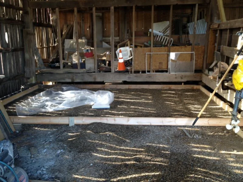

Set up to pour first section. Will not include current 'piers'. Leveled with stone, vapor barrier and then steel mesh. Will be doing a 5 inch thick slab
If course, may be two weeks before I can pour thanks to my work schedule.....
The barn wood in your pic looks really authentic and cool. I would love to have a structure like this to work in---almost makes me say use brick--or even better-flagstone.
