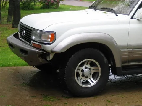

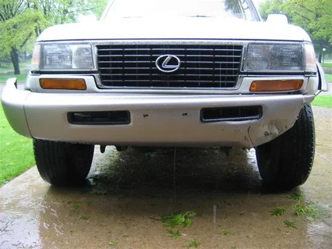

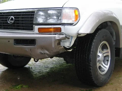

Now as I look towards repairing my LX450, I'd like some advice on what I should specify the shop to check out. I'm particularly concerned about the steering wheel being 180* off. I'd like some of you 80 series experts to post up what should be checked out in the front end and steering after an accident like this. I will pass this onto the shop that I choose to do the work.
Here's some pictures of the damage to my vehicle:

I drove it home, since it was only about 1 mile. It drove straight with a very slight vibration, likely caused by the front left tire being slightly toed out now. I glanced at the front frame rails and they appear to be straight to the eye. The brackets between the frame and the bumper are skewed toward the passenger side a fair bit. I'm secretly hoping I can put on an ARB instead of an oem bumper...
Suggestions for possible hidden damage to look out for???

Make sure they check the frame for proper alignment and also make sure they throw a wheel alignment in.
I would take a real good look at all seams and have the AV Dryer checked out. Its on the driver side right behind the bumper. A good body shop will know what to look for.

Shouldn't be a challenge for a competent repair shop. Obviously your steering arm's bent or tie rod but they'd know that in a few seconds.

I just went through a similar experience with my LC. Wife nailed a BMW pretty hard - but no airbags deployed. Adjuster and body shop assumed all that was needed was an alignment. They were wrong. Turned out the frame needed a little straightening and the pitman arm and steering box had to be replaced.
I ended up with a rebuilt steering box which I'm a little disappointed with. The thing doesn't seem to have enough power assist. I'd push for a new steering box if required, but there's about a $2000 difference between new and rebuilt so you might have a tough sell with the insurance company.

Remove the front bumper and take look the AC drier, the bracket and both small aluminum pipes goes onto it.Hope no leak, otherwise you may need to empty the system and vacuum it and recharge the AC freon R134 about 2 or 3 small cans/ bottles.

Pay close attention to the steering box. It is possible that the sector shaft is twisted. The other damage is superficial and as Romer observed a bumper such as an ARB would have survived much better and likely stopped the other vehicle before it got into your steering. If there is an issue with the box I would demand a NEW box or have the original box repaired with FACTORY PARTS. You can get an ARB bumper for about the same ammout of money as replacing the original bumper.

looks similar to my encounter last fall. I had an arb, and it got trashed, along with the winch. Mine requred the frame to be straightened a little just where the arb bolted on, new headlight skirt, new hood hinges, alignment, new arb, new winch, and a new steering stablizer. Be sure to check the steering stabilizer, mine was leaking after the collision. My steering wheel was cocked about 45 degrees when rolling straight, so not as bad as yours.

Make sure they check the sector shaft, pitman arm and relay rod on the steering. all can contribute to what you are seeing.
