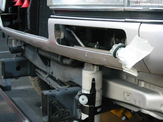

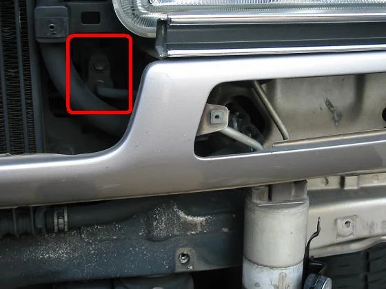

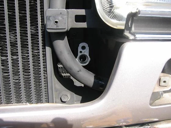

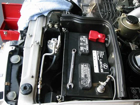

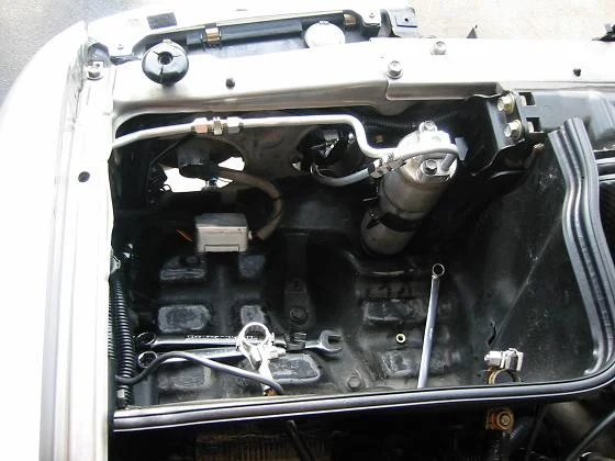

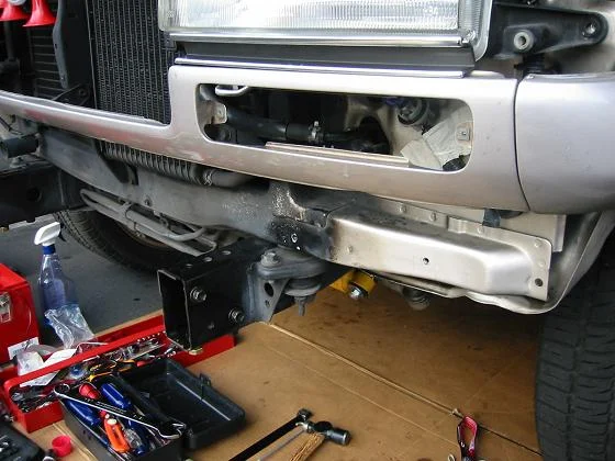

Not that lift...:flipoff2: Installed it today and first of all I want to say, im sorry to you Bill ( Photoman ) not that I didn't want to tell you where do I get the kit from, but at least I have to make sure the new AC dryer kit fit perfectly and work well. Actually the AC dryer kit I bought it thru online recently.Its JDM kit and took about 1 weeks to ship it to U.S.
The 134 took about 2 1/4 to recharge it and had a thermometer on it today and blowing really cold about 40 F at idle
:grinpimp:

LX - Can you post up the Toyota part#'s that were on the parts packages? That would make it easy for others to check with CDan to see if he can get these.
Looks great!
Nicely done LX. How long did that take you, and how many busted knuckles did you get? :)
again, thanks for sharing.
nice work!
Thanks for posting the pics and the write up
