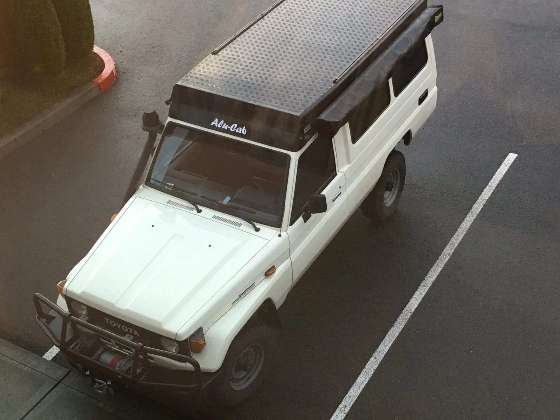

Been a while but the troopy is coming along.
I picked up the truck from Josh Harper at Willamette Blvd Auto last night and the following is now complete.

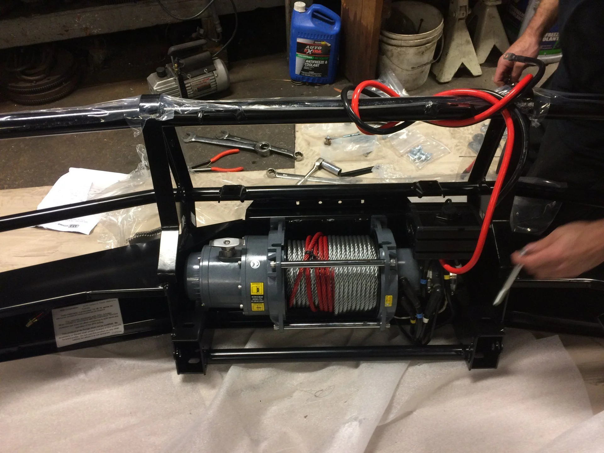

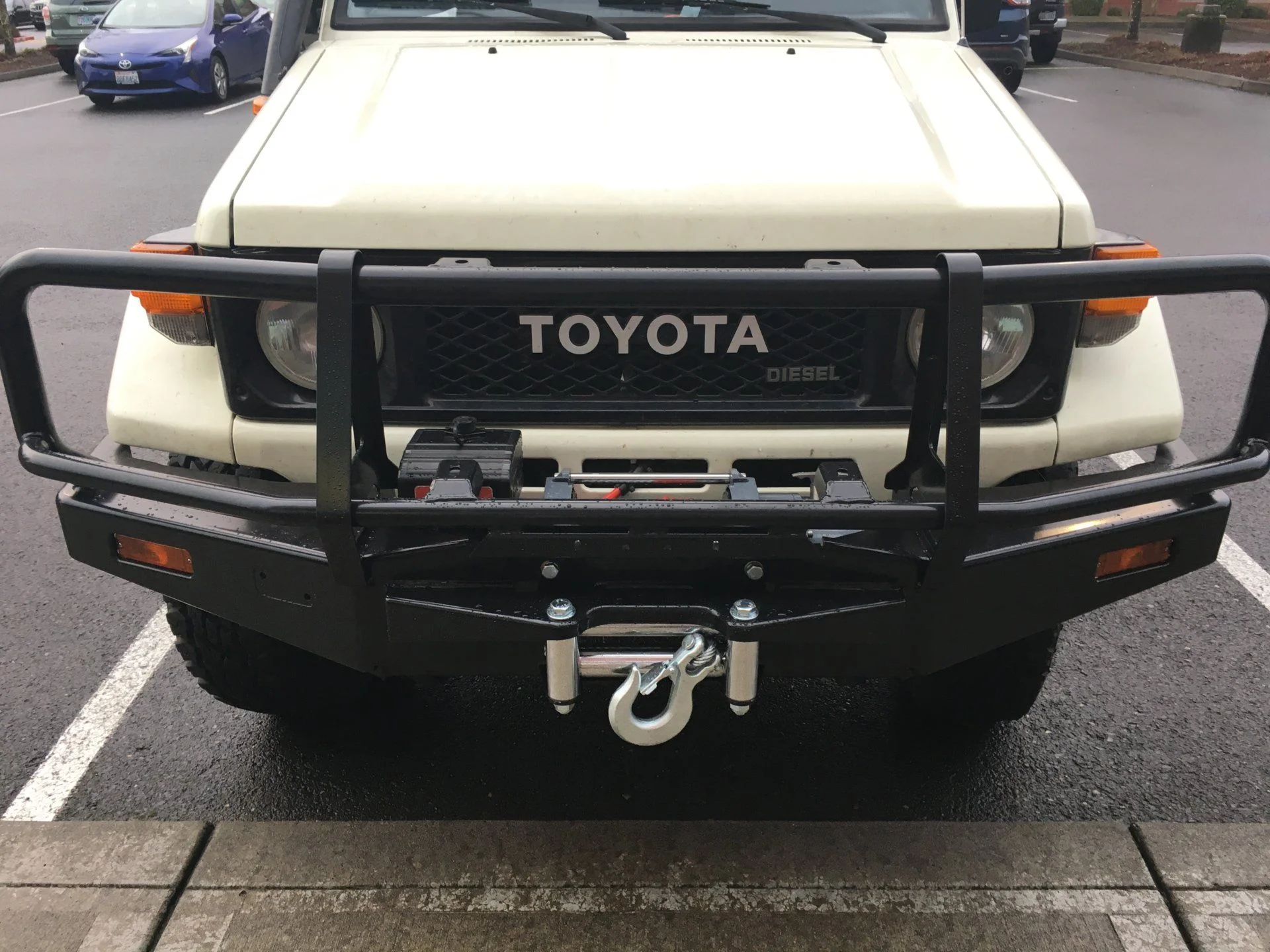

12k lb Come Up Winch
ARB Front Bumper

I drove the truck 15 miles or so today to WORK and the seats are going to be super nice. A "huge" improvement over stock.
