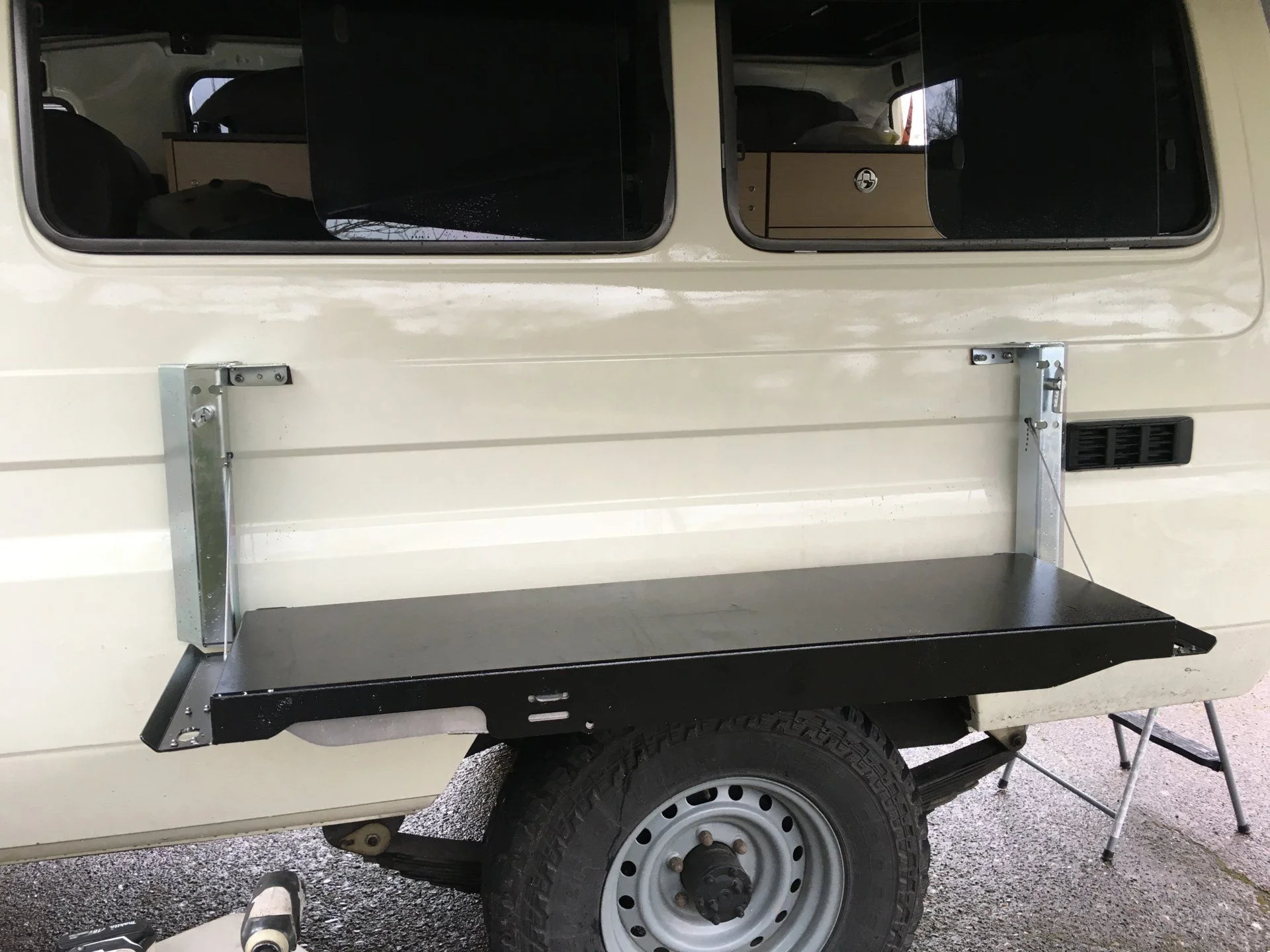

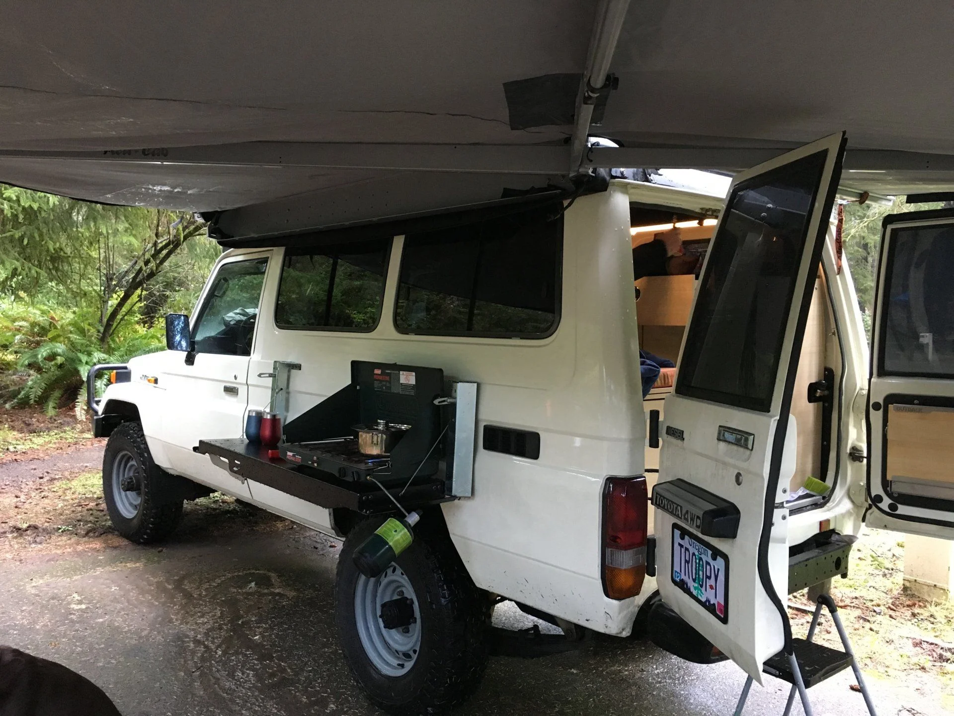

With my neighbors help, we were able to install the Quick Pitch max traxx table. The table was purchased from Nick at Backwoods Overland BACKWOODS OVERLAND – Your Expedition and Overland Adventure Outfitter. Good guy and I like doing business with him.
The table would have been "much" easier to install if it had been done before the inside build. As it is/was, we needed to drill through the birch liner behind the cabinets. The biggest obstacle was making the 6" long bolts that were required. Having written this though the table is really nice. It's sturdy, super easy to set up and take down and provides more space than I'd imagined. In lieu of mounting the maxtrax my thought is to maybe mount the stove underneath. Figure I'll use the stove a LOT more often than the maxtrax which could go on the roof.
Next up is the En-suite shower stall from Quick Pitch and the rear bumper from Kurt Williams.
I've posted a few random shots from this weekend. We drove to Ft. Stevens State Park and camped there Saturday night. Woke up to an Elk herd. Sunday we drove to Oysterville north of Long Beach, WA for a razor clam dig. Dug a bunch of clams, bought some oysters and drank a few beers. It was cold this weekend and it was very nice to be able to hang out in the troopy with the Espar heater.
My neighbor took the moonlight Troopy shot which I thought turned out really well. I'm liking the truck........

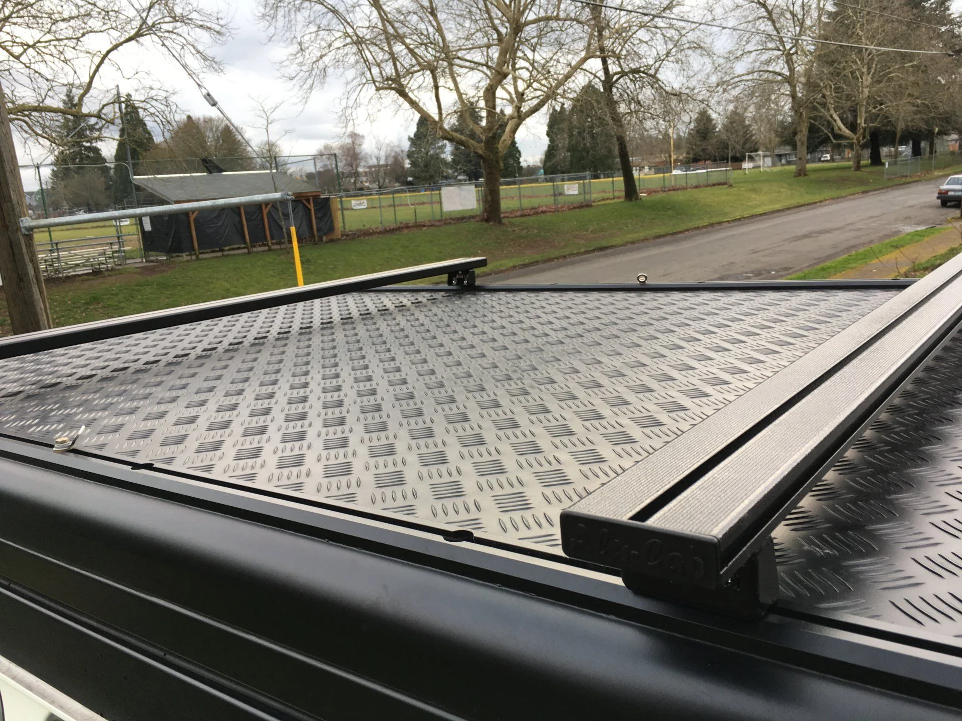

First, I installed the AluCab roof rack. I may end up ordering another cross brace or two. The rack is quite sturdy and isn't going anywhere. My thought is to mount a couple of Alu boxes for parts and maybe out of season clothes. I can imagine that if things get heavy up there that I'd need to replace the air struts with heavier ones. On and on it goes.

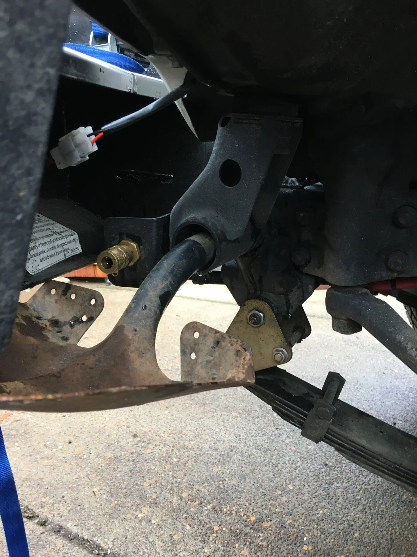

Next up I borrowed a shovel mount idea from fellow Troopy owner Andy. There is a "pipe" in the front of the Troopy that's spot on perfect for holding a full size shovel. Maybe someone can tell me why the pipe is there but maybe it was meant for a shovel??
I drove last weekend without any sort of attachment and after 100 miles or so it came out about 6". To solve that I drilled a hole at the top of the handle and put in a hitch pin. It won't go anywhere now. I will wait for the shovel to be stolen before installing a lock.

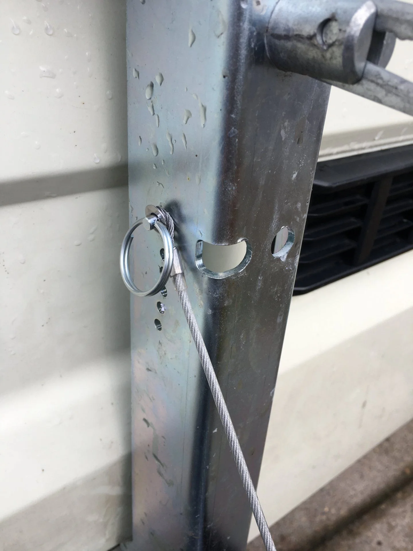

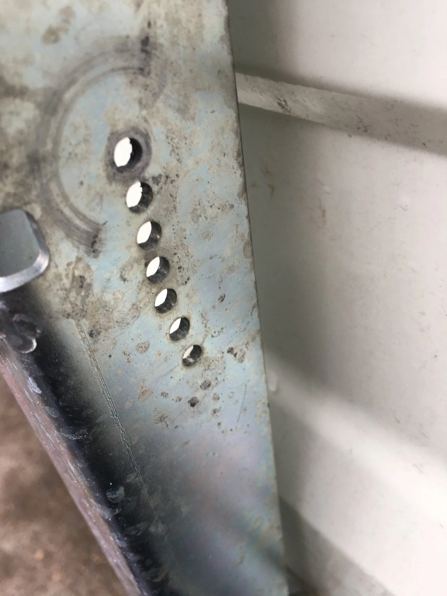

I've installed the Quick Pitch trax table from Nick at Backwoods Overland Quick Pitch Trax Table – BACKWOODS OVERLAND As mentioned previously, I really like this table. It's very simple to put up and take down and provides a LOT of kitchen workspace.
One thing that I noticed about the table is that it has adjustment holes for the table so that it can be leveled. Only thing is that it has/had a bolt and nut and you couldn't get the nut off to make the adjustment. Really not sure what they were thinking here and it's likely I missed it. To solve this I took out the bolt and nut which was quite difficult with the table already on the truck (first pic) and replaced it with a 3/16" push pin. Seems to work perfectly well and will allow for the table to be easily leveled when needed.

I'm trying to think of reasons this would be a bad idea... and I can't.
The only thing I'd say is that the metal-on-metal contact point of your shovel and ARB might make some banging noises and also cause some wear.
But now I'm thinking that if I don't put a shovel there I may convert it to a nice little air tank...
If you have a 70 series I think this is a great add.
To answer your question, it is a frame cross member designed to strengthen the frame and make it more ridged.
Does that rattle? Seems like it would something awful. Also no probs under max suspension compression and the tire?

I can't seem to get the quote message thing to work at the moment but I haven't noticed one bit of rattling from the shovel. Thanks for the explanation on the reason for the frame member. It just so happens that it's a perfect fit for the shovel. If the tire were to hit the shovel I think I'd have more to worry about than the shovel or tires. Given that I don't have super large tires there is a LOT of room left for wheel travel.
