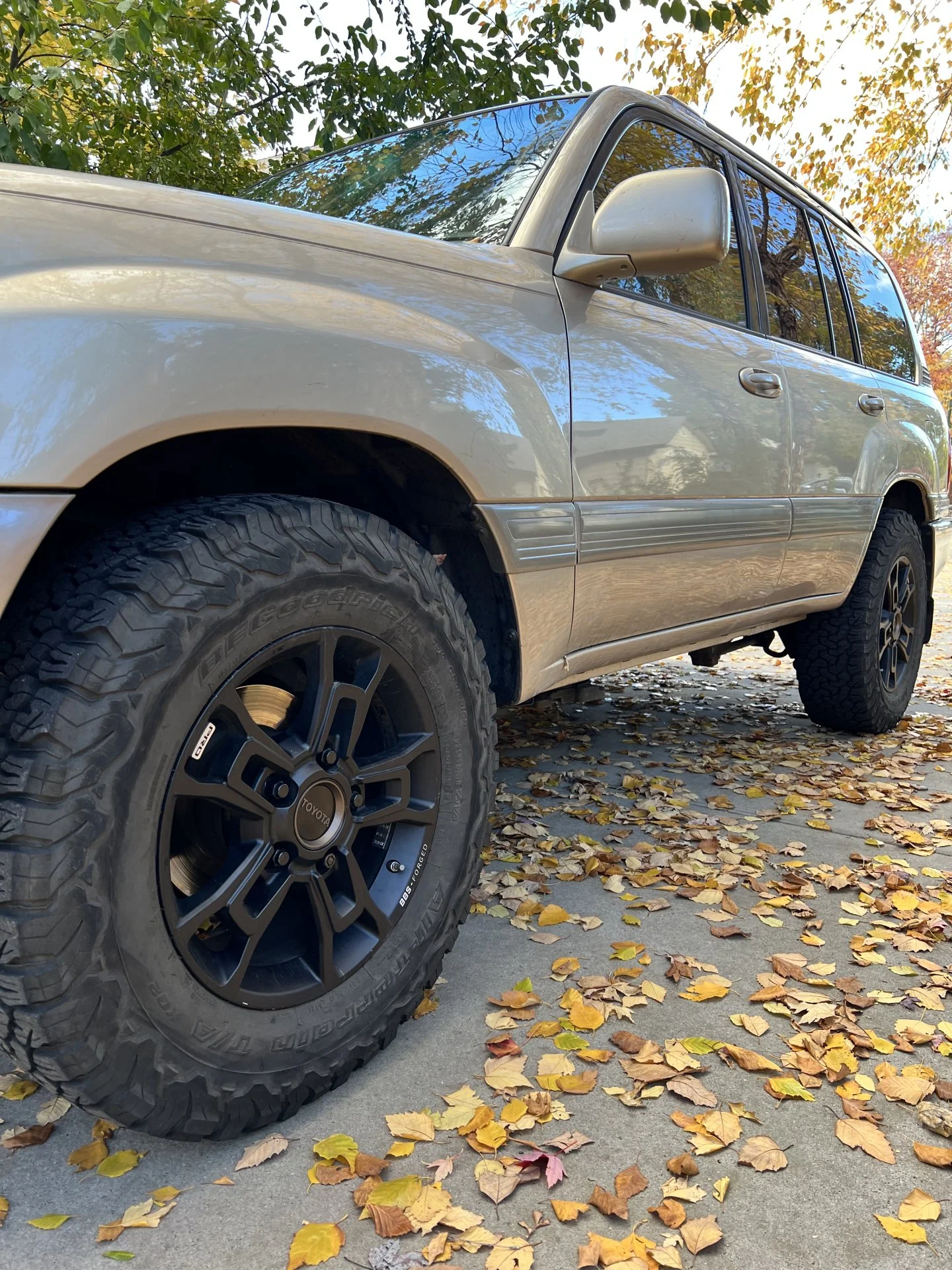

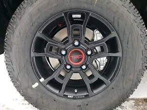

The ones I’m looking for are these:
That's just 2 months ago, may just be that not a lot of them are available as take-offs in addition to the 100 crowd using them.
Thank you again for that link! I think that is the older TRD Pro wheel and not the TRD BBS Pro wheel. I might have the naming convention wrong though, so apologies if I'm confusing things.

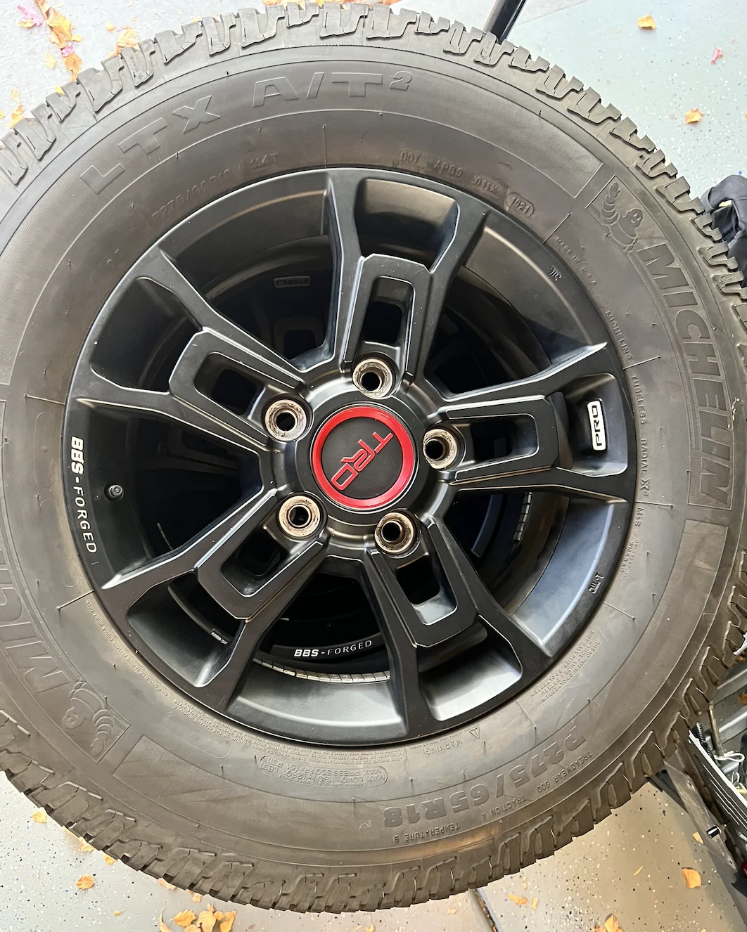

I got a good deal on a take off set (TRD Pro BBS Forged black) and just got them home today! I was severely let down to see that the front hub doesn't fit through the hole on these new wheels. Also even if they did, the end cap on the hub would stick out well past the center cap making it so that cap doesn't fit. Definitely would require some spacer work to make these happen.

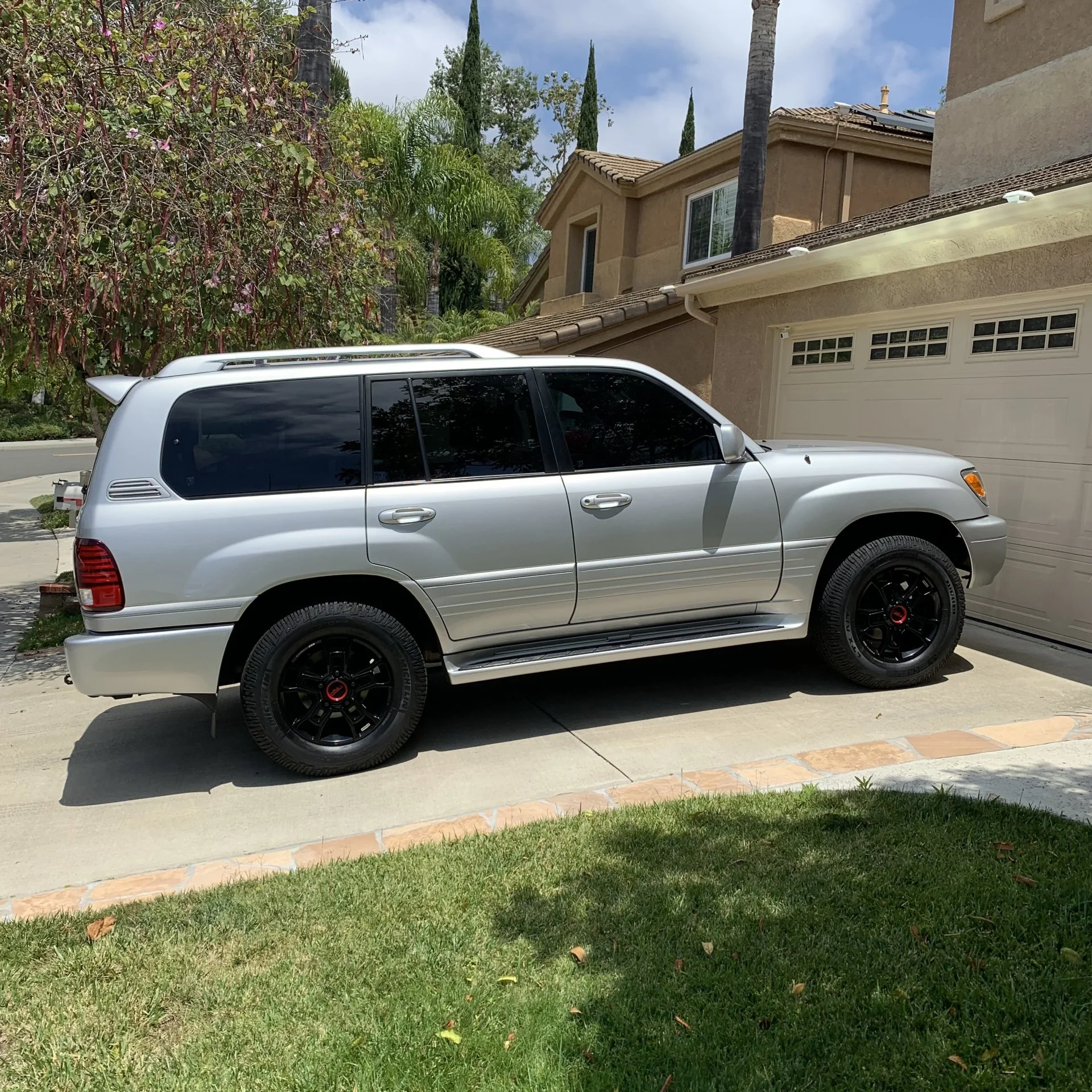

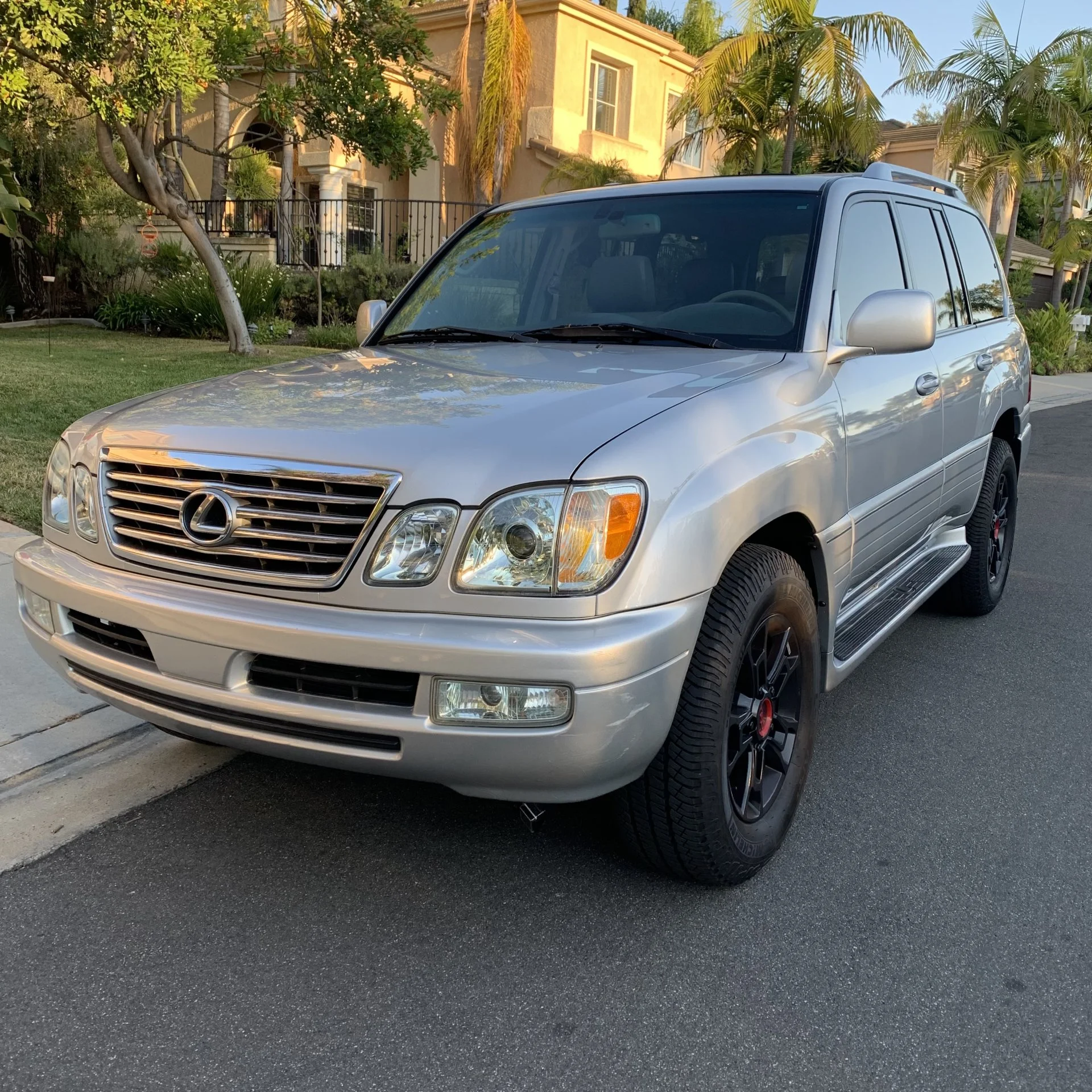

All the pics referenced are the TRD pro BBS Forged Wheel. The gray ones were powder coated. The wheel comes in shiny and matte black options with variations on if the BBS and Pro wording on the periphery are silver or filled in.
On my truck I have them in matte with 1.25” spacers in front. 1” rear.

The spacers are needed in the front for sure, the TRD BBS Forged wheels have a taper that doesn't fit over the front hub unfortunately.
