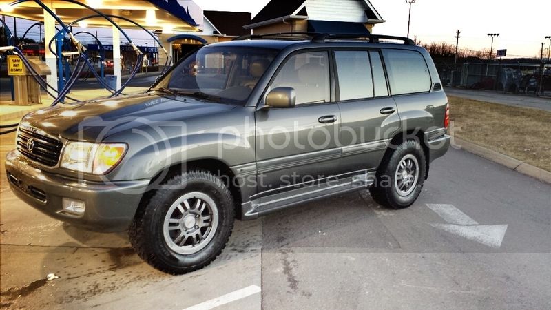

TRD Rock Warrios with 285's. I put Spidertrax 1.5" spacers on to get the centers to work.
Any rubbing with 285's on the RW wheels? I've seen some that did, but a few that didn't IIRC.
When the wheels were turned all the way but very little.
