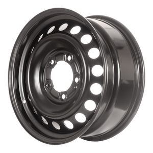

Has anyone ordered these? Seems much easier than hunting for OEM Steelies but also know Toyota quality is unmatched generally.
I tried to search but couldn’t find anything, sorry if this has been covered.
I picked mine up on Partsgeek. They're out of stock more than they aren't, but their price is nice. I've had them on two different trucks I wheel pretty hard with zero issues.
