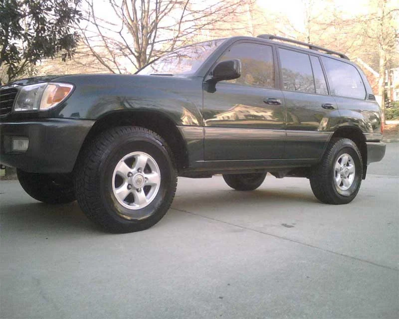

Picture of the 100 with new shoes and no running boards.. (1 Viewer)

she'll look better when i put a ARB on the front and a 2" lift!!

You did the T-bars too right? Looks great!
Especially the fresh armorall... :flipoff2:

it is a 98 with center and rear locker. I like the looks a whole lot better without the running boards. I dont know about the LC's with fender flares, but i am guessing it would be a lot harder to take them off clean.

yep, did the T-bars too....looks much better when the front doesnt droop. I think i am going to take this one to CMCC this year....

they are Toyo 285/75/15's Open Country A/T's
luve em
Noah,
I pretty much have the exact same cruiser and am thinking about changing to a 285 AT tire. I have not decided between the Toyo, Revo, or BFG AT KOs. My big concern is how performance is affected.
I see that you love them, but can you tell me about acceleration, braking, gas mileage, and road noise changes since you made your swap?
Thanks
Rob
