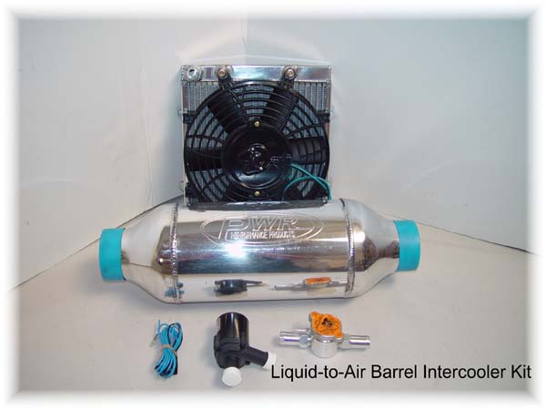

I am leaning towards a Liquid to Air IC for packaging and low speed reasons:
i suppose the liquid to air would be an excellent way of eliminating boost lag, although the cost is something to be cosidered.
