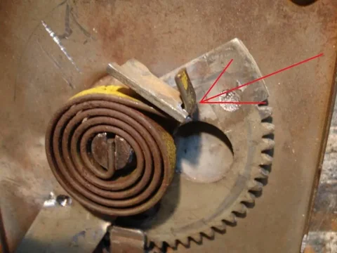

Below is the intact passenger crank gear set up next to the driver's side gear and lever that I removed from the damaged set up.
As you can see, they look alike but the gears on the driver's side are 180 out.
All you have to do is drill out these two welds and flip the lift bar around and weld it back together! I found the two welds to be pretty stubborn. I would recommend about a 5/16 bit to easily drill them out.
You can not take the bar off because the spring retainer is on top of the lift bar.
Once the welds are out, rotate the bar around 180 degrees and weld it in place.
Then use a grinder to cut a notch in the lever to retain the big spring that helps raise the window.
I cleaned it up with my Dremel and put the spring back in place.
Lube it up with a little grease and put it in place.
There ya go! a serviceable driver's side window crank and all it cost you was drilling two holes and a couple tack welds.

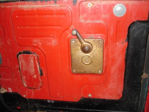

the cranks will interchange without any work but the crank will be lower.i know people that have switched them to keep from hitting their knees,nice writeup though snce i have a pile of those and this keeps the crank stock looking.
I was recently told that my window cranks were installed on the wrong sides. It puts the crank at the bottom of the plate, but works just fine. So, without too much monkey motion they'll bolt on either side with no modification at all. You'll just look like an idiot, but that's never stopped me.
