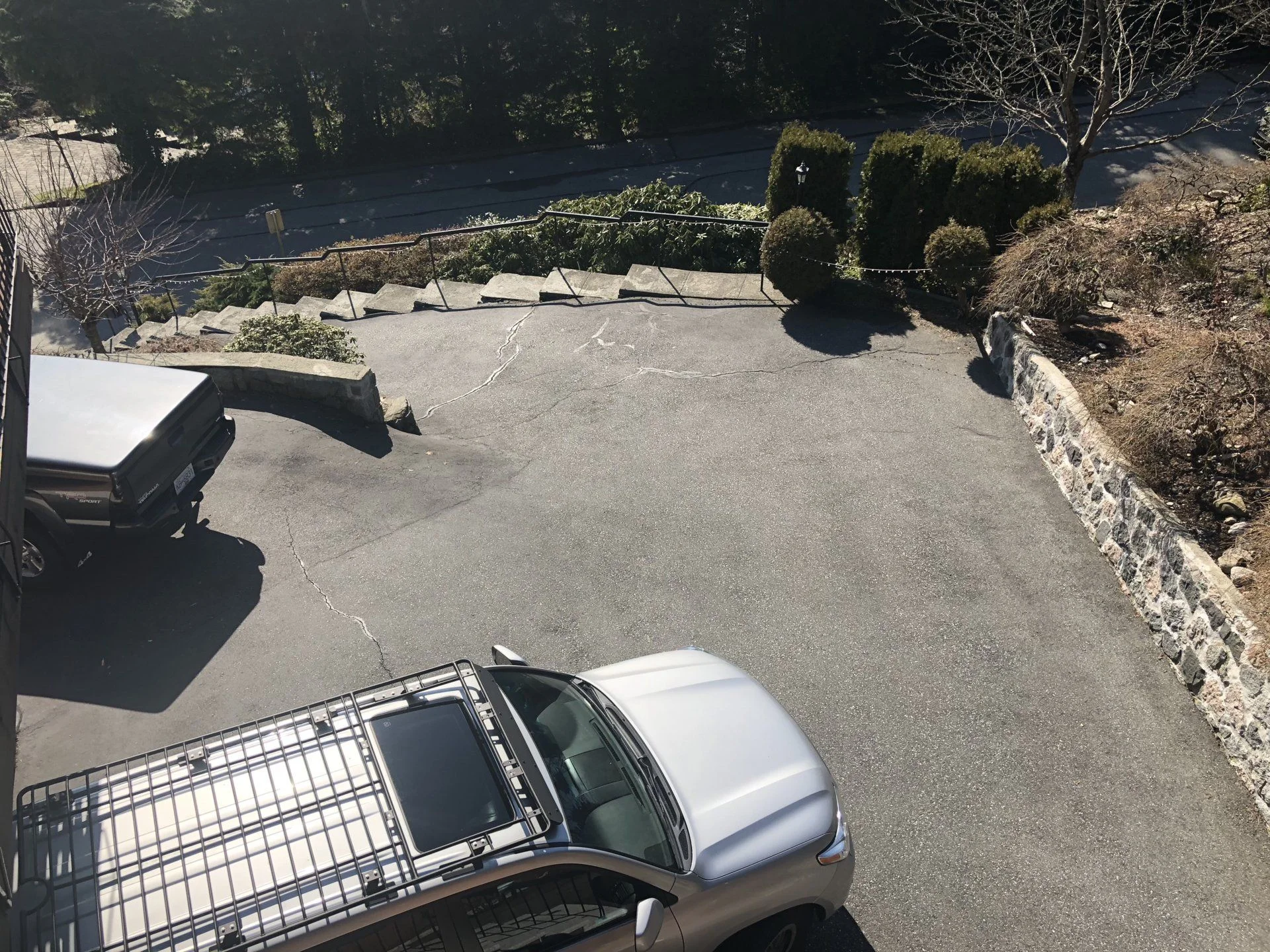

I have a 16 LC with 28k miles that I typically park on a declined slope in my driveway - probably 15-20 degrees or so. Last night on way home from dinner, I noticed the fuel level was on the low side. Gas light not on yet. Figured I would wait until the next day to get gas. I go out to start the vehicle this morning, it turns over, then it sputters and chokes, then cuts off. Try to start it again and same thing. Sounded like it was out of gas. Fuel light now on. I got my gas can with 1 gallon and put it in. Try to start again - still won’t run. Took my wife’s car up to the gas station and got another gallon to put in. After this, the vehicle started up fine and ran. Took it up to the gas station and filled it up, where it took only 17.9 gallons.
This means that since the vehicle holds 24 gallons, it needed a little over 5 gallons in the tank in order for me just to be able to start it on a declined 20 degree slope. This seems crazy to me.
So my question is - is this normal? I’ve never had this happen before, and I usually get gas right when the gas light comes on. Never had any issues with the vehicle before.
Park facing the opposite way (downhill/uphill) next time you are running low - problem solved!
HTH
Edit to add: A 20 degree slope is a 40% grade - that's very steep. With a wheelbase of 112" this means when parked facing uphill your front wheels will be almost 4 feet higher than your rear wheels. Yikes! :censor:
It’s definitely not that steep then. This is when I was facing downhill, so back tires are probably 2 feet higher than front.

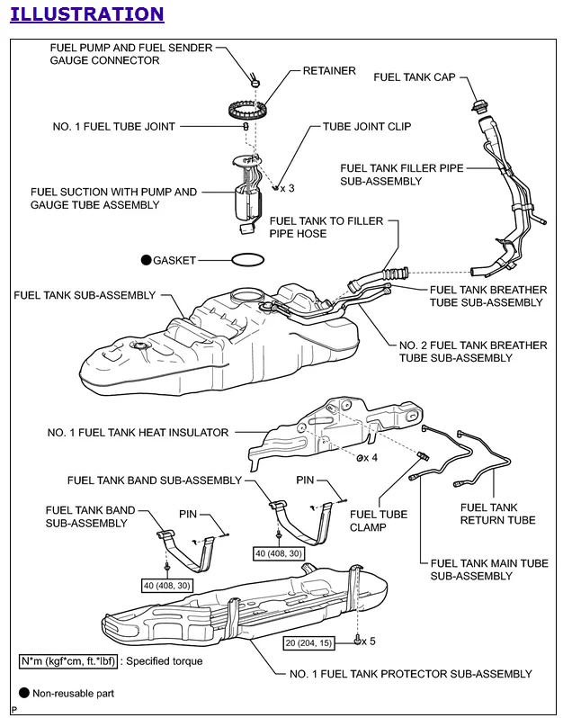

I haven't opened the tank on my LX570, but the float on an 80 is at the rear of the pump and pivots forward. This means that if you're parked head downhill, the float could be "out of the water", even with fuel in the tank. There's a good sized sump in there, to allow sediment to settle out. This was also the case with my 40; I always parked facing uphill when I was low on gas.
This makes it look like the float sits across the width, not parallel to the driveline. Ignore my earlier post.

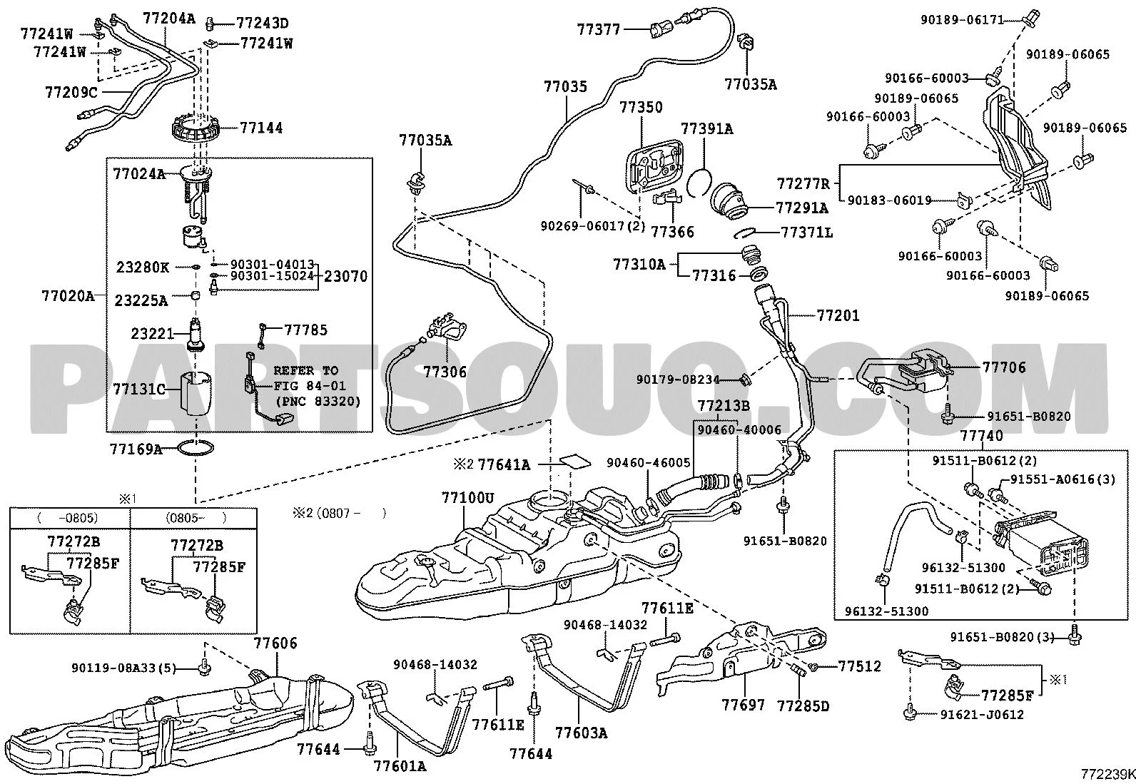

Take a look at this parts diagram which further breaks down the fuel pump/sub-tank assembly which @bloc refers to as the "bucket:"
The "bucket" is part# 77131C and the fuel pump is part# 23221.
So when the system is in operation, there would usually be enough fuel maintained in the "bucket" to handle extreme slopes when offroad; but when the system is shut off, the "bucket" may drain and result in the situation you describe.
