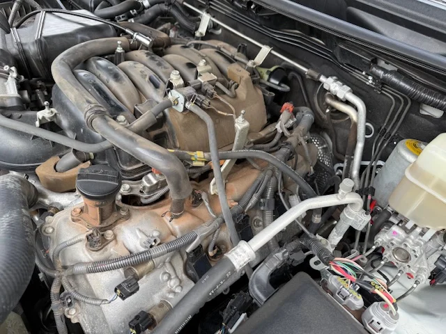

The day after having driven for hours in 100 degree heat, I noticed the level of coolant in my overflow tank was almost non-existent. It also looks like my radiator is about due to be replaced.
I have NOT found easily visible coolant leaks, having checked above the bell housing, around the water pump, and poking around the intake manifold.
Before I go tearing into the intake, is it worth filling the overflow tank and measuring the coolant loss? I'll do the repair if need be to avoid owning a 7,000 pound paper weight, but I'm not looking to do more work than necessary.

Unless it’s been years since you last checked the expansion tank coolant level, there is no need to do any tests, you have a leak somewhere. You’ll need to more carefully check for leaks externally and especially under the intake manifold. I suspect you’ll find the telltale pink crust there. Meanwhile, is the radiator coolant level ok?
I haven't popped the cap off of the radiator yet, but I'll check. I *think* I checked the coolant level when I bought the truck in October of 2024 and when I left for Cruise Moab last April, but I didn't know about this issue until the last couple of months, so I don't have a solid baseline. All I know for certain is the truck was happily cruising at a bit cooler than halfway on the temperature gauge in the 100 degree heat.

Could be the valley plate. Could be the water pump or a few other places that can leak. Top it off, watch it, and keep looking for the source of the leak.
What other locations should I watch? Thanks!
Heater hose T’s can start to leak but your mileage is pretty low for that.
I’ve seen someone who had a leak in the rear heater line. That uncommon though.

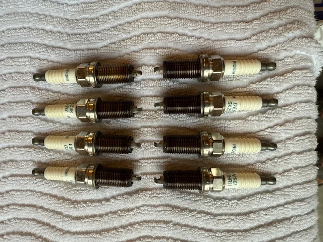

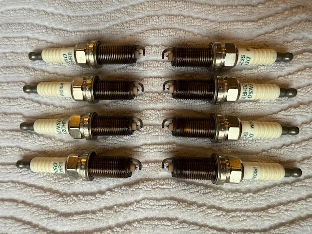

Yesterday, I changed the spark plugs to see if there were any signs of head gaskets going bad. The plugs are arranged with the top left cylinder eight and the bottom right cylinder one. Any thoughts?
I suspect they've been changed before since my truck was missing a fastener to some sort of breather tube on passenger side valve cover by the firewall, and a wiring harness clip on the driver's side was broken in about the place I would expect an a55hole rushing the job to do so, and a few hose clamps are... clamping nothing. At least they were factory plugs.

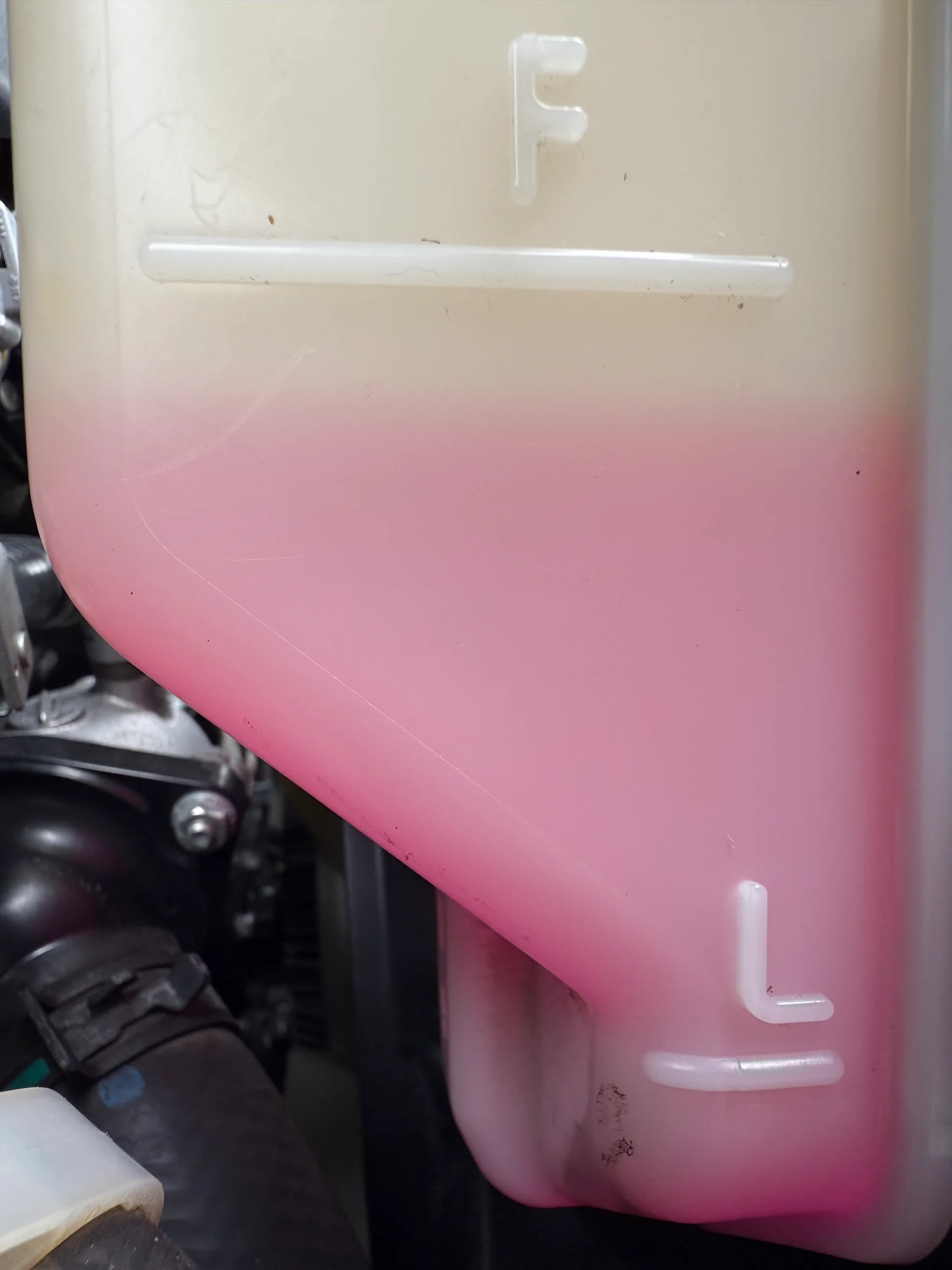

I filled the coolant reservoir to the "F" mark, but shot myself in the foot for diagnoses purposes since I spilled some coolant around the water pump. After hosing off the spill, I ran the truck in the driveway for about 10 minutes. I did not see any signs the water pump was leaking.
This morning, I peeked at the reservoir level, and saw it dropped a bit. I'll drive the truck today, and poke around again tomorrow.
If it was low you might need top it off a few times. Once it gets below L you can get some air in the system which can take a little time to burp out, so don’t freak out if it doesn’t stay at F.

My semi-professional opinion...
Spark plugs look 👍 good

My guess is valley leak too. If you have a borescope, you can snake it under the intake manifold next to the PCV valve. Any sign of pink crusties at the base of the head will be confirmation. To those that dont pop their hoods and check fluid levels at least weekly, please do start now. I think most of the head gasket issues we hear about with these engines relate to situation exactly like this.

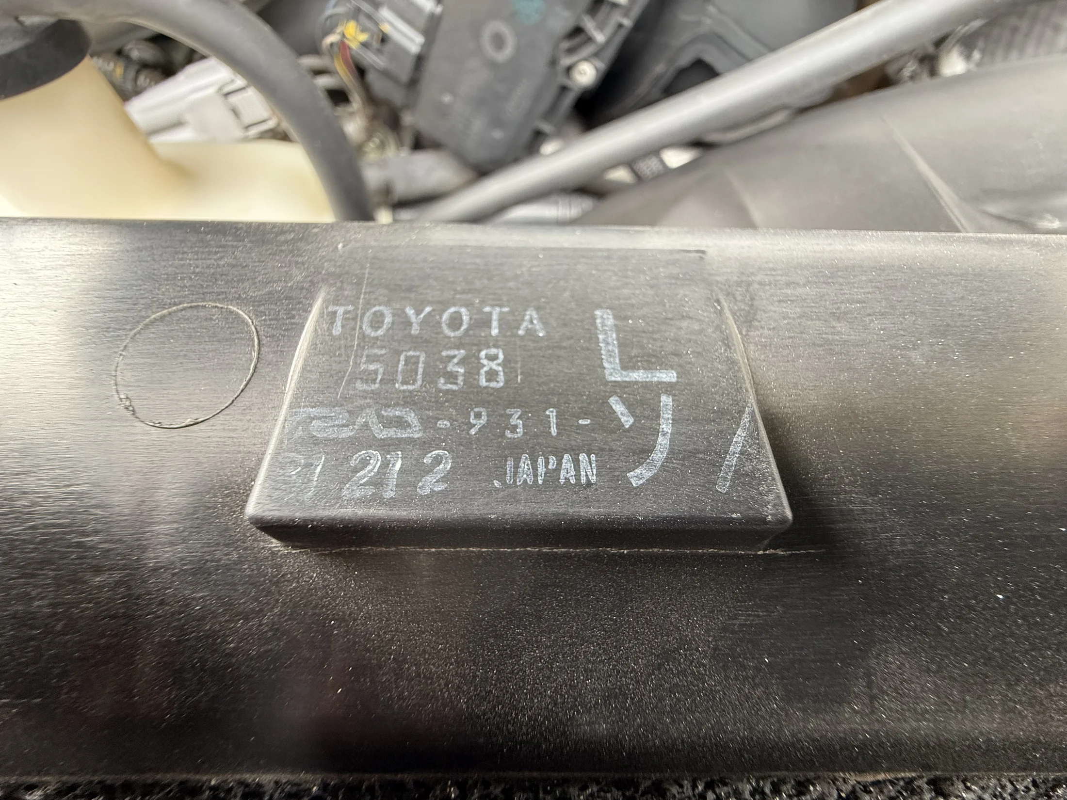

In your photo, it looks like a hairline crack is starting on your rad right in front of the raised square area with the part number, same place most of them (including mine) fail I assume. Maybe something to keep an eye on while waiting for the new one.

I checked the coolant overflow tank each morning with the engine cold this week. I topped off the tank to the "F" mark on Tuesday. The truck was driven about 25 miles each day.
On Thursday, I picked up the updated OEM radiator, new hoses, and a water pump, planning to swap them in this weekend.
On Thursday and Friday, I noticed the overflow tank had... overflowed. This was unexpected.
Today, I poked around everywhere I could with a camera, but could not find pink coolant anywhere except maybe on a white plastic tank that's between the back of the intake manifold and the firewall. I was not able to snake the camera in to see the passenger side of the valley plate.
