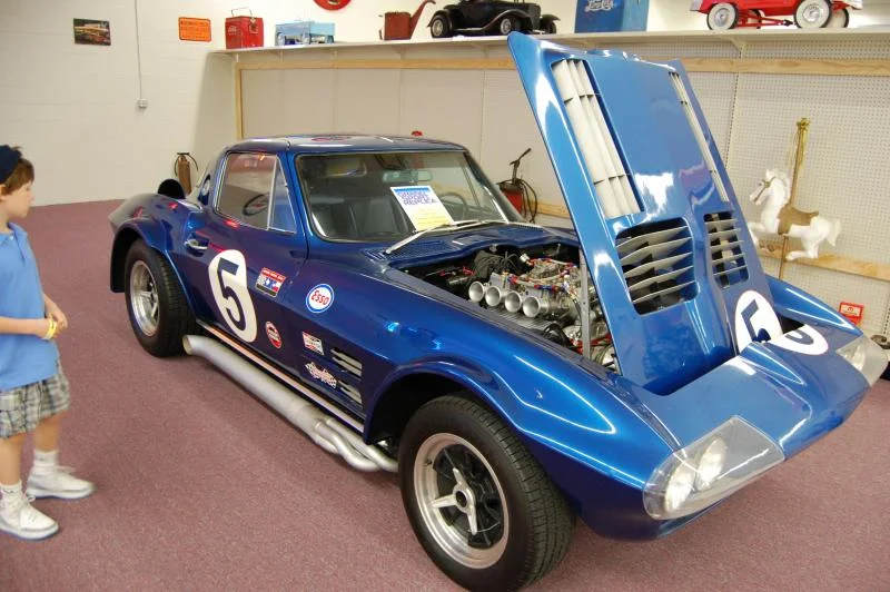

Heh, mine is just a replica, I'm sure your real Grand Sport is still safe in your garage.

No vents on this one, just a scoop and a generous opening to the radiator.;)

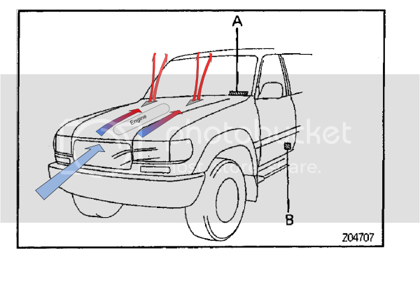

I like the idea of additional vents for cooling, but I was thinking about making them right on the back of hood near front windshield. Having them in the middle still allows the heat to stay back around last cylinder where head gaskets tends to fail. This is the place that very often gets hot when you park a truck. Having vents on the back of the hood should allow heat to escape. Only issue would be that while driving, heat would go out against windshield, heating truck inside.
Something like image below.
Good logic and nice drawing, but I went with Sumotoy's evaluation of the low pressure areas on the 80 hood (mentioned here IH8MUD Forums - View Single Post - ABC'S of 80's Cooling Part IV - Hood Vents, and documented somewhere else). His concerns with smell have not been an issue (my junk don't leak:D, yet), and I went with the Z34 vents as they were the largest, and being metal deal well with heat, which I've already noticed just dumps out of these vents. I don't share the safety concerns that some have voiced. I've had an 80 totaled on a front end collision, and do not think my vents have in anyway compromised the safety of myself or any passengers in the vehicle.
