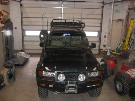

Not a new idea, I know.
Photoman did it, Sumotoy did it, murph did it, treeroot louvered it, and citadel did with one of the same vents (https://forum.ih8mud.com/80-series-tech/107593-hood-vent-installed.html).

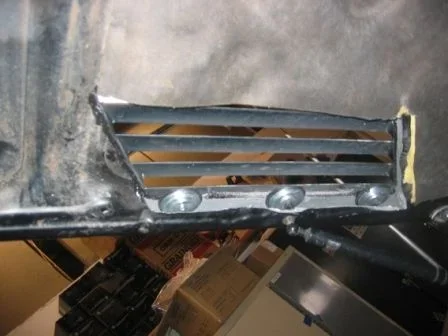

I got these Z34 Lumina vents off ebay to my door for <$35.
I sandblasted them and painted them to match my green machine.
Next I missed out on turkey hunting this morning and was up at 4am anyways, so I decided to cut holes in my hood.

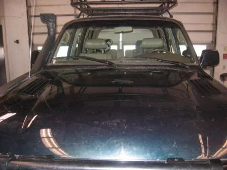

Then I dropped said vents in the holes.

drove around and parked outside while running errands for ~4 hours. Meanwhile it was raining, sleeting, and snowing heavily here. When she got back and I went to help with the groceries, I popped the hood to check it out. There were a couple drops of water on the PS from residual water dropping off the fins after she had parked. That was it.
