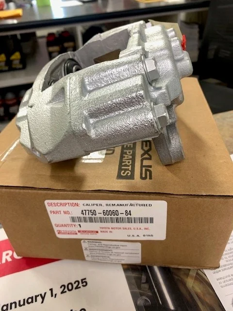

Unless the calipers are in such good condition that fresh paint is all they need, honestly I'd get the Toyota remans if you can instead of rebuilding them. It's a lot of work, pistons might be a pain to remove and in the process you'll likely find more parts you want or need to replace.
This was my recent rebuild with the cylinder kits 04479-60020 and 04479-60030, new flex lines, union bolts, bleeder plugs, slider pins and main caliper bolts

The remans are pretty much a bargain out of Ourisman in Richmond. If yours are original, it is pretty much a no brainer to place them. Hoses are condition dependent. Once you are that far in, bearings are on the list. Use a 54mm socket, not a farmer's chisel on the big nuts.

One on my smaller regrets was not painting the remans right out of the box. It is so much easier to keep painted calipers clean.
Adding that new OEM calipers do not come with new crush washers for the banjo bolts like parts store calipers do. I had trouble finding the appropriate sized crush washers and had to reuse my old ones after light sanding. Lesson: Buy new washers with the calipers
