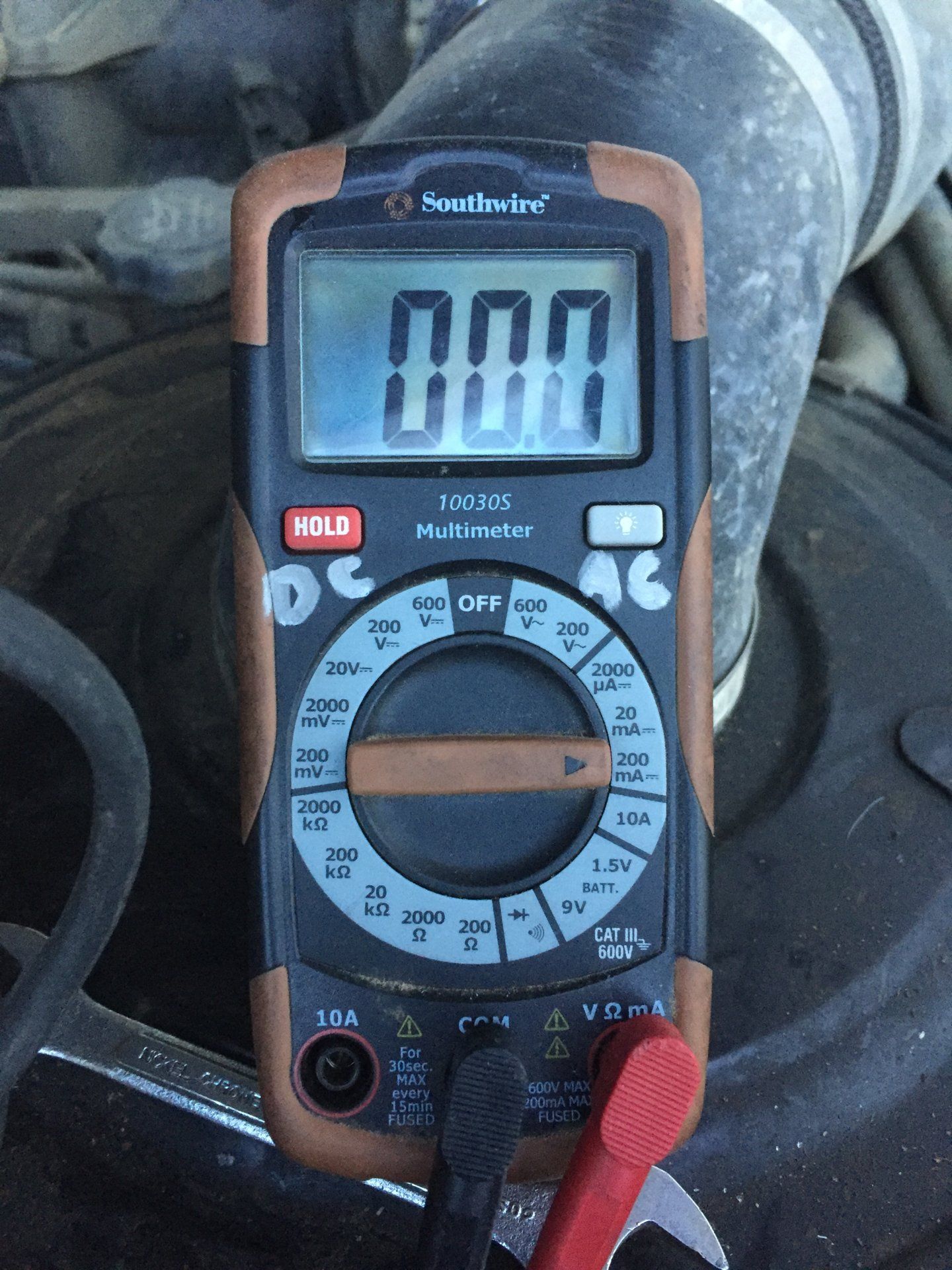

Trying to follow the recommendations in the thread. Bridge the positive terminal and the positive lead with the multimeter set to 10A to first test for an abnormally large draw.
I get -0.02 From what I understand, this is reasonable but not precise.
I then switch the red probe to the mA terminal, and test again with the multimeter set to one of the mA positions .....and promptly blow the fuse in my multimeter
What am I doing wrong? Would this work any better if I did my testing on the negative terminal ?
Well, if the fuse blows then it is momentarily drawing more than the fuse rating....
