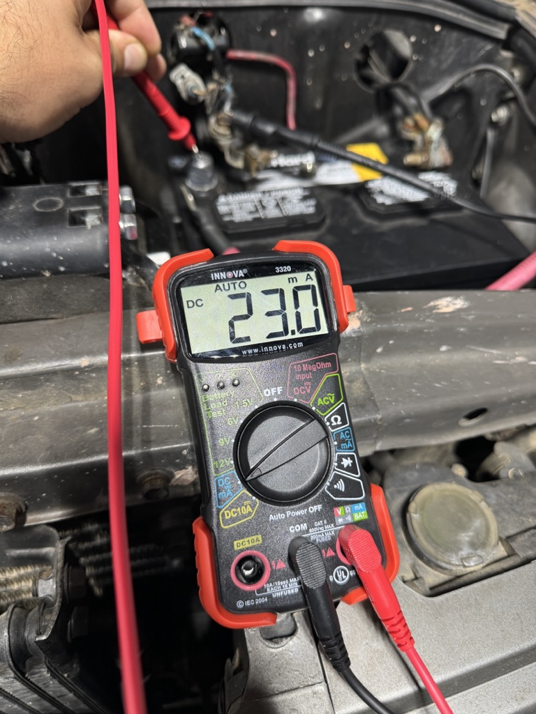

Update: New meter acquired and I'm now getting an accurate reading. Not sure what was wrong with the old meter, but even with a fresh fuse it wasn't able to give me a reading.
The difference could be that your previous meter did not have an automatic range selection like most quality meters now have.
So the draw is 23 milliamps? Is that correct?
That's what I see when I look at that picture. I'm assuming the negative lead is on the disconnected positive battery clamp.
Typical quiescent draw should be between 20-30 mA.
