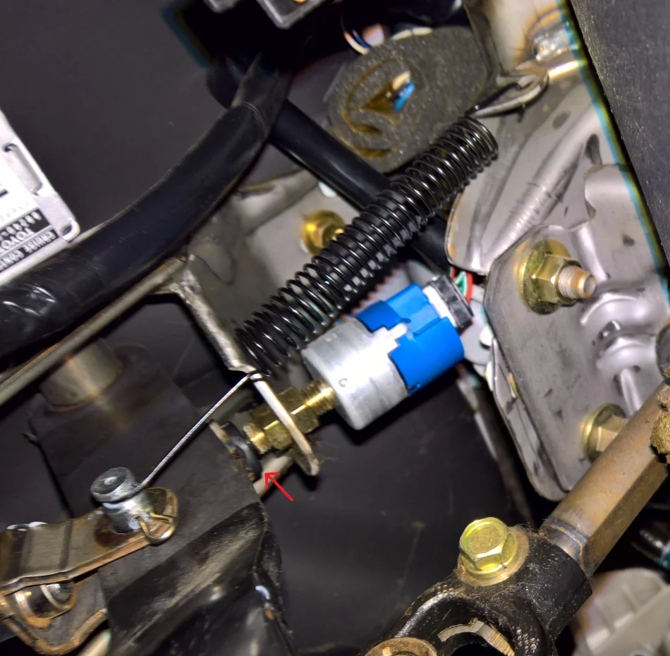

@thelal : maybe check also that the brake lights aren't on while the vehicle is parked??
There's a small round plastic cushion that the brake lamp switch presses on that can fracture and then fall out. When that happens the brake lights can come on while the vehicle is parked. Check also that the brake pedal return spring is still connected.
Red arrow pointing to black plastic brake switch cushion.
Immediately above that is the brake pedal return spring
(photo taken from the driver's foot-well looking upward, firewall to the left, steering shaft to the right)
Hadn't thought of that. Will check
