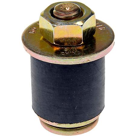

may be short term . I might Have to try the Slip-N-Fall freeze plug idea @Tools R Us has posted

Expanding freeze plugs FTW.........
I like the idea because it's meant to seal a hole. But a thought occured to me - it's meant to seal a hole in an engine block - solid steel or aluminum. And this application is the thinner metal of the air filter canister. There's a good chance of over torquing and deforming to where it would leak or even splitting and ruining the canister or at least the nipple that the old PAIR hose was on. I believe the rubber in the freeze plug is relatively hard and seals well on an engine block because the block is so much stronger than the rubber. But, not so for the air filter canister. I would include instructions to use care for this application. Something to think about.
I’m not going to sell them :P
But it’s a perfect sealing solution...until it’s not LOL.

I know this an old thread but I just did the PAIR delete on an 80s series (1994) and the size of the rubber expansion plug you need is a 1". Can be found on Amazon very quickly for anyone interested.
