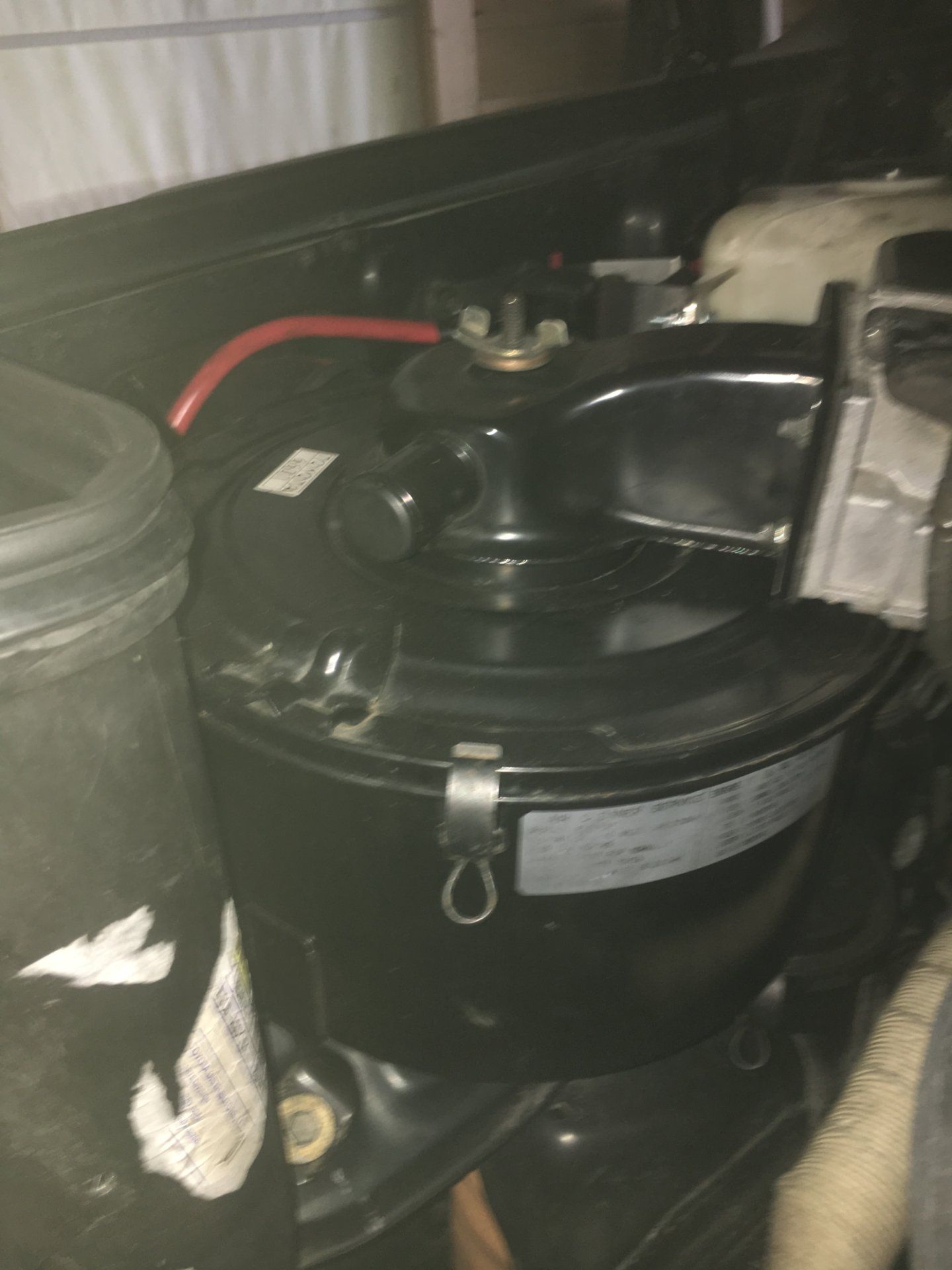

Does anyone have an elegant way to plug the PAIR vacuum line on the intake assembly?
The barb is 1-1/8" OD. Does anyone make a 1-1/8" rubber vacuum cap?

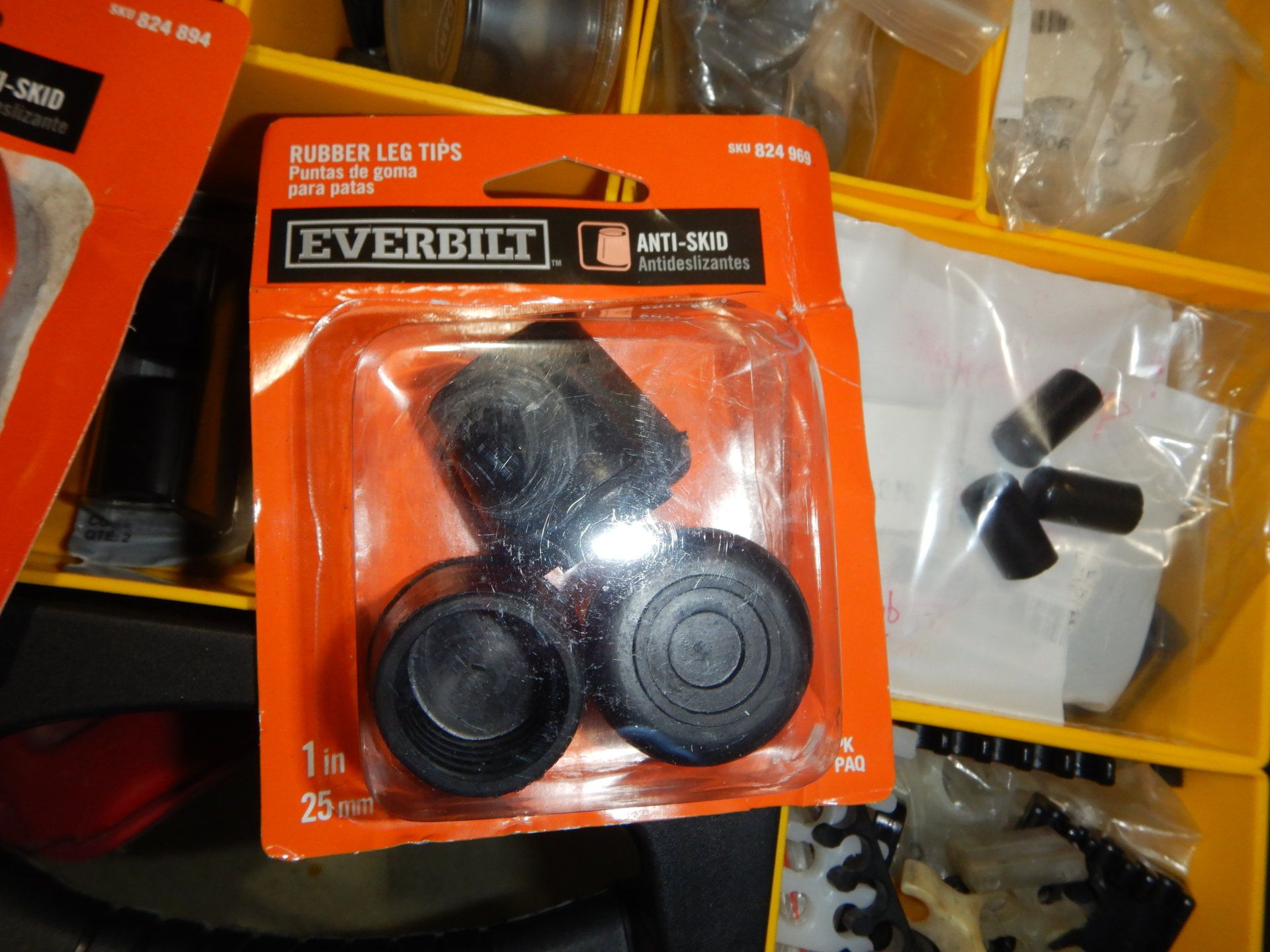

Have seen that type of fitting with chair/cane rubber tips on them. Personally, that is direct to the engine, so don't want it to fail/leak, would find a freeze plug that presses in and then tack weld it.

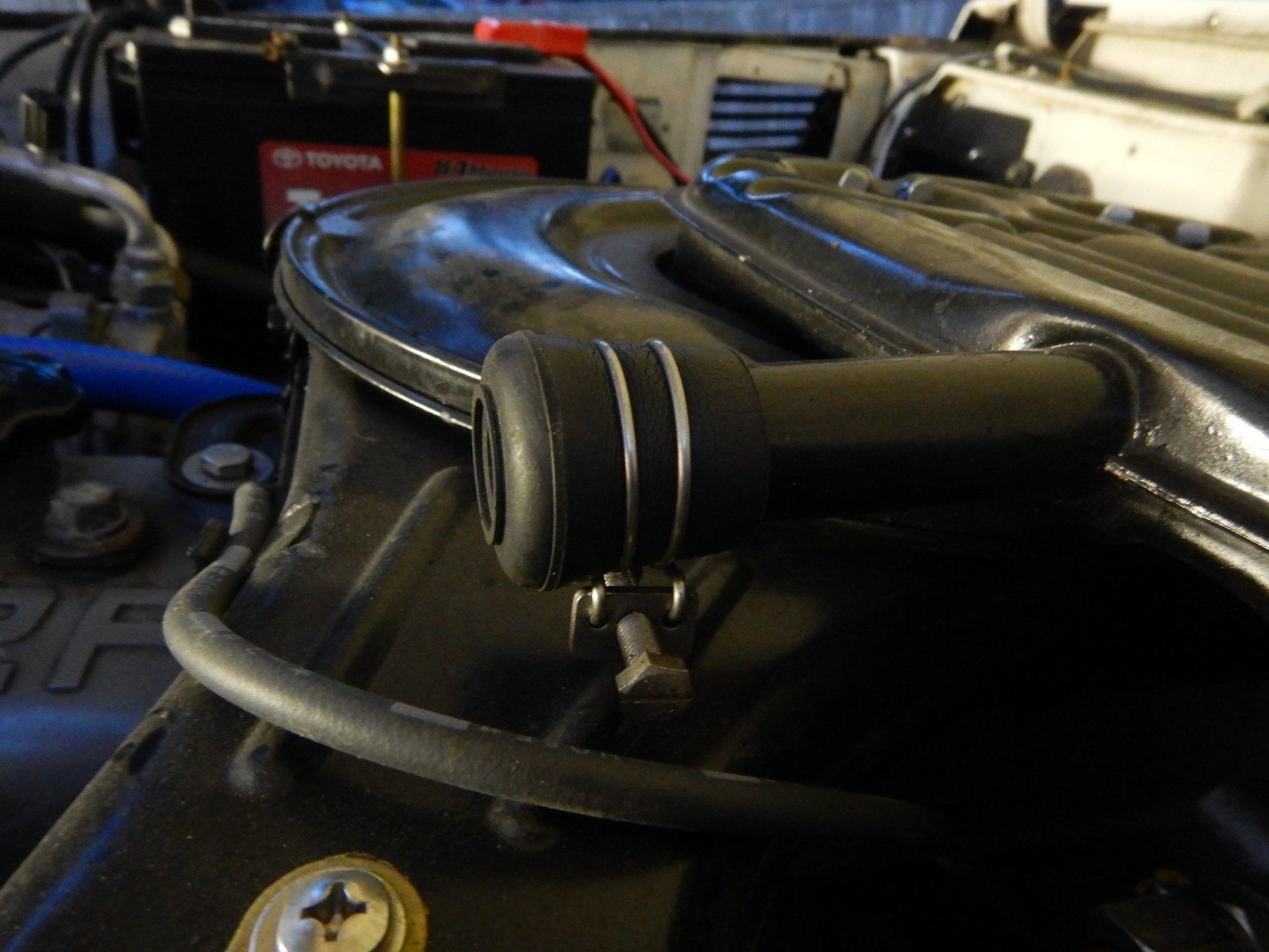

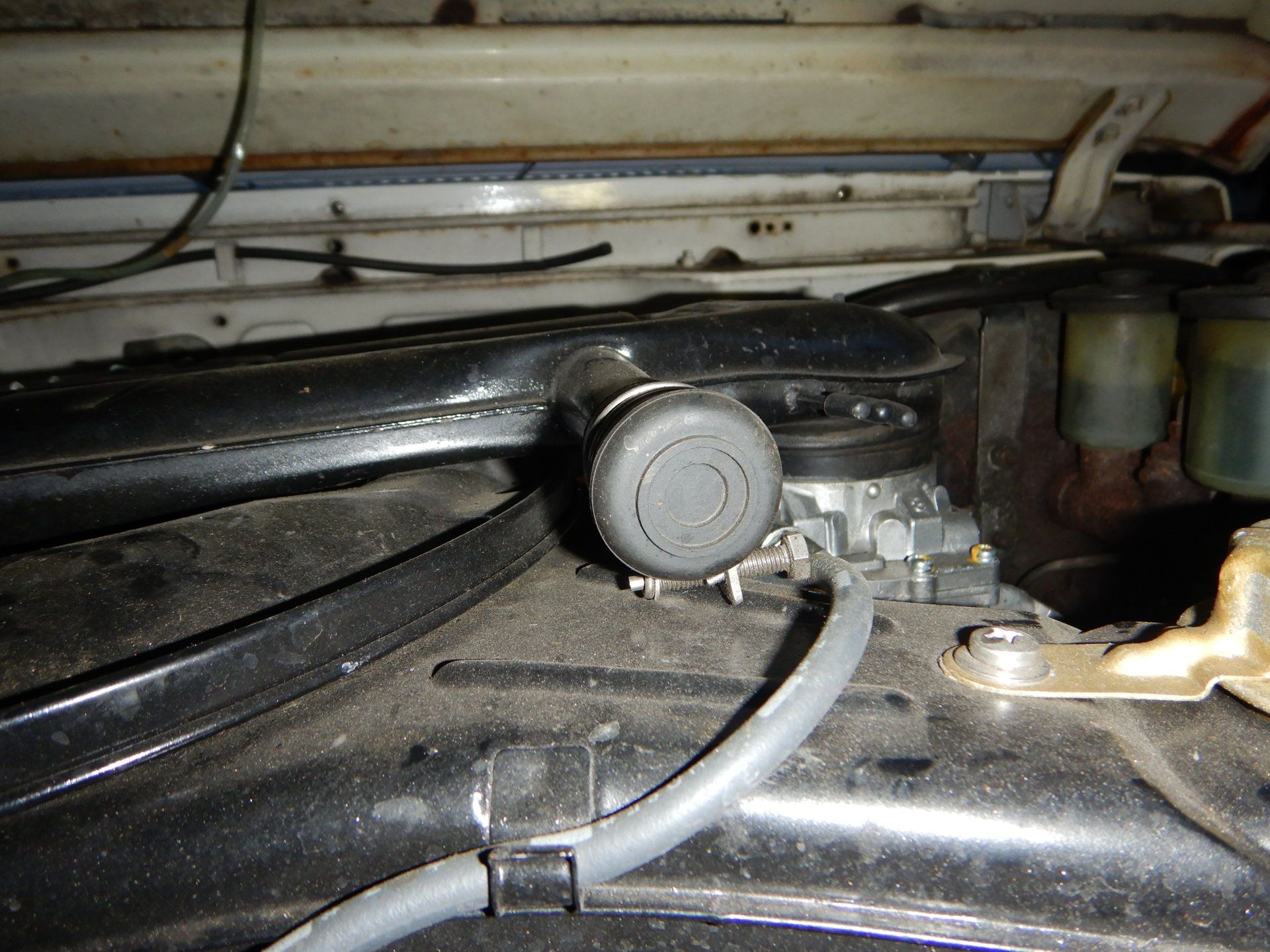

This was My solution , Much like @Tools R Us described , I did not want to rely on the Rubber compression tension of the cap
alone , so I also installed a @Racer65 Stainless Steel Hose clamp to each of my air cleaner ports , the larger one is the 1 1/8"
inch u have. I purchased these @ Home Depot in the Furniture / shelving isle

I'd be nervous with those cane tips- doubt that rubber is intended to withstand the temps it will see under the hood. You can see the cracks already. Probably wouldn't hurt anything if pieces got sucked in, but I wouldn't take the chance.
